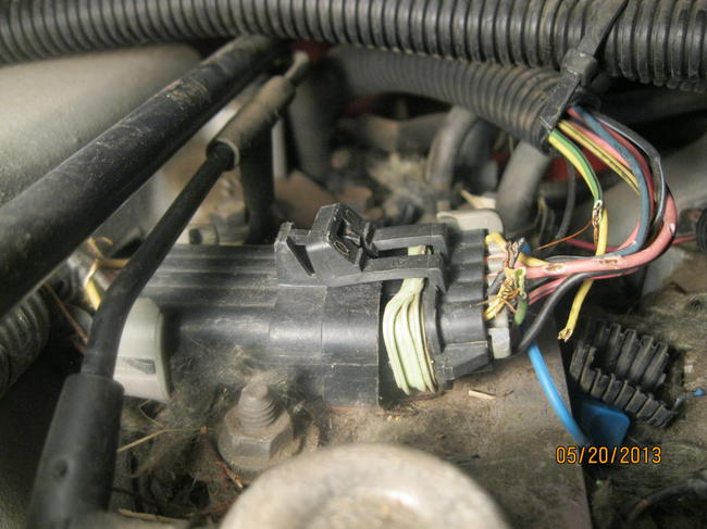

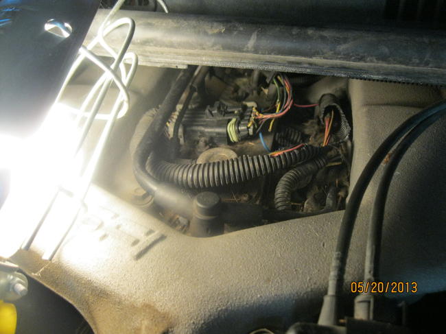

my car was parked do to a flat and mouse ate the wires going into the harness between the air intake manifold. i need to know what the harness is. and can i just splice the wires? please hurry fneed to get running asap i dont see any other wires eatn either.

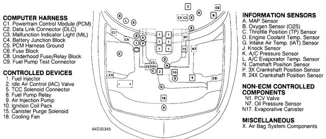

pretty sure its not. it sits directly on top of the motor and the manifold is on either side of it..

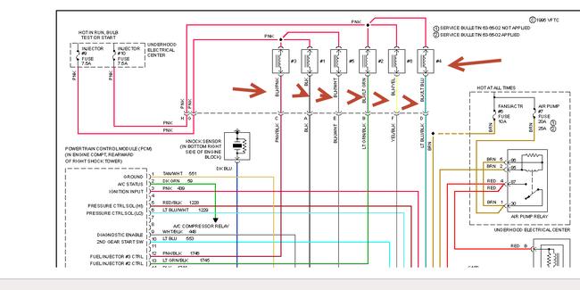

i'm sending a pic along see if you can match it up with that and what color are the wires?

ok i dont see it on there. but were the 6 1s are it would be right there.. wire colors are yellow black green with black stripe black with white stripe and red

it is right between the middle 1s on the fuel inj..

that should be the injector harness. see pic that should bea all the wires........just reconnect them

i sent two pictures of it one from above and one close....

its' the connector for the fuel injection harness if you can get the wires out of the connector without damage just put shrink tubing over thenm
