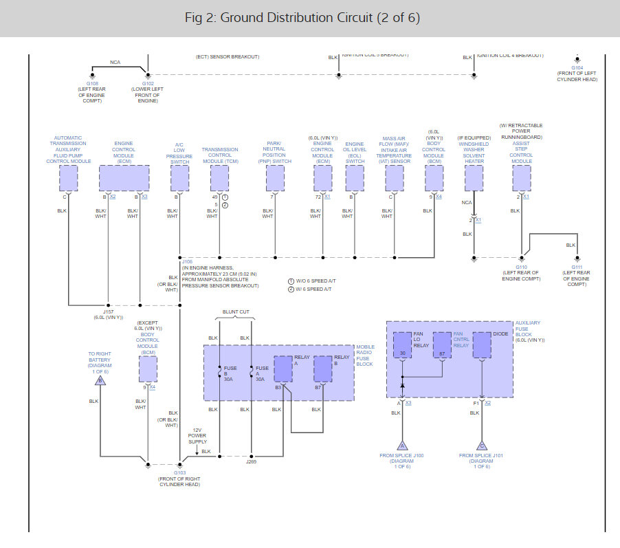

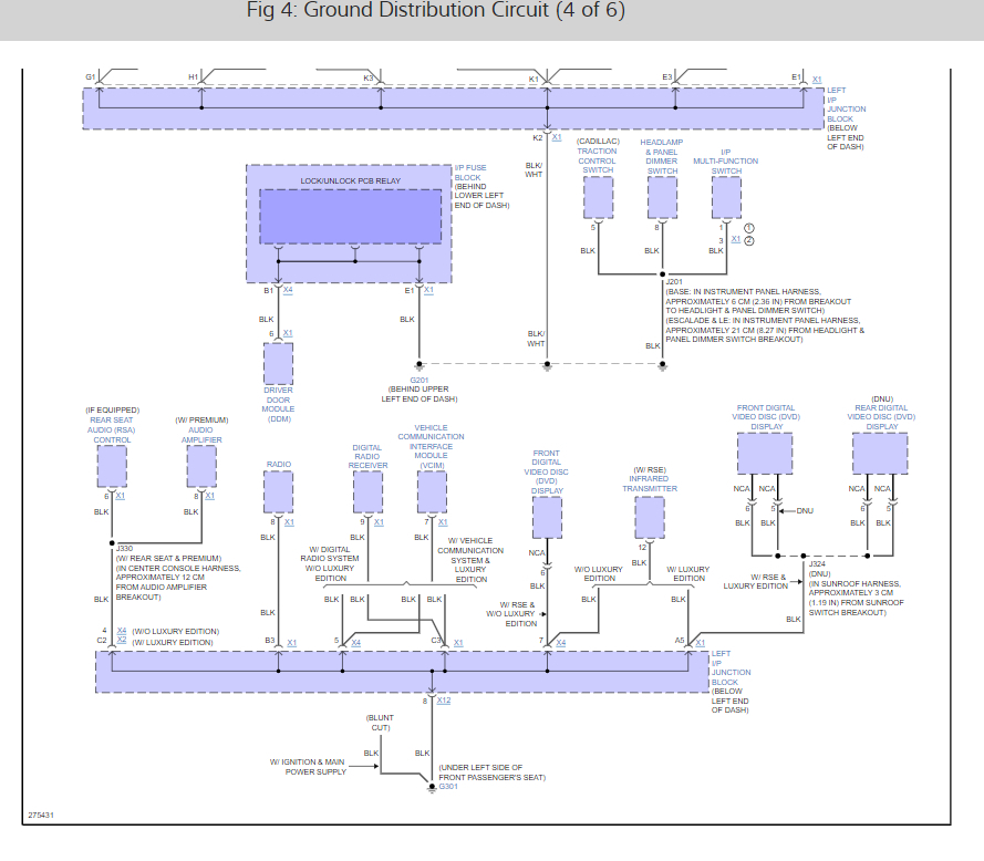

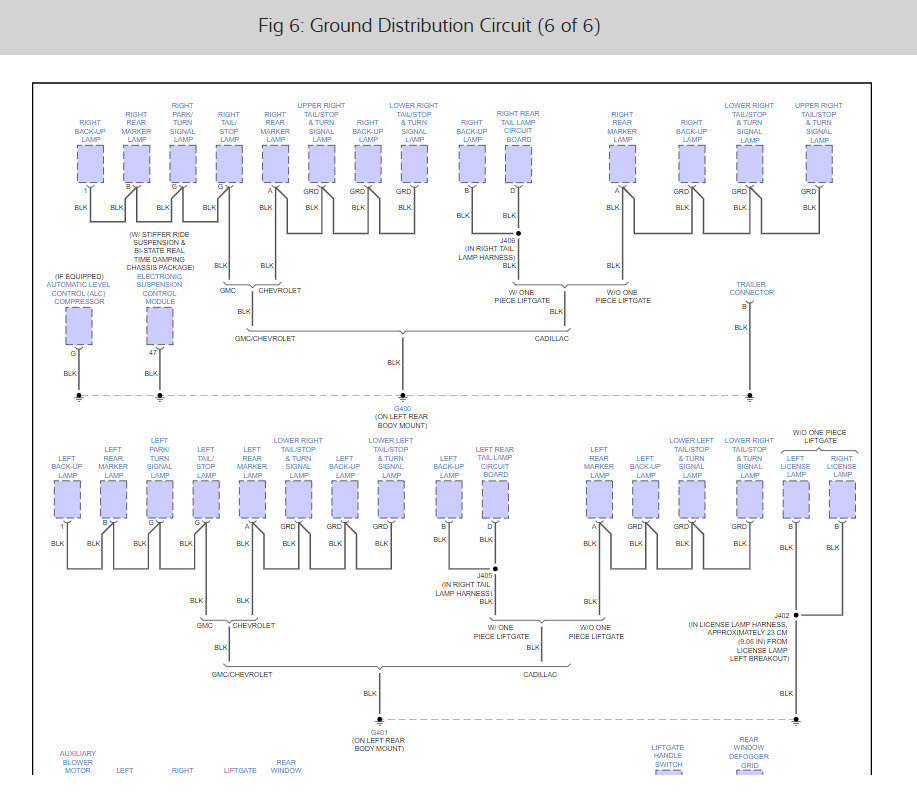

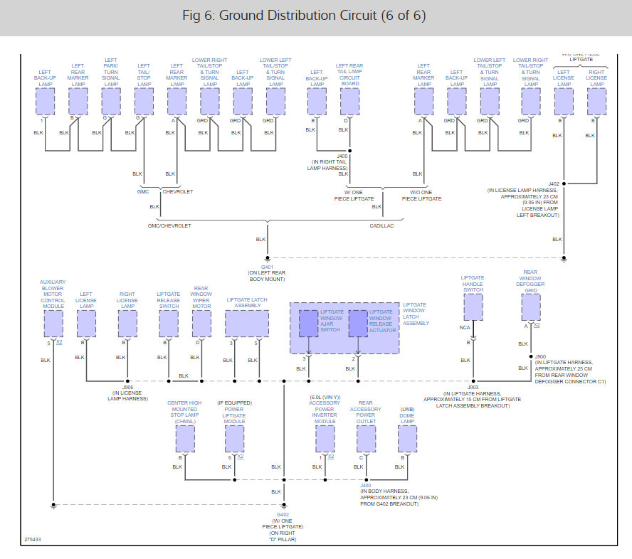

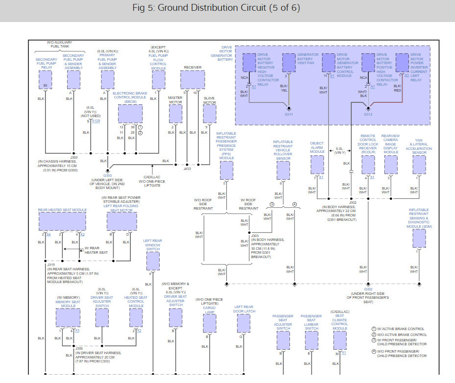

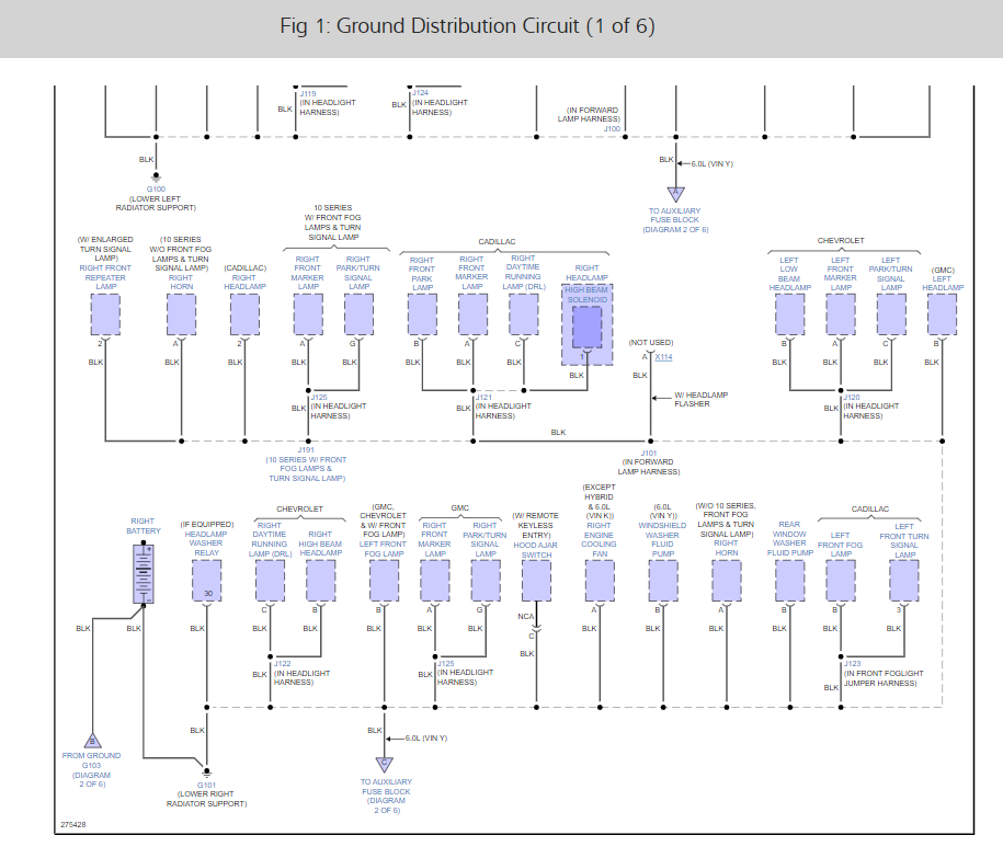

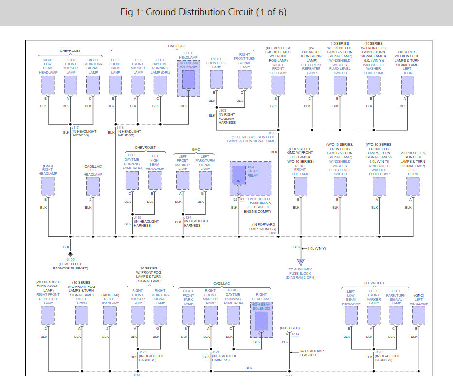

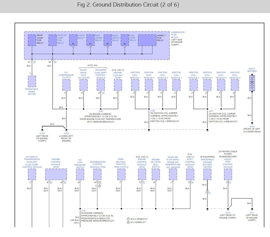

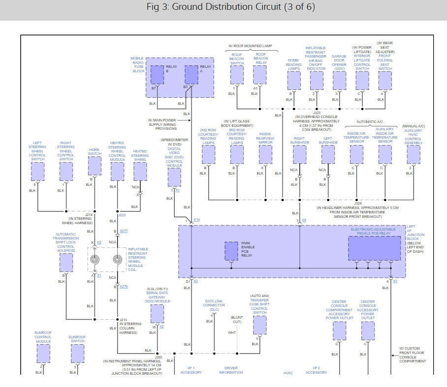

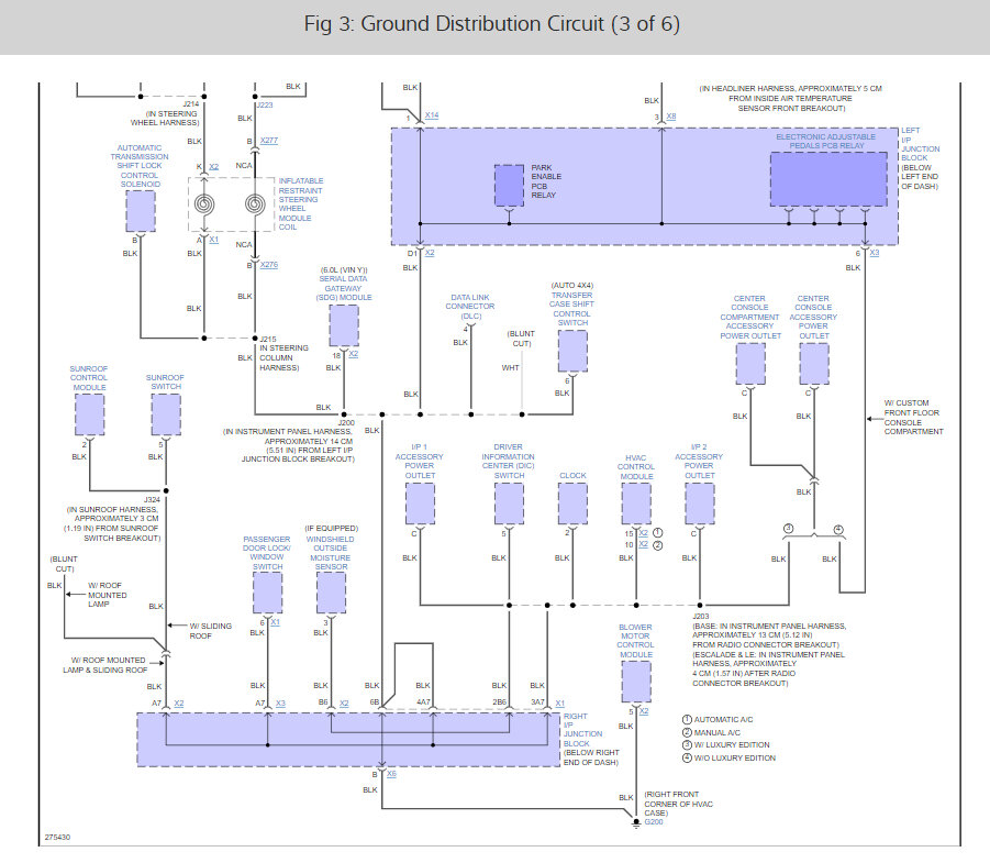

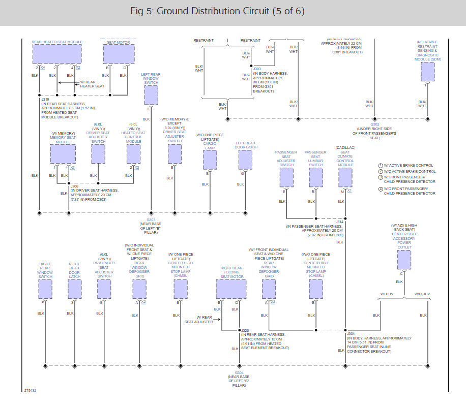

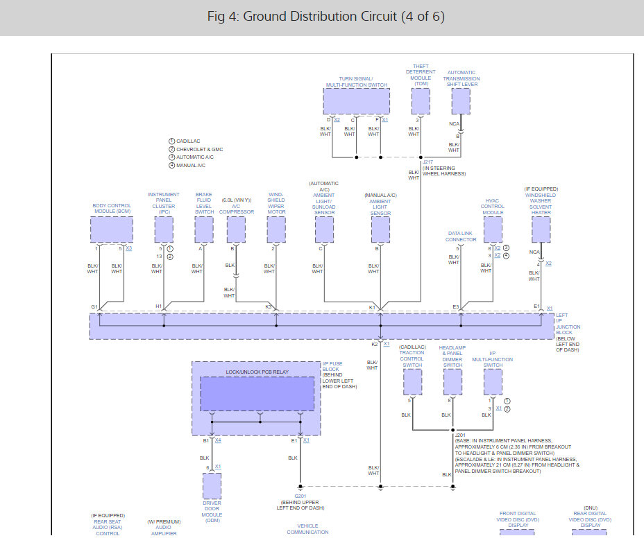

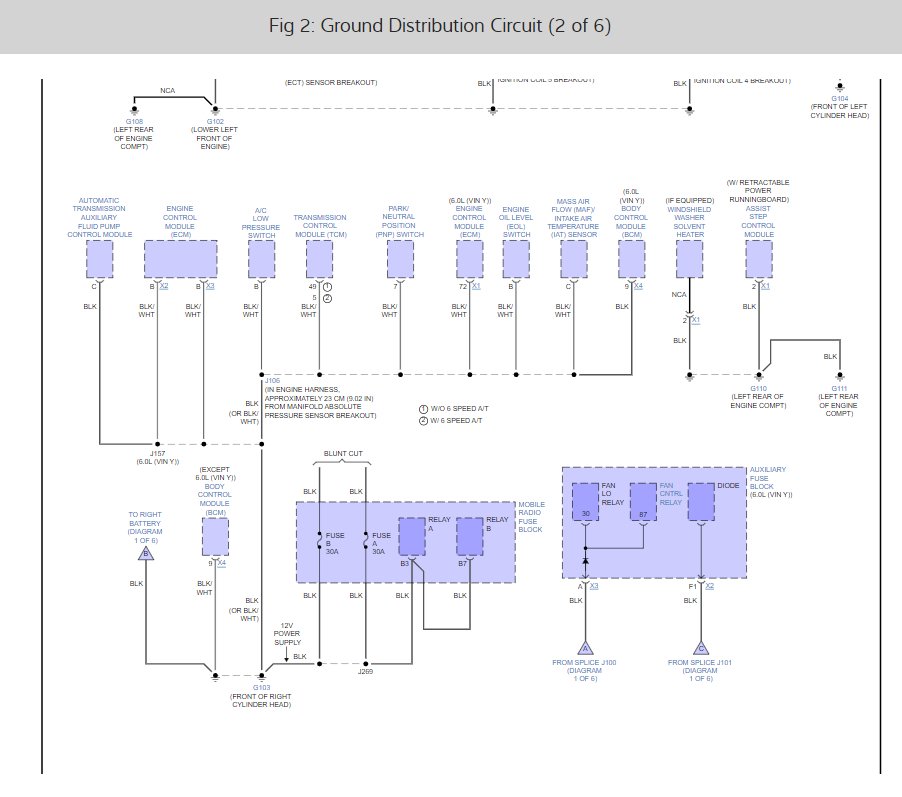

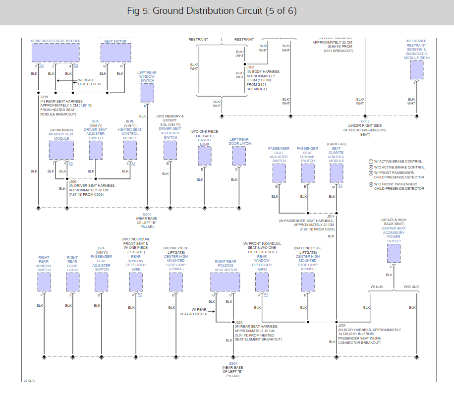

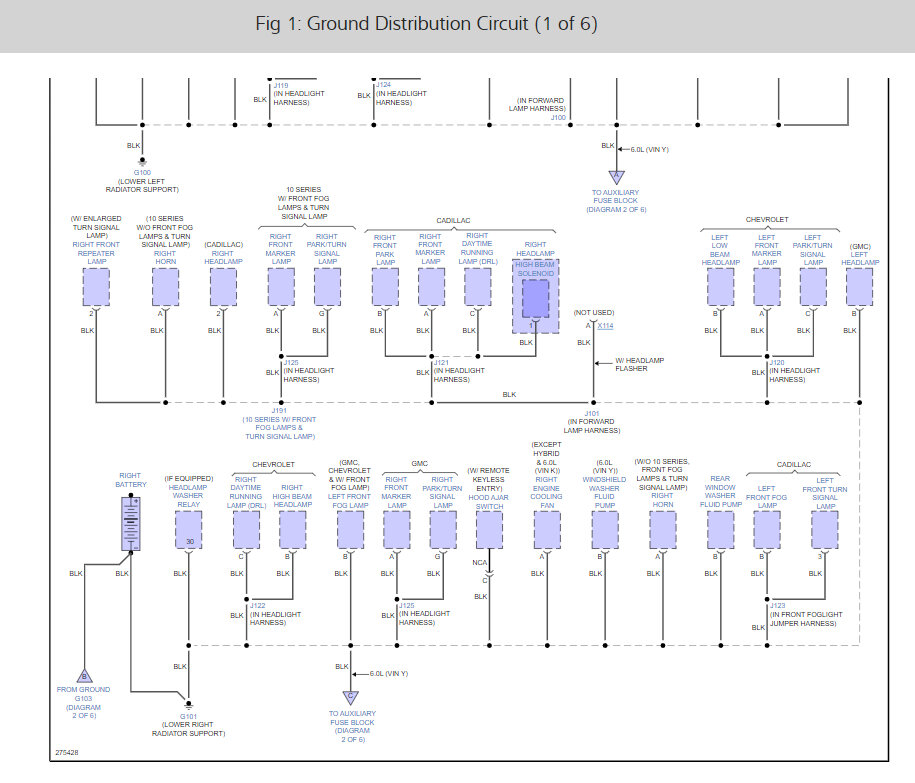

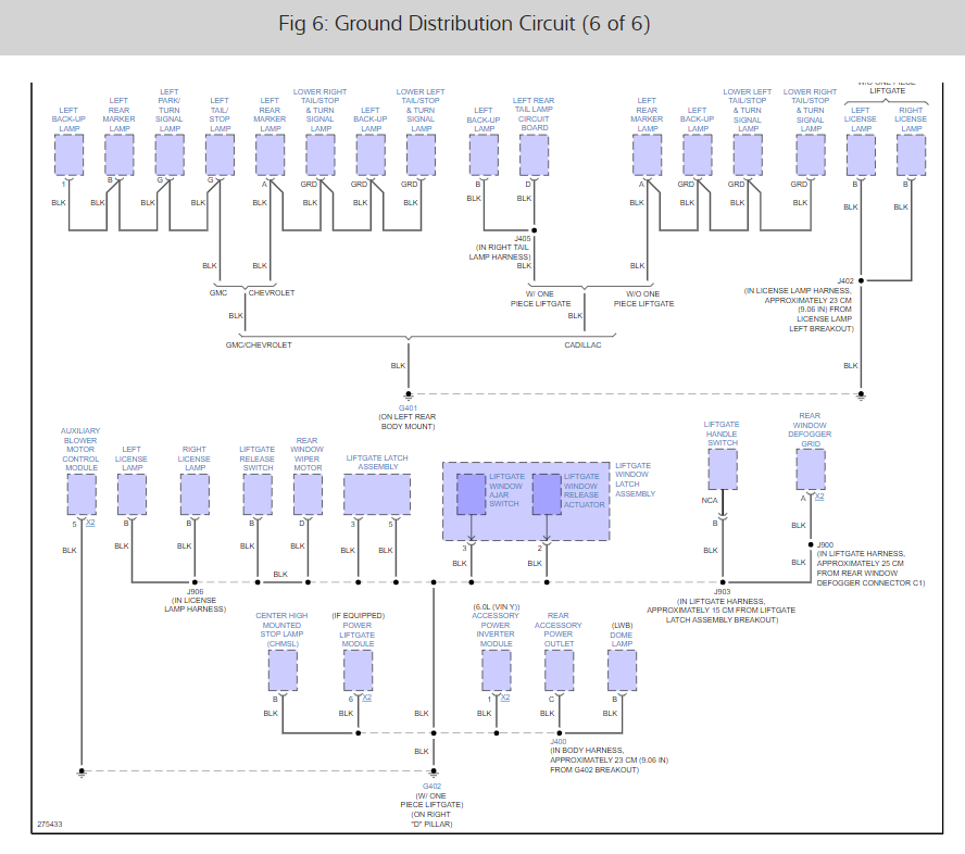

We are having an intermittent electrical issue with this vehicle and suspect it may be a grounding issue.
Could you please provide the locations (hopefully a diagram) of all electrical grounds, both engine and body, for this vehicle?
Thank you in advance for your help!
Dec 14, 2022 at 12:43 PM
  • 55,386 POSTS
Yep, here are all of the ground locations and the circuits they work for. I also included a guide on how to check the grounds in case you need it.
Check out the images (below). Please let us know if you need anything else to get the problem fixed.
