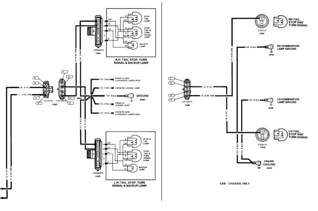

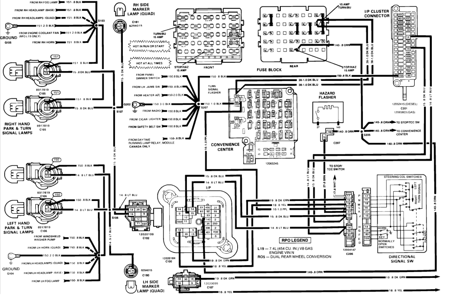

Can you tell me where the ground location is that comes directly off the turn signal flasher?

Is it a two terminal flasher? If so there is no ground it is an in circuit device.
Oct 27, 2017 at 5:22 AM
MBARNUM
It is a three terminal flasher.
Oct 27, 2017 at 5:57 AM
  • 55,224 POSTS
Hello again,
Here is a list of all of the electrical system grounds.
Ground G100: RH Front Of Engine
Ground G102: LH Front Of Engine
Ground G104: Behind LH Headlamp, On Radiator Support
Ground G105: Behind RH Headlamp, On Radiator Support
Ground G106: RH Rear Of Engine Compartment, Near Battery Junction Block
Ground G107: LH Front Of Engine
Ground G108: Front Of Engine, At Coolant Outlet
Ground G109: RH Rear Of Engine Compartment Near Battery Junction Block
Ground G110: RH Rear Of Engine Compartment Near Battery Junction Block
Ground G111: RH Rear Of Engine Compartment Near Valve Cover
Ground G200: Under LH Side Of Instrument Panel
Ground G202: Behind LH Side Of I/P, On ALDL Bracket
Ground G300: Near Fuel Tank
Ground G301: Below RH Side Of Rear Window
Ground G302: Under LH Side Of Instrument Panel
Ground G400: LH Rear Frame
Ground G401: Under Tailgate
Here is the wiring diagram for brake turn signal and running lights for your 1900 chevy truck (below)
