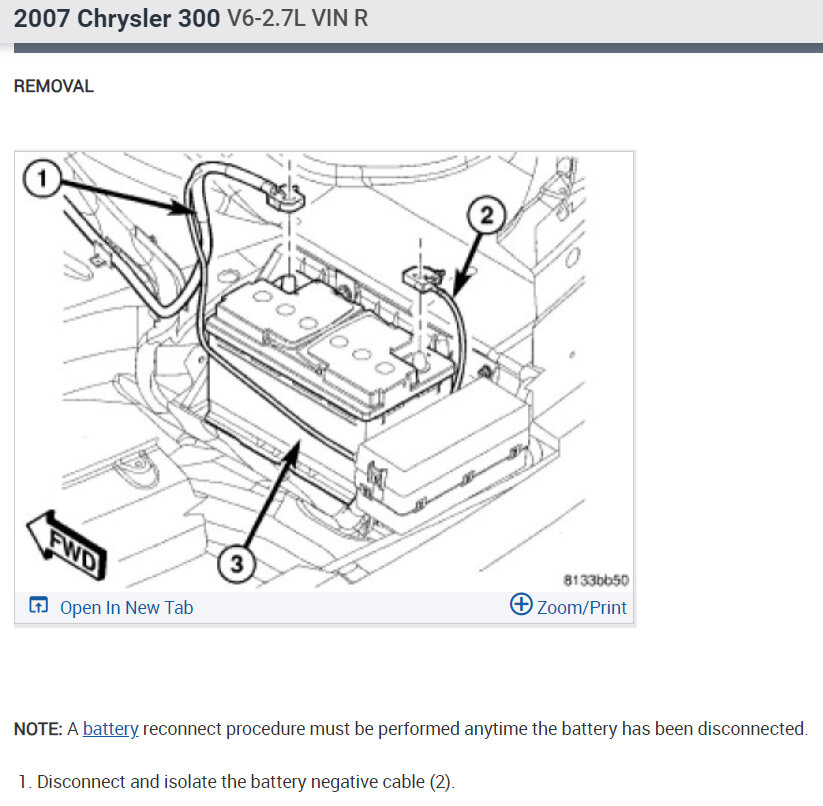

Thanks for the video. These cars had a big problem with the IPM (integrated power module) but to be sure it should have a code stored, here is a guide on how to do a CAN scan which should reveal the problem. You can get a CAN scanner (Controller Area Network) which will work on most cars from Amazon.
https://youtu.be/u-4syLc-ifQ

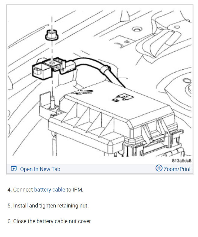

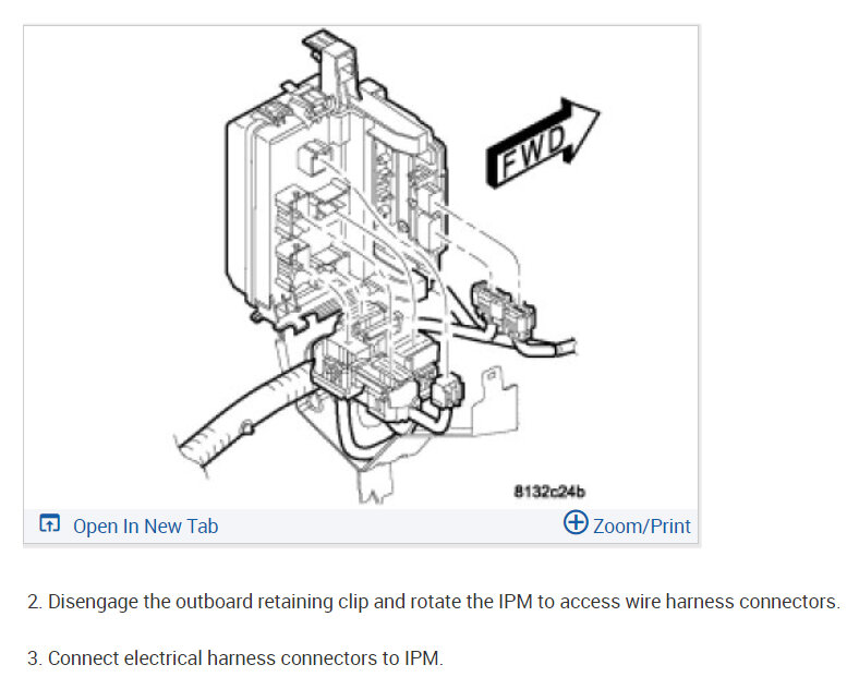

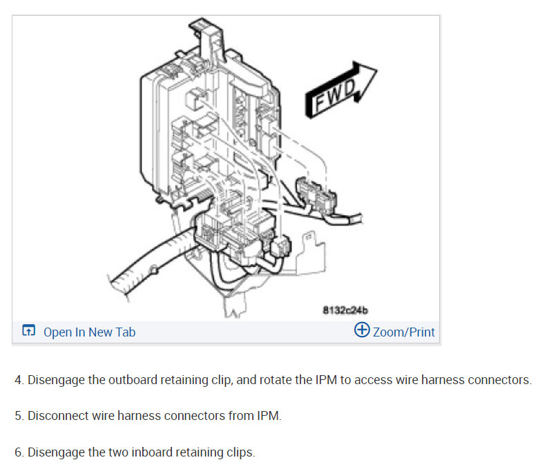

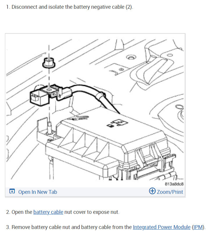

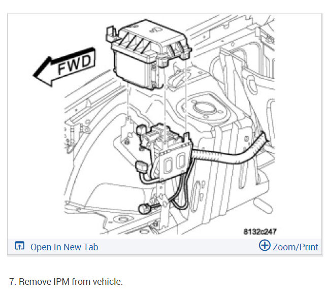

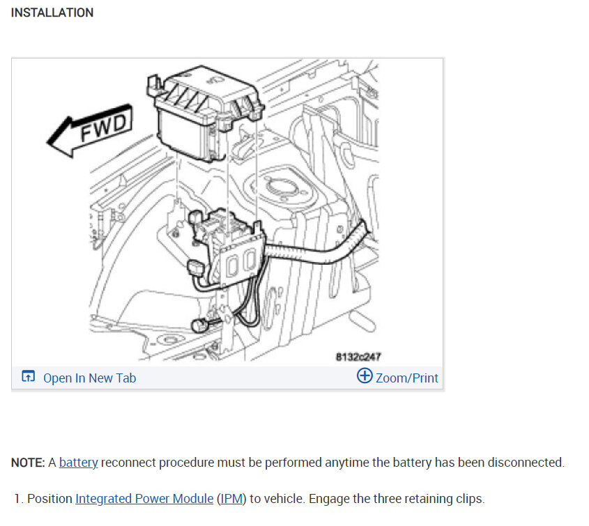

Here is how to replace the IPM which is easy because it-self learns. Check out the images (below). Let us know how it goes.
