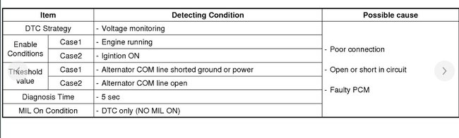

You have a charging system issue. It could be the alternator or the ECM itself which controls the alternator.
What was the code that was set?
When the code is set, it has a default mode. When you reset it, it goes back to normal until the issue happens again.

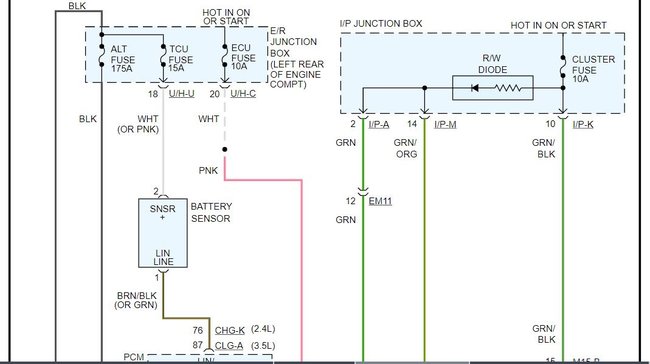

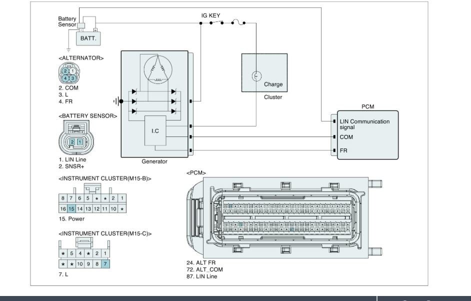

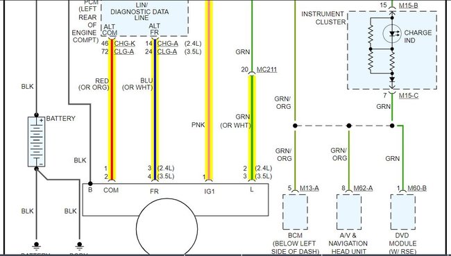

I attached a diagram for you to view. This sounds like you have a bad alternator.

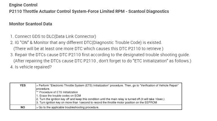

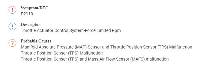

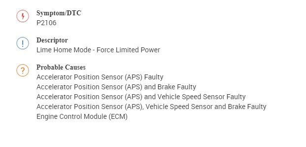

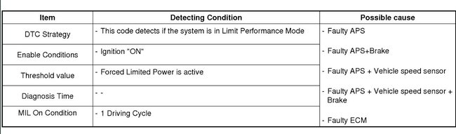

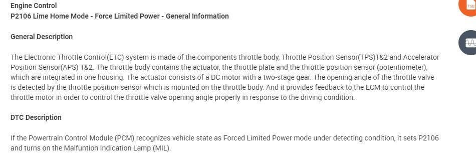

Codes.
Two separate issues. One with the voltage from the charging system and the others are the pedal sensor and throttle body.
Do you have a scan tool that can read live data such as the voltage at the pedal sensor?

I think the P2106 and P2110 codes were thrown because of the low voltage and me having the accelerator on the floor trying to get off of the road.
Mar 17, 2020 at 4:55 AM

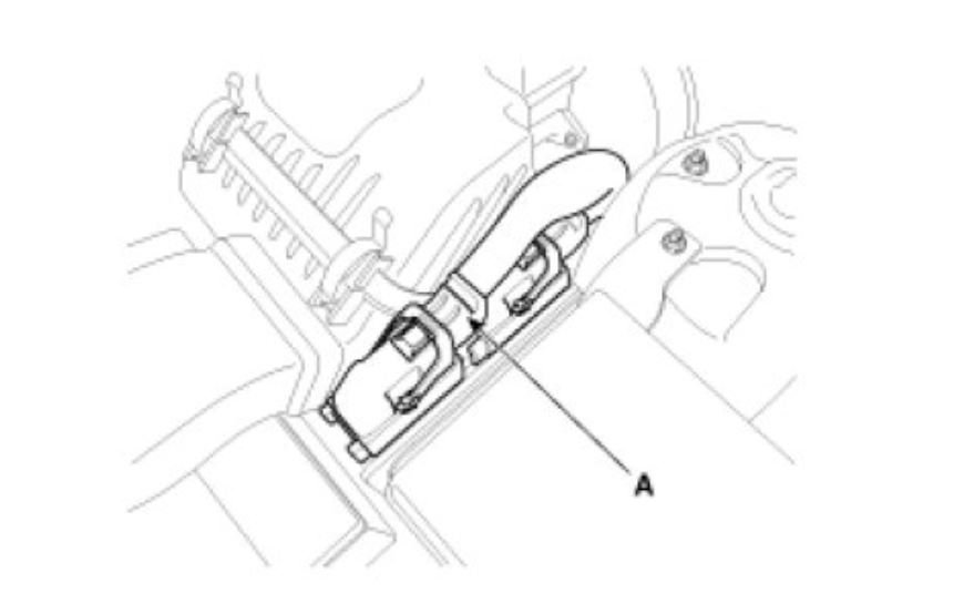

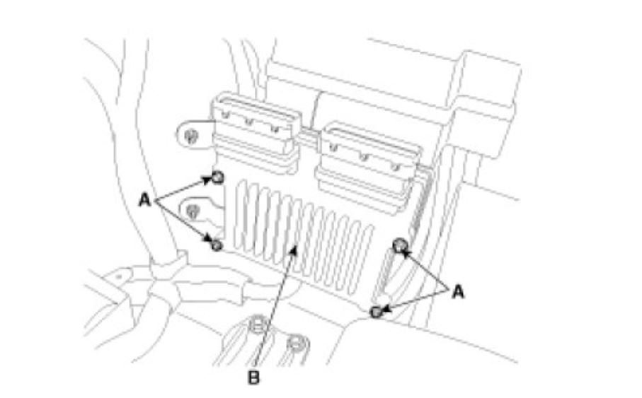

It is possible for the other codes from low voltage but if it was, there would be other codes set as well for low voltage.
Very possible you have a bad ECM as that is what controls the alternator.
