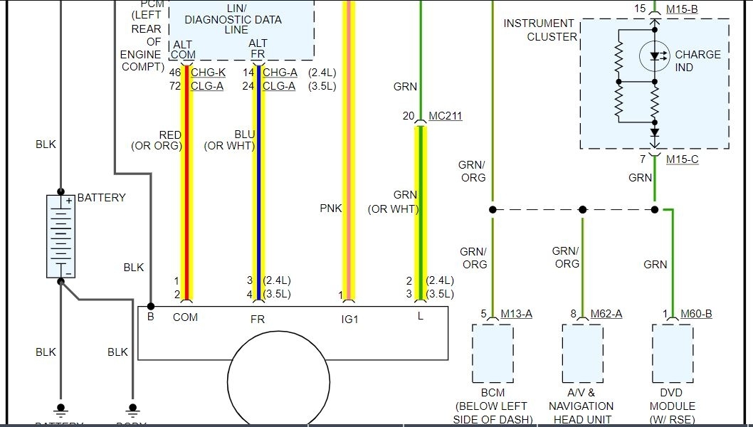

Driving along and notice battery warning light illuminated at stop light. Rev car up a little and light went off. Pulled into parking lot. Checked belt. Everything looked good. Decided to try and get home. Drove approx. 4 miles. Battery light off at first when rpm's above 1,200. At 45 mph the battery light and almost all other warning indicator lights came. Not the check engine light. Gauges quit working, dash lights started flashing. Car went into limp mode. Drove for about 1/2 mile to find place to get off of road. Check engine light finally came on. Turned car off. Checked under hood again. Everything looked good. No odors or anything. Went to restart and it just clicked. Had it towed home. Got up the next morning and put the battery charger on it. Went to work. When I got home 6 hours later battery was charged up. Disconnected charger and started car. Warning indicator lights still on and gauges not working. Put volt meter on battery while running 12.3v. Turned vehicle off. Put code reader on vehicle. The only code was a low voltage code. Battery is new and battery connections looked clean. Alternator new also. Decided to clean terminals anyway. When done started car and all is well. All gauges working and all warning lights off. Charging at 14.4v.
Drove car for a little over a week and all warning lights came on again. This was at start up at a restaurant after being off for approximately 30 minutes. Disconnected negative cable for 5 minutes reconnected all is well and car runs and operates perfectly. What could this possibly be? Something is resetting when battery is disconnected.
Mar 17, 2020 at 3:50 AM

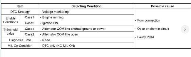

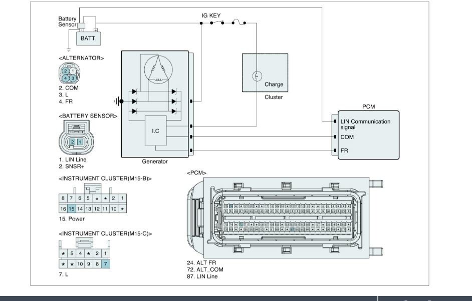

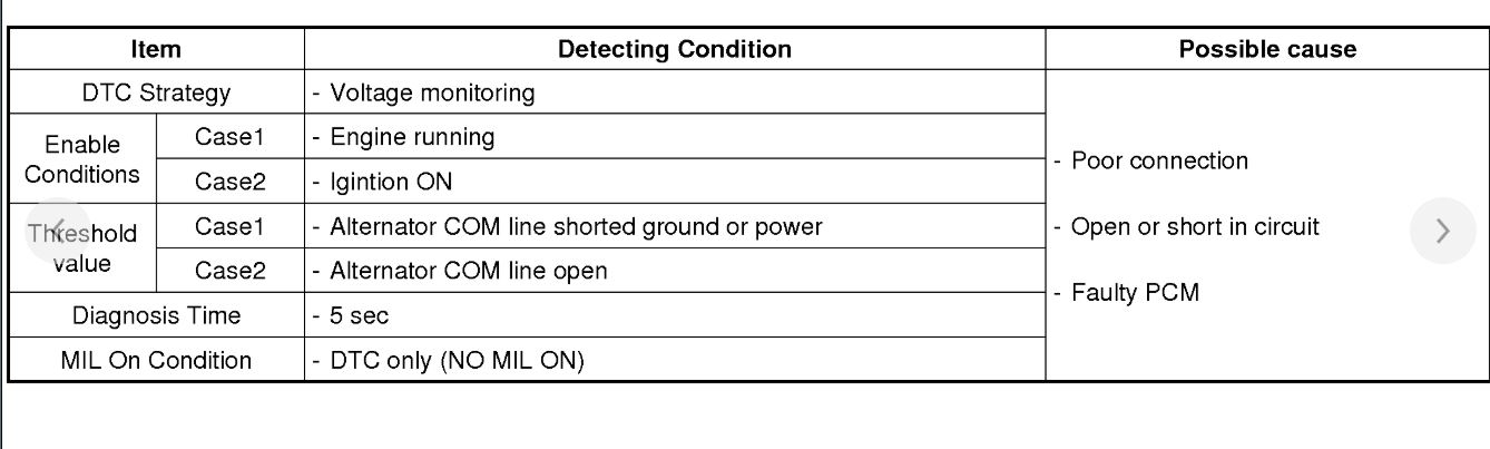

Good afternoon,

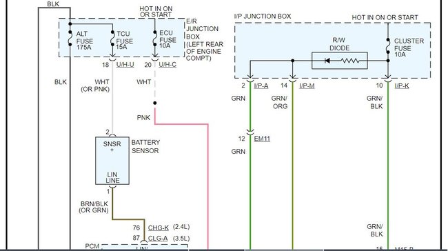

You have a charging system issue. It could be the alternator or the ECM itself which controls the alternator.
What was the code that was set?
When the code is set, it has a default mode. When you reset it, it goes back to normal until the issue happens again.
I attached a diagram for you to view. This sounds like you have a bad alternator.

It is a new alternator. Why would disconnecting the battery make the alternator start charging again? In my experience, 42 years, either an alternator works or it does not. Wouldn't the ECM cause the check engine light to illuminate? I am at work. I can send you the code when I get home.

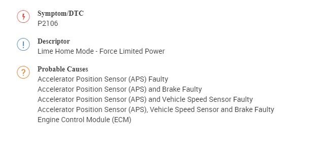

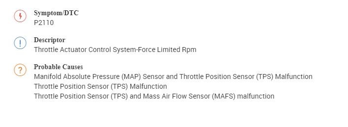

Here are the codes:
P0562
P2106
P2110
Mar 17, 2020 at 4:23 AM
Things are a lot different today than years ago.
How old is the alternator?
An alternator can work and not work based on the load and the ECM turning it on and off.
It does not charge 100% of the time anymore. It just charges when needed.
Mar 17, 2020 at 4:29 AM

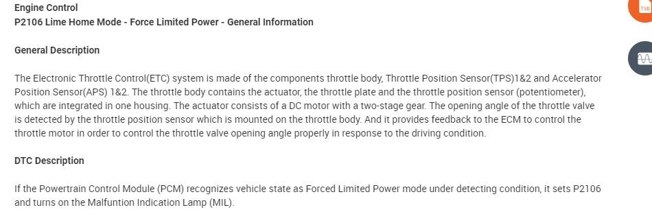

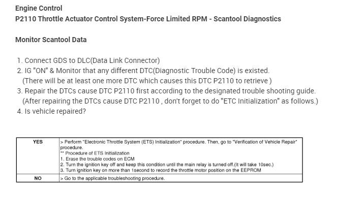

Codes.
Two separate issues. One with the voltage from the charging system and the others are the pedal sensor and throttle body.
Do you have a scan tool that can read live data such as the voltage at the pedal sensor?

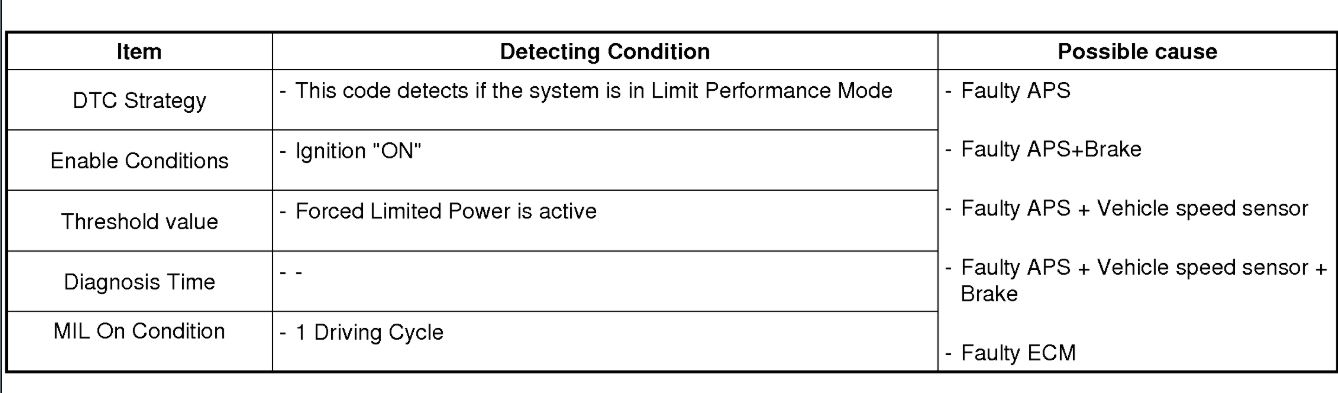

I think the P2106 and P2110 codes were thrown because of the low voltage and me having the accelerator on the floor trying to get off of the road.
Mar 17, 2020 at 4:55 AM

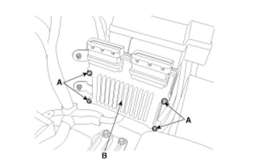

It is possible for the other codes from low voltage but if it was, there would be other codes set as well for low voltage.
Very possible you have a bad ECM as that is what controls the alternator.

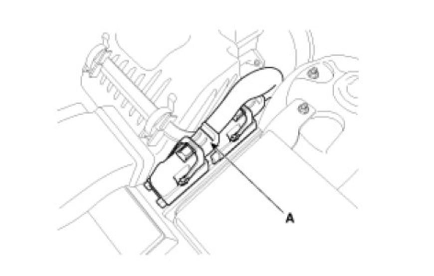

It is quite possible i guess. I will throw my code reader in the vehicle and next time it does it I will see if it throws a code before I reset it. Could the BCM have anything to do with this?
Mar 17, 2020 at 5:33 AM
Yes, it does monitor the system but does not control the system.
