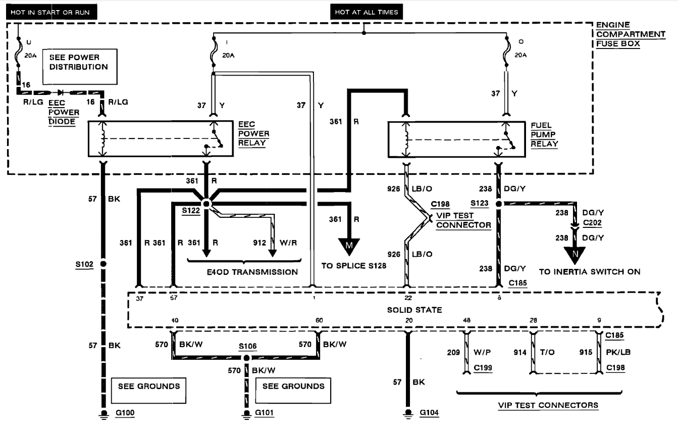

Vehicle was sitting for 5 years, replaced both front and rear fuel pumps, not getting ground at relay from ECM, during crank. Vehicle will start with starting fluid, but won't start with fuel pump manually turned on, where can I look to find what's causing ECM to not provide ground?

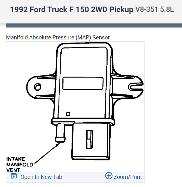

This can be because of bad ignition module even though is has spark or I have seen a bad MAP sensor not tell the computer the engine has vacuum which will not turn the fuel pumps on. Have you run the codes to see if any are stored?
https://www.2carpros.com/articles/ford-lincoln-mercury-obd1-1995-and-earlier-diagnostic-trouble-code-definition-and-retrieval
Here is the locations of the map sensor which I would try swapping out. Check out the images (below). Please let us know what happens.

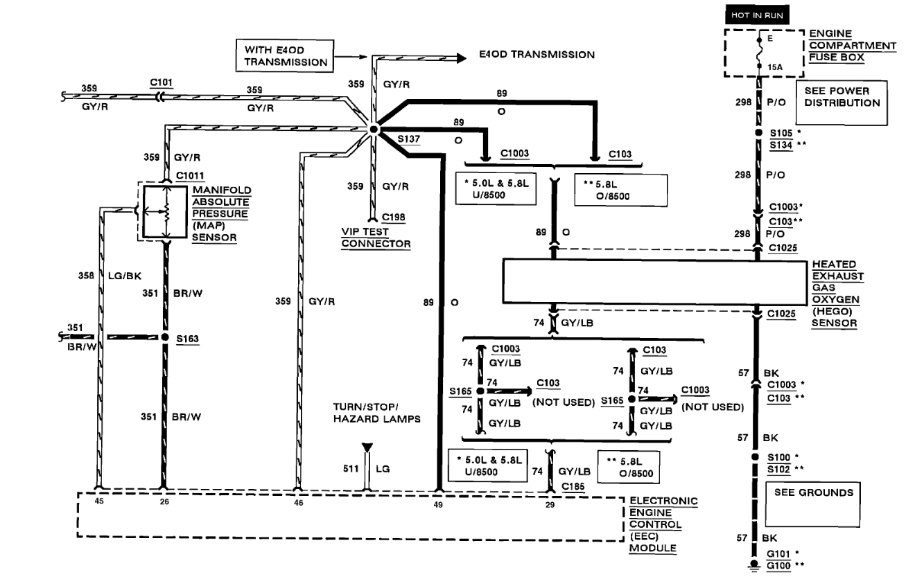

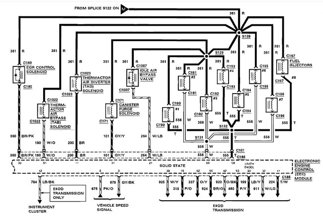

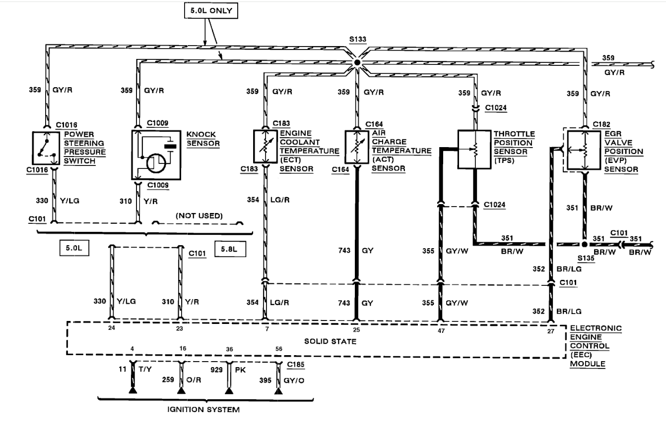

That is a good sign, did you check the inertia switch? Did you check fuse O in the under-hood fuse panel? Here are the wiring diagrams so you can see how the fuel system works. Check out the images (below). Please let us know what happens.

Yes, inertia switch, tank selection switch, relay and fuse are all working correctly, my fuel pressure Guage isn't working properly though so I can't tell exactly how much pressure there is when the pump is forced on, it shows 0 but the test port sprays out at a decent rate when valve core is depressed.

Did you swap out or check the vacuum line to the MAP sensor?
Mar 3, 2025 at 2:26 AM
VIPERKING75
  • 58 POSTS
Vacuum line is fine, replaced MAP, still won't start.

hmm, so no codes, the engine has spark, and fuel pressure and all the fuses are good. let check the power and ground for the PCM and if okay I would replace the ignition module and then the PCM with a rebuilt unit. Please use this guide below to help check the power and ground. Please use the wiring diagrams above.

No damage to any of the wires, however I did find that almost all of the injectors were completely clogged, flushed out the fuel rails and ordered new ones. will update if it works.
