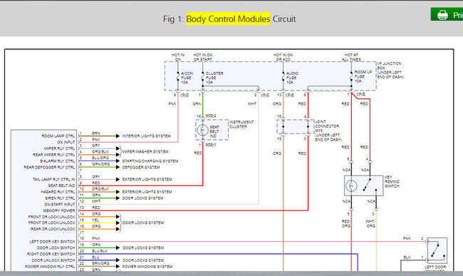

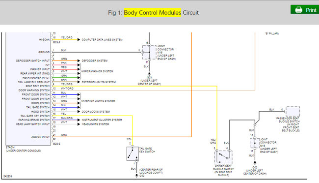

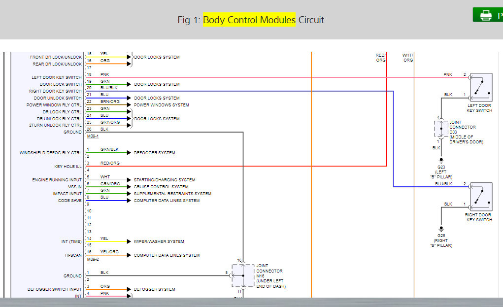

This sounds like your Body Control Module (BCM) might have taken a hit when this event happened. When a component like this is starting to fail it usually works just fine when it is cold, but when it warms up is when it will start to fail. This is because the internal circuitry on the circuit board will slightly expand as it heats up from the electrical current and where it was slightly damaged will now short across and effect different system that the module controls.
The BCM is located under the center console. I have included a wiring diagram for the BCM Circuit in the diagrams down below. Please check out this module and get back to us with what you find out.

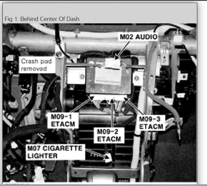

Hey, got into the center console but the only two modules I'm currently seeing in the airbag one on the floor in front of the gear stick , and one under the radio with a etacs label. The part number is 95410-1F300 showing up as the ABS system though. Not sure if I needed to remove more of the dashboard to get to it. Thanks.
Apr 7, 2019 at 5:06 AM
SCGRANTURISMO
  • 4,897 POSTS
I have included a picture of the location in the diagrams down below.
