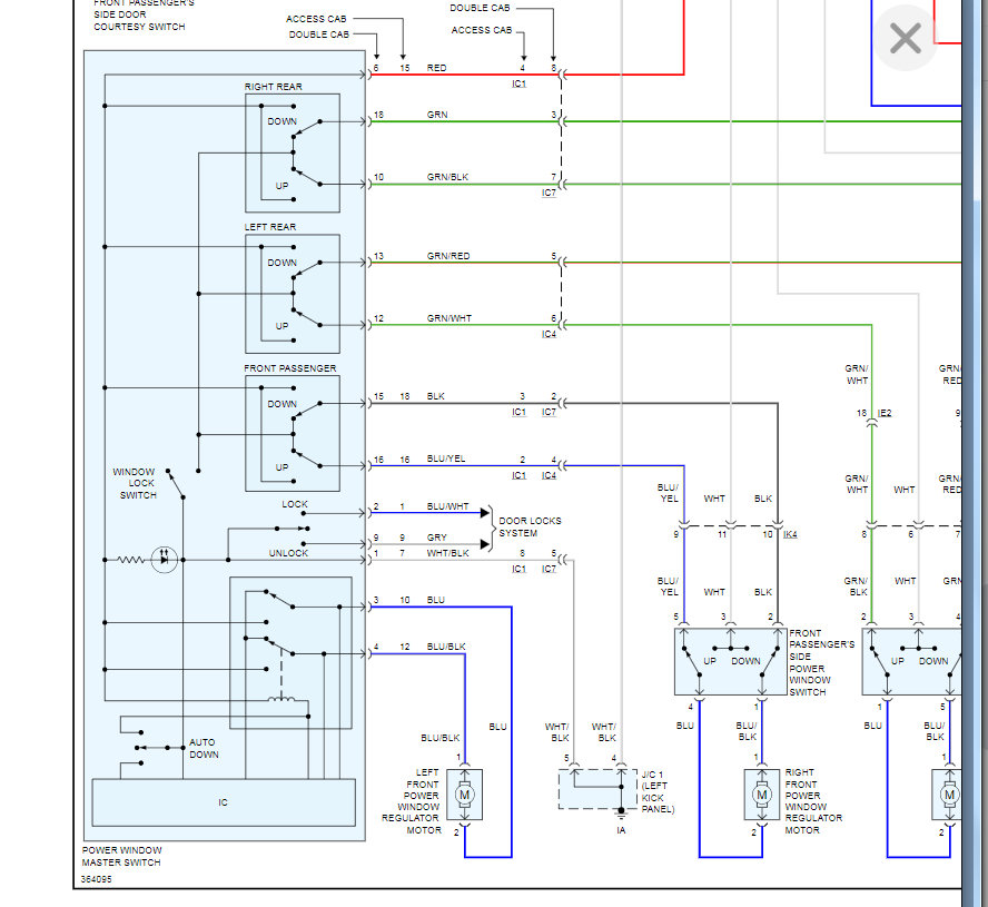

Check Engine light is on.
No power to windows, fan(heater/air) or speedometer.
Everything else runs fine.
Checked all the fuses.
Now what to check?

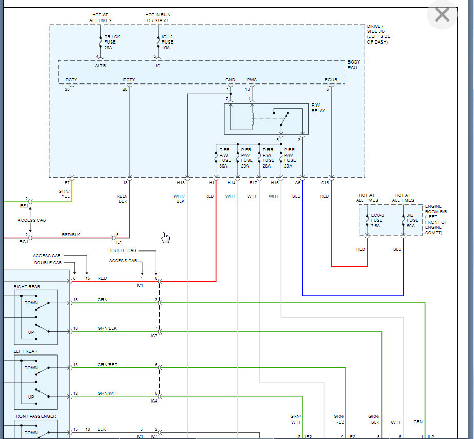

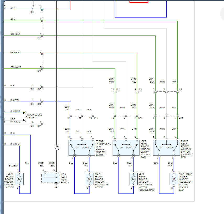

So let's look at the window issue. This power comes from the body computer which is on the left side of the dash. If you don't have power to any window then we need to check the relay (assuming the fuses are good as you stated). However, if there are specific windows that don't work then there are fuses down from the relay. Just let me know where you have power on the windows and we can go from there.
