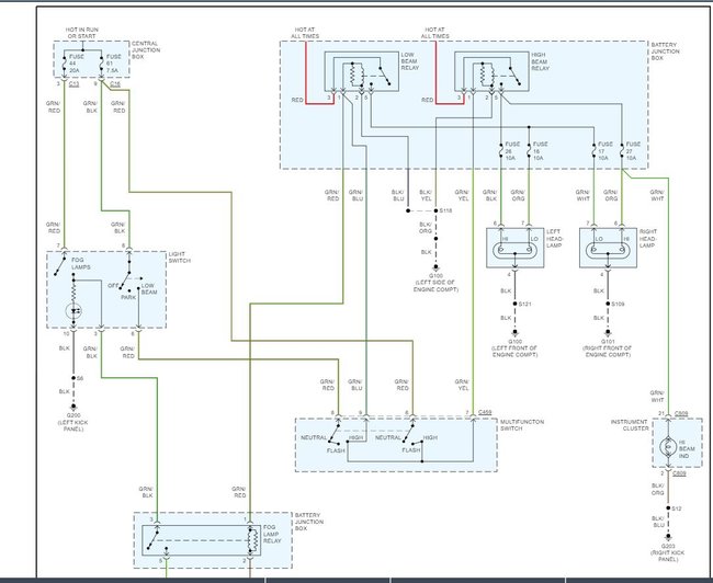

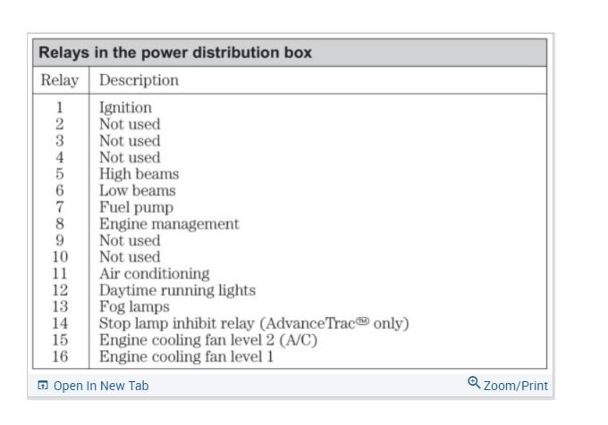

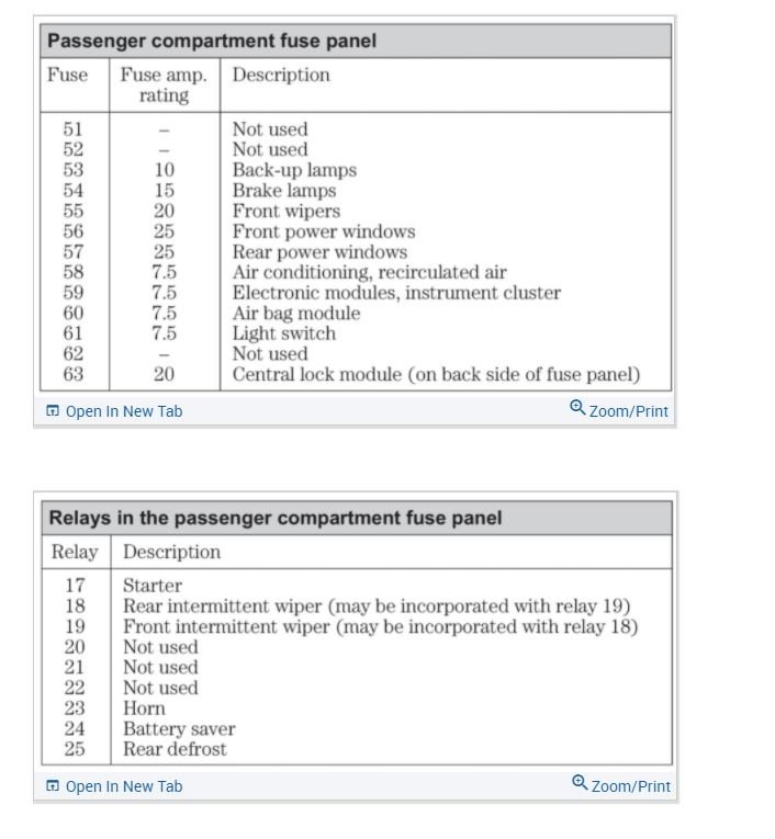

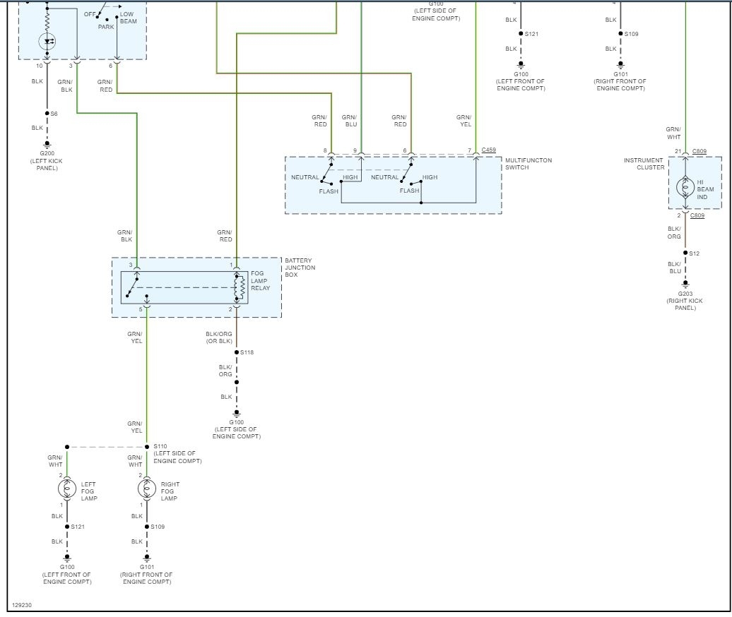

need the headlight and both fuse panel diagrams please.

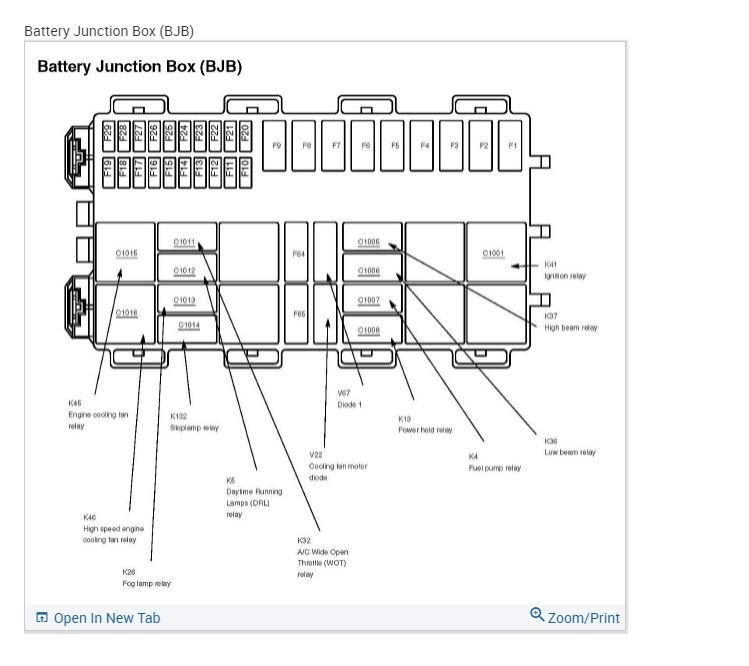

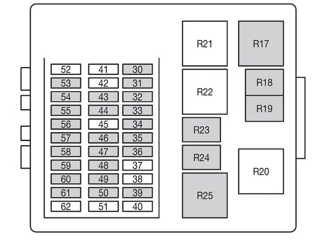

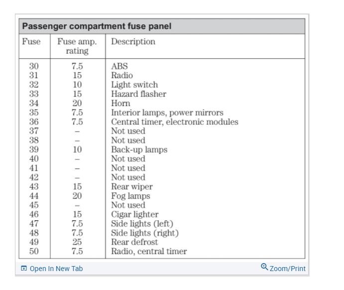

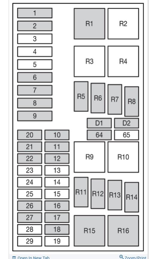

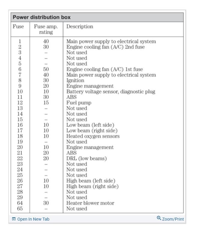

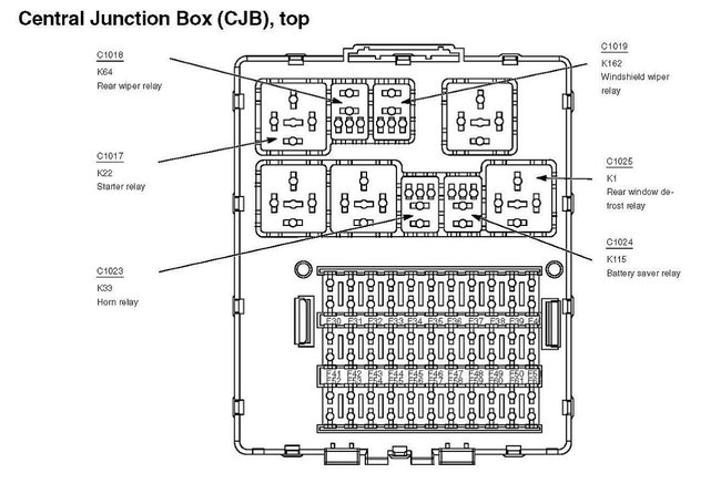

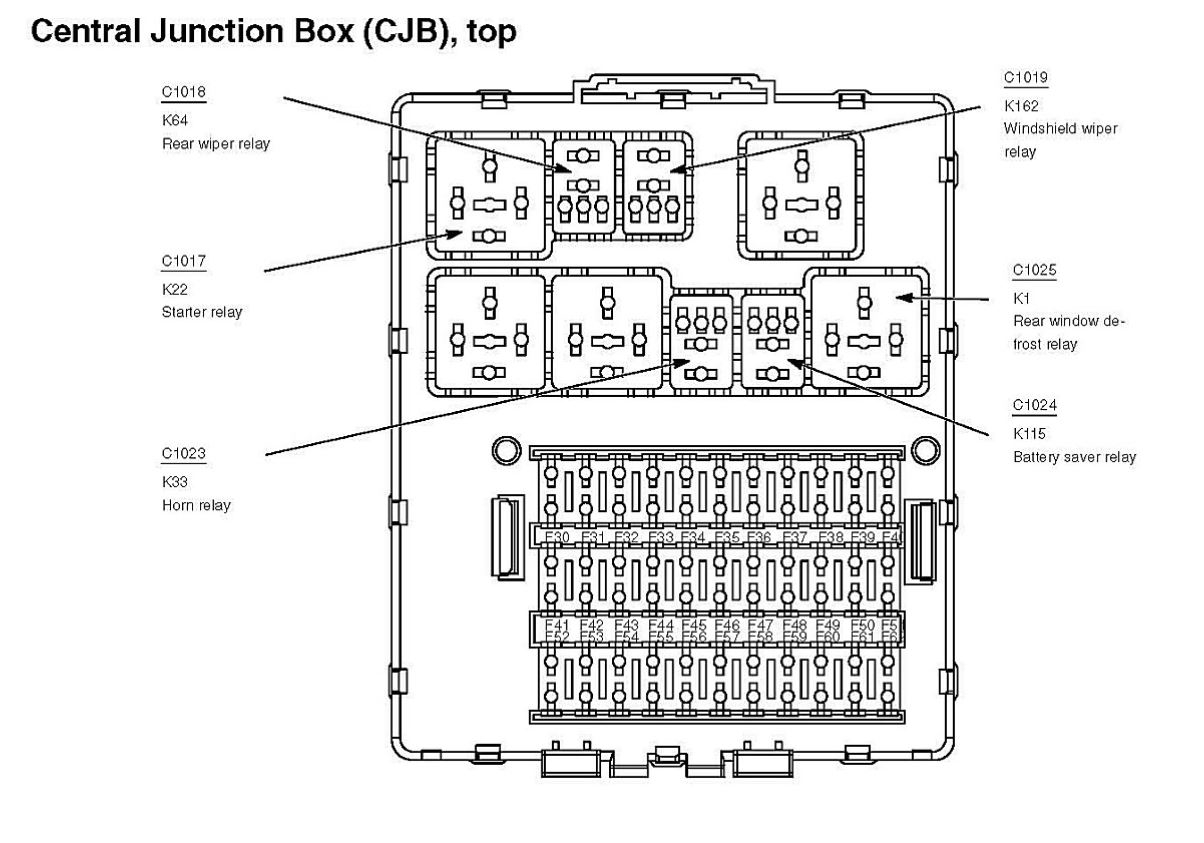

I attached the wiring diagram of the headlights for you as well as both fuse and relay panels as well.

The under-hood high current fuse box lid has a relay for right side low beam, a relay for right side high beam, a relay for left side low beam, and a relay for left side high beam and the spots to put them in. So, my question is, are there two relays, one for low beam and one for high beam or are there four? The relays in the car are 5 pin relays.

Hello again. Thank you for the diagrams. Please disregard my last question. The cover on the High Current Fuse box was not the original one that came with the vehicle. The problem turned out to be the green and black striped wire from the underdash fuse panel to the headlight switch. It was using 7.6V when I did a voltage drop test on it. Simply ran a bypass wire and bingo, headlamps again. Thank you for the help.
