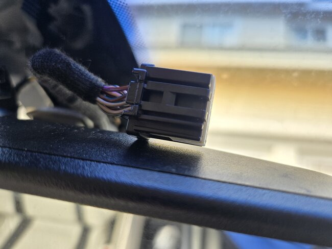

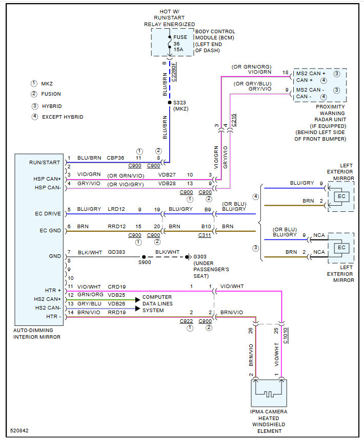

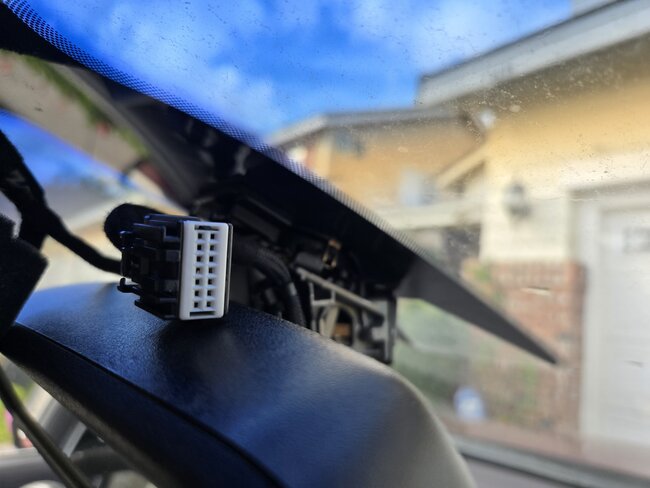

I'm looking for an electrical diagram of the rear-view mirror. I'm planning on wiretapping it to power a dash cam camera. The car listed above is a black label.

I forgot to upload, here are some pictures.

It looks like the blu/brn wire is 12 volts, here is the rear-view mirror wiring diagrams with the rain sensor system which looks like you have. Check out the images (below). Let us know if you need anything else.
