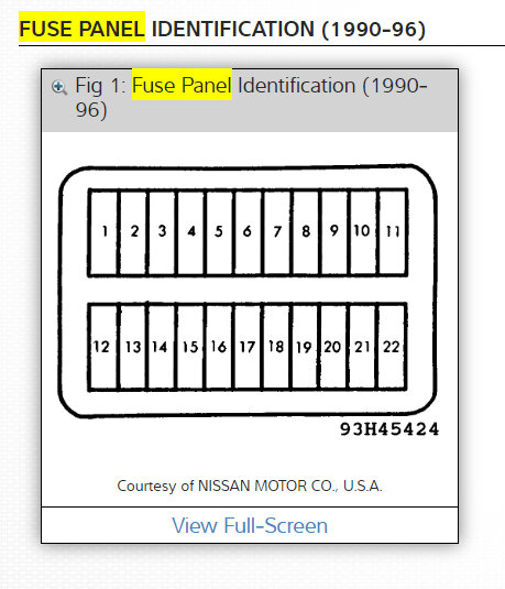

I was recently driving at night and all of my dashboard lights came off I had no turn signals no brake lights speedometer was not working??
Jan 10, 2023 at 12:25 AM
  • 55,214 POSTS

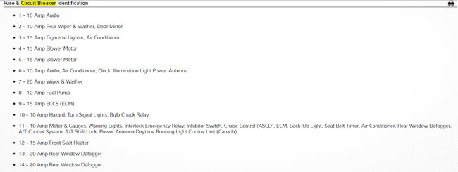

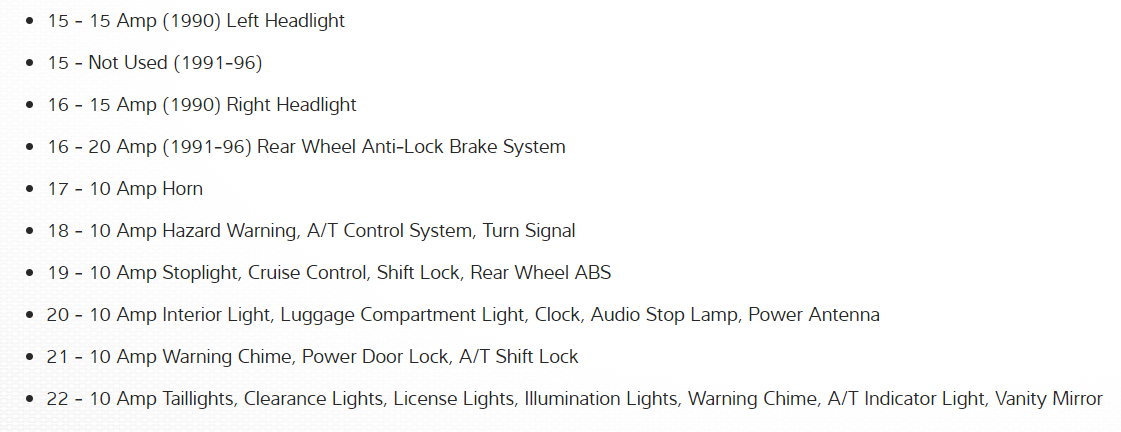

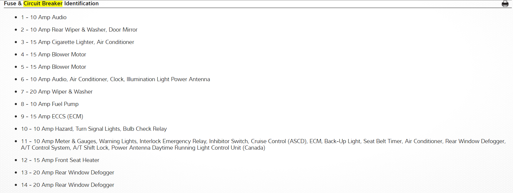

The first thing we need to do is check the fuses. This guide will help you want to see if they have power as well because it sounds like the ignition switch might be bad.
Here is a guide to help with the fuse location as well in the images below:
Do the test with the key on. Check out the images (below). Let us know what happens and please upload pictures or videos of the problem.
