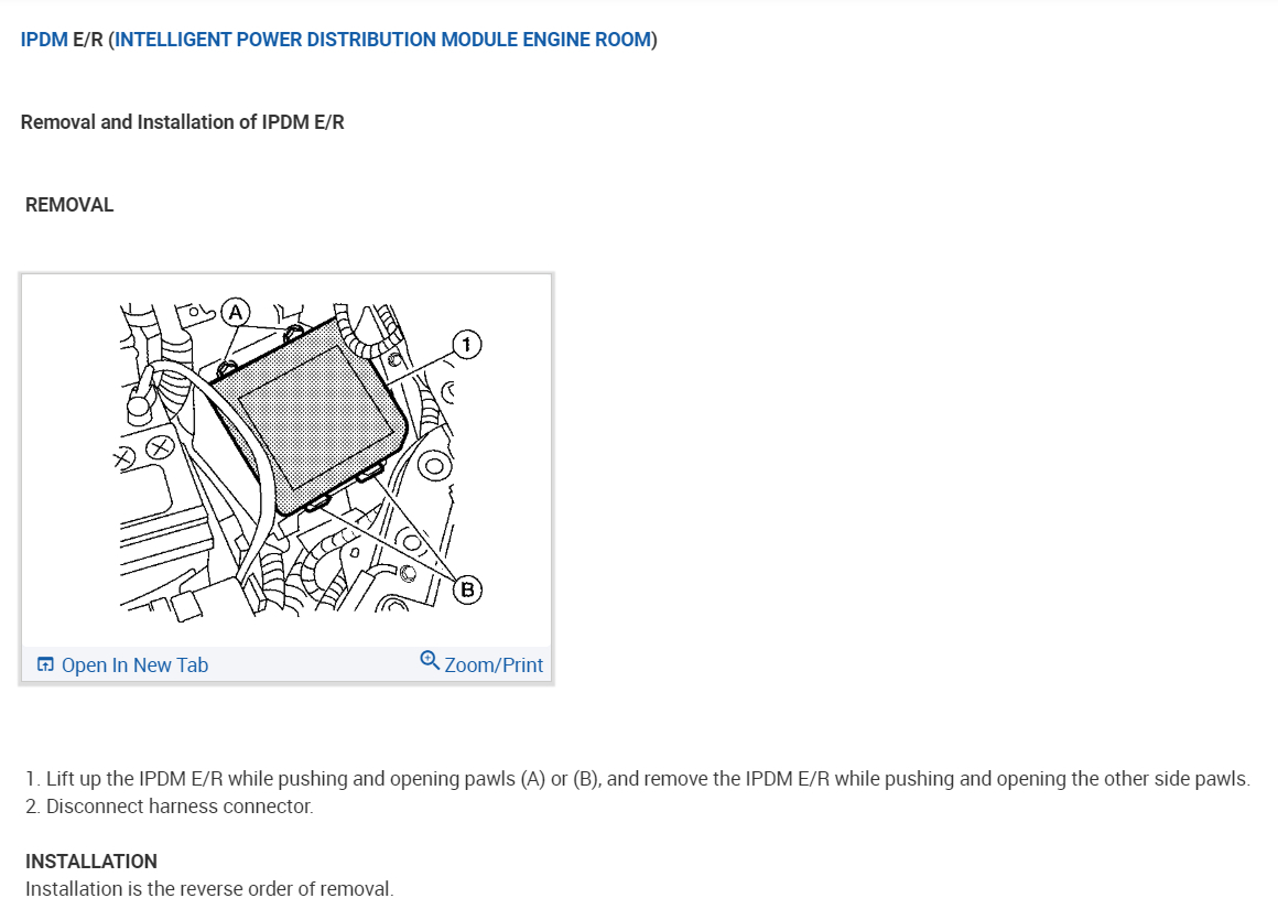

Every morning my car crank but won't start if check battery, check engine and check oil light didn't show on dashboard. car will only start if those 3 mentioned flashes.the car will work through out the day until next morning when it won't start again if those 3 check didn't flashed when Ignition key is turn on .

This sounds like the IPDM is going out. here is a guide to help you replace it. Here is the instructions in the diagrams below to help you change it out. Check out the diagrams (below). Please let us know what happens.
