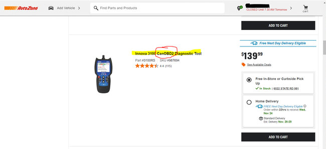

Which brand and type of scanner will work with my car? several models at AutoZone. workers at AutoZone don't know what is CAN.
Nov 22, 2021 at 9:25 AM
  • 110,248 POSTS
CAN stands for controller area network. Basically, picture several computers at home or work that are tied together via a few wires. That is how the computers/modules are in your vehicle. They communicate with each other via a few wires connecting them, the CAN bus system.
On older vehicles, this design wasn't used, so it was difficult to retrieve codes that were stored in other computer modules.
I attached a pic of one at AutoZone that has the ability to communicate with the CAN below. You can get these for much less money on Amazon, but I thought since you went to AutoZone, I could show you what they have.

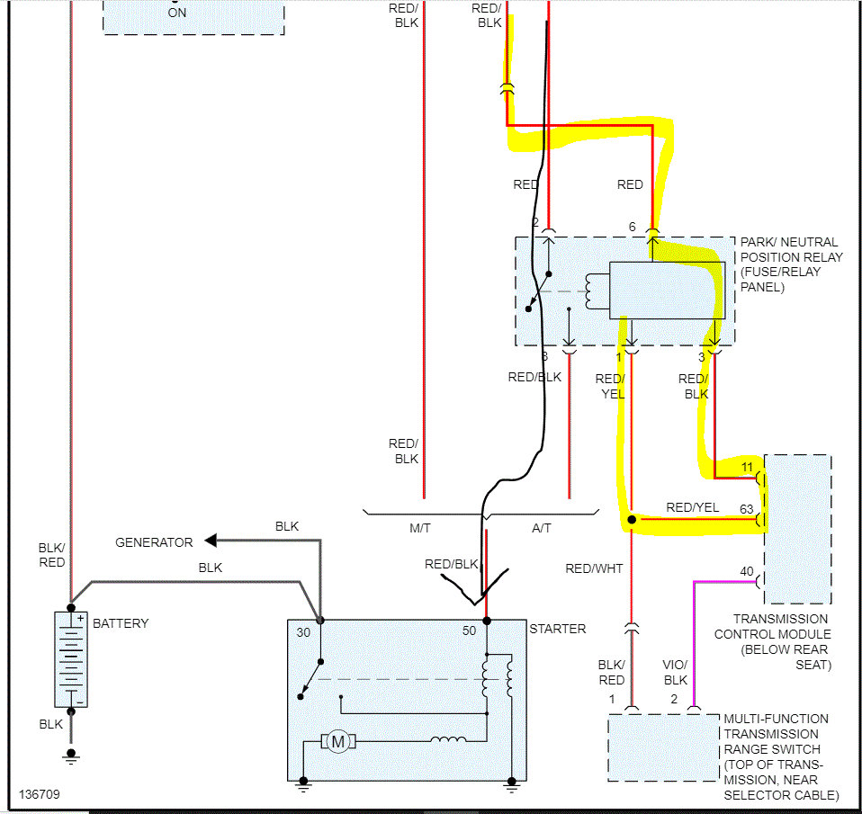

repaired the cables that are shorting out with each other due to worn insulation. no more fault codes after scanning this time. however, the engine still would not crank. the gauges flicker same time as the 409 relay clicks. cleaned all grounding spots. what could it be?
Dec 6, 2021 at 12:30 PM
  • 110,248 POSTS

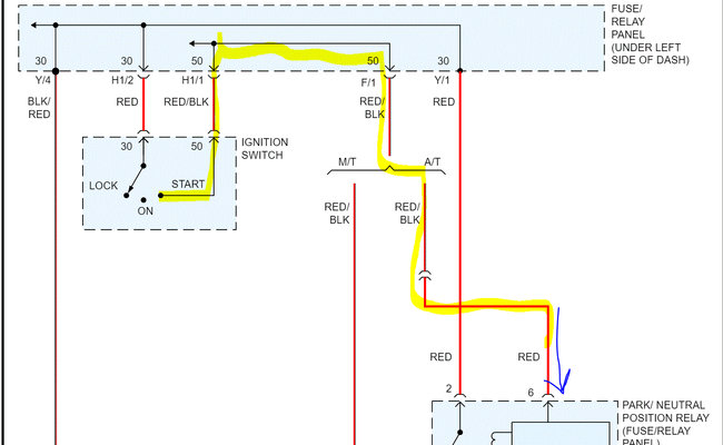

Are you certain the battery is good? If you are, we need to check for power at the S solenoid at the starter. You will need a helper to do this. The wire color at the starter motor is red with a black tracer. It will be the one which is smaller in diameter.
Have a helper turn the key to the start position while you check for power at the starter.
I attached the wiring schematic below for your review. I had to cut it in half to make it readable, but I did overlap them so you can follow from one to the next. Additionally, I highlighted the circuit.
The idea that the gauges jump when the relay clicks really sounds like a poor connection at the battery or a weak battery. Make sure to check both.
Let me know what you find.

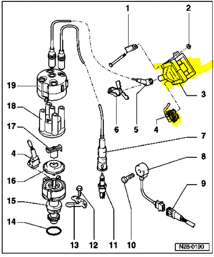

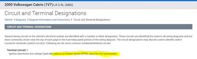

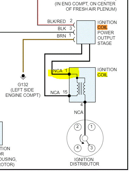

Thank you. While I was warming up the engine, I noticed the tachometer instrument fluctuates from 1,000 RPMs to 7,000 RPMs and it keeps moving, while the actual engine speed remains the same at 800 RPMs. What is causing this behavior?
Dec 24, 2021 at 2:08 PM
  • 110,248 POSTS
The signal is coming from the ignition coil (circuit 1) and VW is known for corroded connectors causing issues with the tachometer. If you look below, I included pics showing the coil, schematic, and definition of circuit 1.
Locate the coil and inspect the connectors to it (not the coil wire to the distributor).
