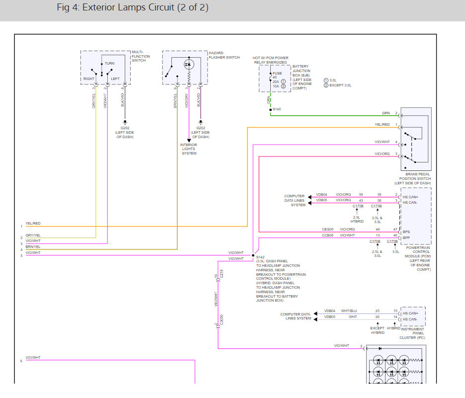

My driver side tail light will not work. Everything else works. It is not the bulb, socket, or the plug that plugs into it. Any suggestions were to start? Thanks.
May 5, 2016 at 2:11 PM
  • 55,837 POSTS
Hi ITISME1981

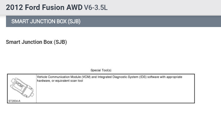

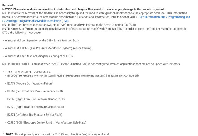

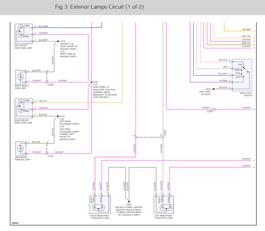

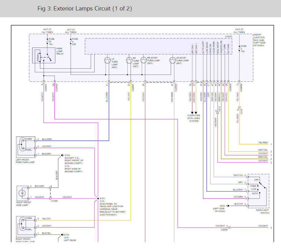

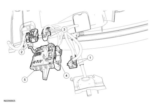

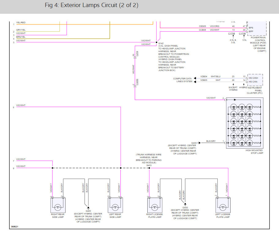

It sounds like the SJB is out and needs to be replaced but to be sure lets do a CAN scan which is the future of automotive repair you can get a CAN scanner from Amazon for about $50.00 here is a video to show you how.
https://youtu.be/InIlnsjOVFA

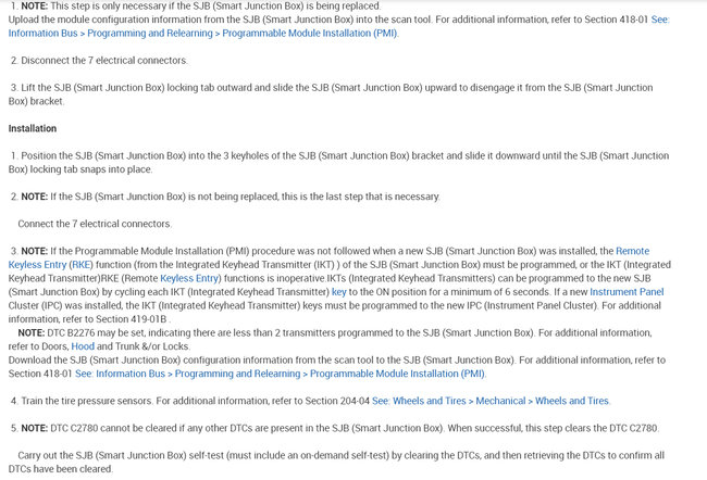

Here is the instructions on how to replace the SJB (smart junction box) in the diagrams below I have also included the tail light wiring diagrams so you can see how the system works. Check out the diagrams (Below). Please let us know what happens.

Thanks! I had this repair had to get a new SJB cost me $342.00 fixed it!

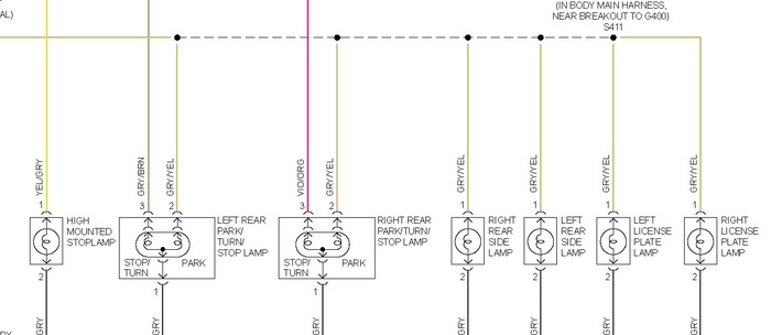

how can i fix left tail light on 1999 Ford windstar van. I check for power and is none, traces the wire still no nothing.cluster light indicating tail light malfunction. no matter what I do, no luck.i put a pig tail from right taillight to left, it work but the warning light at cluster stain on, I appreciate your help please. Thank, Luis Davila
Dec 13, 2019 at 5:52 AM (Merged)
JDL
  • 16,098 POSTS
Do the other tail lamps-- marker lites--tag lites, at the rear work? They are all connected, same voltage source. Gray wire with yellow tracer. You have to backtrack the circuit till you hit voltage. At the moment, I don't know about the warning lamp?
  • 75,988 POSTS
Check and test the Splice S-411 gray and yellow wire in body main harness near break out to G-400 could be open here to the left light bulb socket,Problem with the headlight switch, park relay and the smart junction box at base of left " A " Pillar
