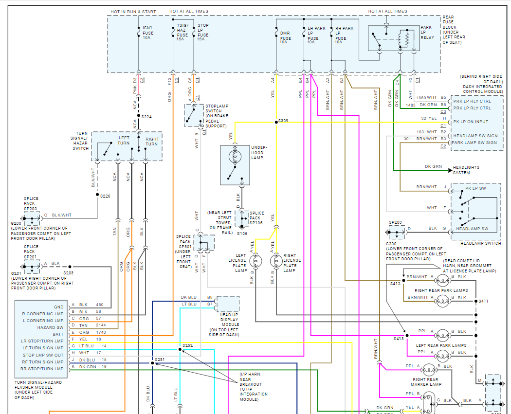

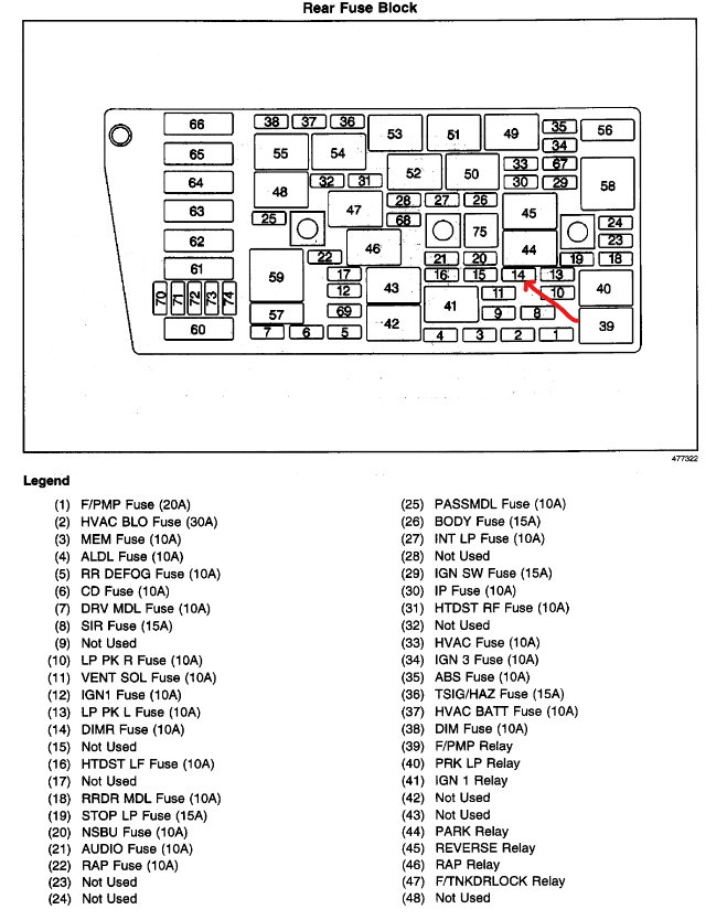

I have no license plate light nor reverse lights. I've checked all the bulbs, they're good, all the fuses their good. I've checked the wiring harness on the connection from the wiring harness from the fuse box under the seat to the harness to the panel on the truck and I have power to all wires except the green wire coming from the fuse box. I'm lost, I don't know what else to do. Can you help please?
Oct 10, 2024 at 7:49 AM
  • 55,433 POSTS

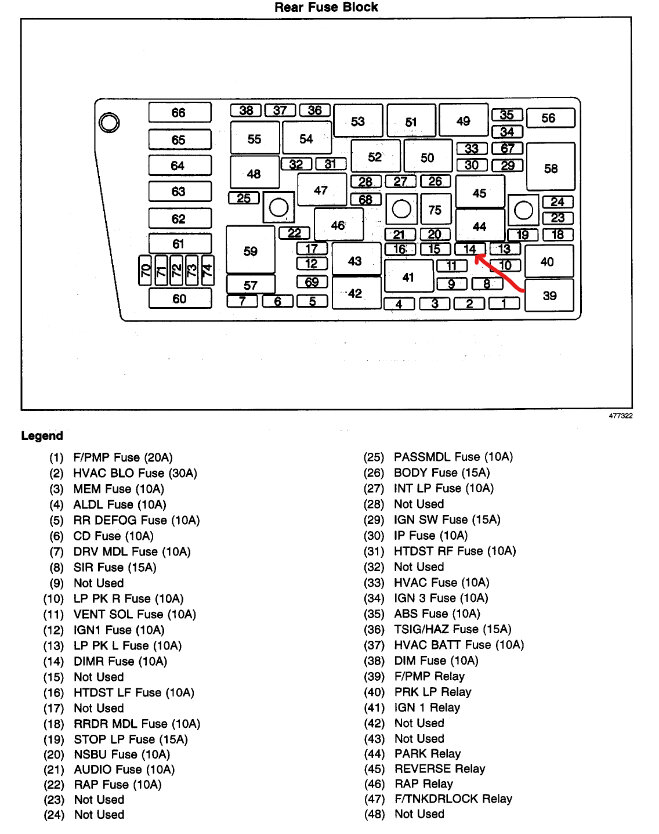

We need to see if we have power at the DMR fuse and to see if the fuse is good, this guide can help. The fuse is in the rear fuse panel.

It is int he fuse panel, please revisit my first post. It shows the location.

Hi Ken, Sorry for the delay. I had cataract surgery on Monday. Needed a day to recoup. I checked fuse # 14 and it was good. Any suggestions??
Oct 15, 2024 at 7:11 AM
  • 55,433 POSTS

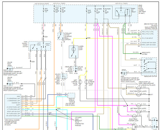

Go Packers! No worries, it sounds like the ground is bad, with the running lights on please use a test light to test for power (yellow) and then ground (black). Let's see which one is missing.

Hi Ken,
How are you doing? I checked the yellow wire. I have power. I don't have power on the black and green wire, but I have power on the purple wire and the white and black color wire. I'm assuming that black is ground, right? and green is part of the whole circuit along with the other wires for the license plate, reverse, running lights on the trunk panel. so why isn't the green wire hot. I've checked 3 ft from the connection and still nothing.
Oct 21, 2024 at 5:38 AM
  • 55,433 POSTS

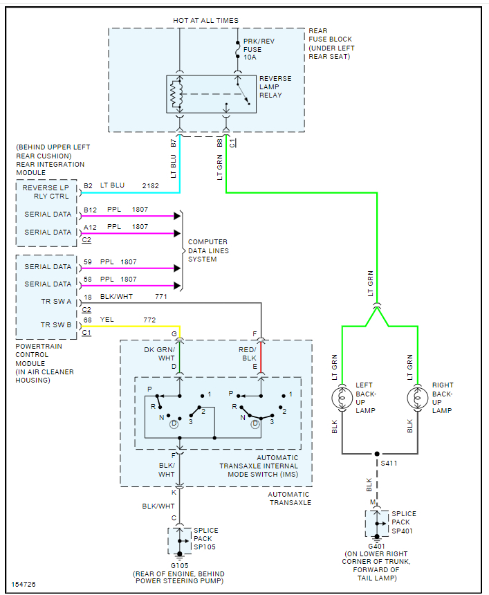

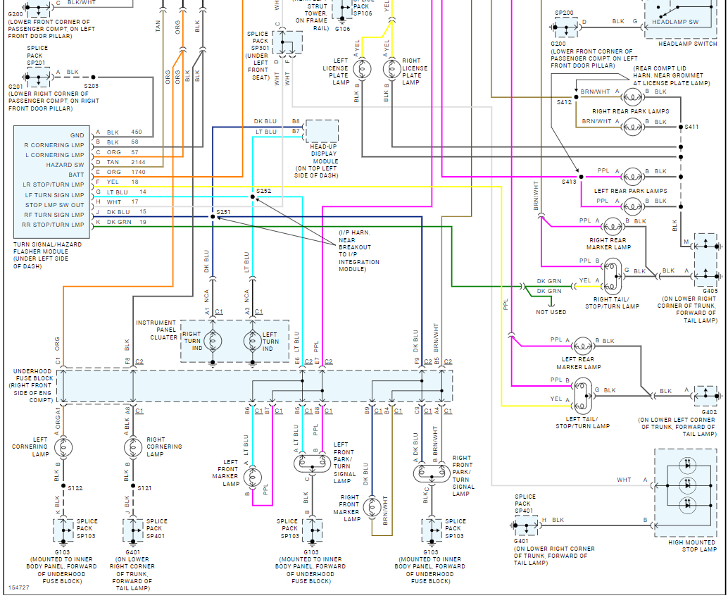

So is the ground good? Here are the wiring diagrams for the reverse lights and the license please lights as well so you can see how the system works. Simply check the power and ground to see where you lose them. Check out the images (below). Please let us know what happens.

Hi Ken, so it was the ground connection inside the connection coming from the main harness. it was broken somehow. i made my own and sodered it back on the wire pushed it back in the connection and bamm it worked so thx for the info and time. Norb
