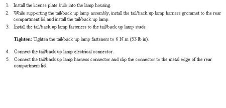

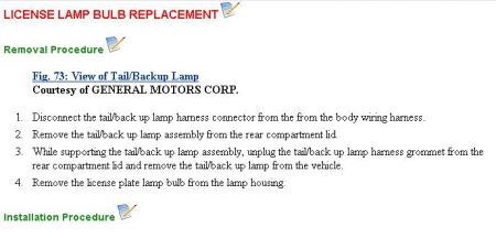

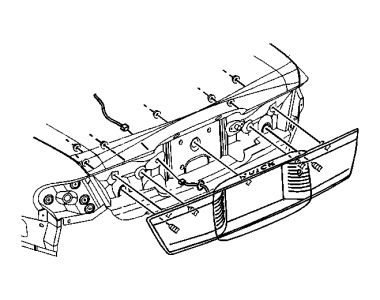

Change license plate lamps (two).

https://images.2carpros.com/forum/automotive_pictures/55316_04lesabrelicense1_1.jpg
https://images.2carpros.com/forum/automotive_pictures/55316_04lesabrelicense2_1.jpg
https://images.2carpros.com/forum/automotive_pictures/55316_04lesabrelicense_1.jpg

Yes you will need to removed the complete tail light assembly! If you move the trunk interior trim away from the trunk striker from one end to the other there is some plastic retaining nuts holding it in place. Once removed it should come right out with a little work.

The same applies to the trunk lid. There is about seven or eight retaining nuts holding it on. Remove them and it should just pop out.

There are seven, number 10 nuts in side on the trunk lid. After you take those out the tail light assembly will pull out. Half a turn plastic socket will come out. Just changed mine last week, about a fifteen minute job. Hope this helps. Kenny

f you have no access from the lens or the trunk, you will need to remove the assembly. I believe the bolts are accessable throught the trunk (10mm I believe).
