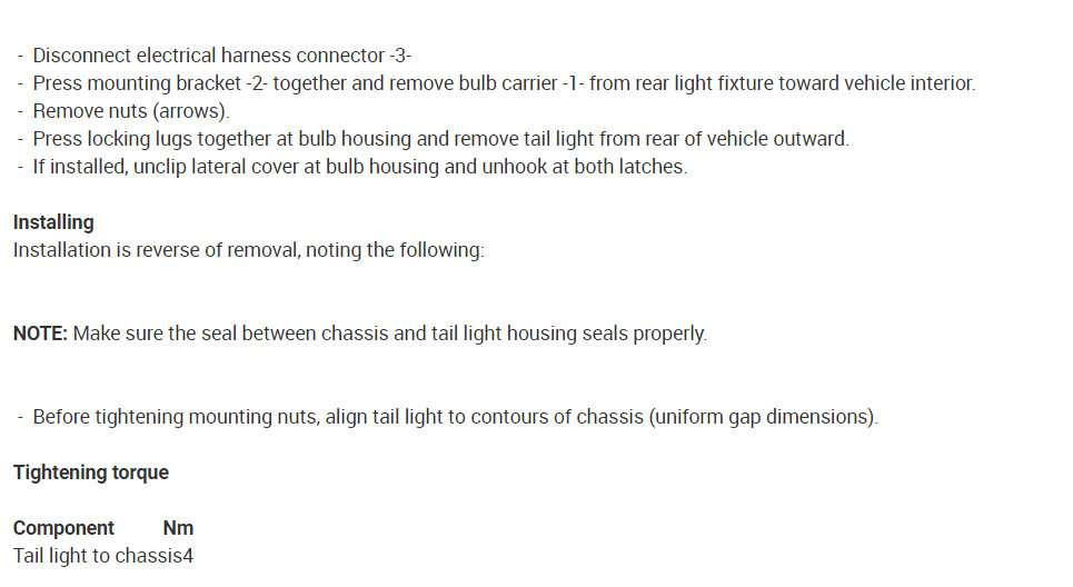

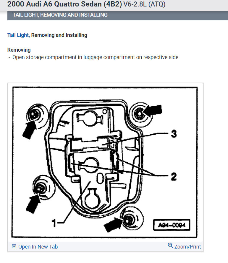

I have the vehicle listed above 2.7t Quattro. Trying to replace driver's side rear turn signal light bulb. I can't get one of the bulbs out. Normally I just twist and pull to remove it but one bulb has a plastic casing that prevents it from being pulled out.
May 24, 2021 at 10:10 PM
  • 55,781 POSTS
Here is a guide to help you step by step with instructions in the diagrams below to show you how on your car:
https://www.2carpros.com/articles/turn-signal-bulb-replacement
