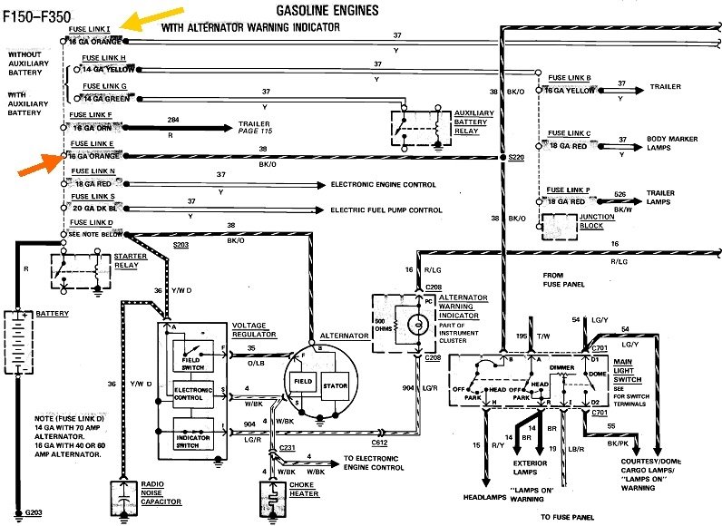

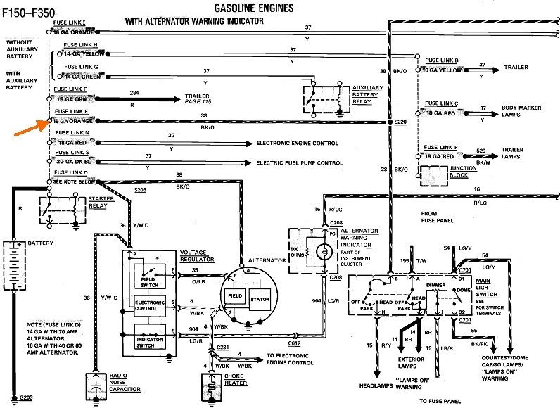

The place to start is by checking the fuse link wires, in particular the orange one indicated by my orange arrow. There's two different versions of this diagram depending if your truck has or doesn't have gauges. This one is without gauges.
The dashed line running up and down next to the orange arrow indicates all of these fuse links are connected to the same larger stud on the starter solenoid as the positive battery cable. That was simply done because that stud is a convenient tie point that's easier to connect to than the battery cable clamp. The solenoid isn't actually part of the circuit at this point. Professionals like myself have been known to overlook some of these wires when connecting a new solenoid or when replacing the battery cable. People have also been known to connect them on the wrong stud. All the fuse link wires have to be connected to the stud the battery cable goes to. There's always only one large cable on the other large stud. It goes to the starter motor.
Tug gently on the fuse links to test them. If they act like a wire, they're okay. If they act like a rubber band, they're burned open and must be cut out and replaced. Fuse links take some time to burn open.
There's another orange fuse link way at the top of the first diagram. That one feeds the ignition switch, so it is a good suspect.

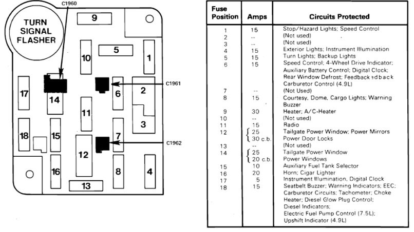

You'll also need to check all the fuses in the fuse box. Here's a link to a dandy article if you need it:
Testing can be done very quickly with an inexpensive test light. Spade-type fuses have two small holes on top for test points. Check for 12 volts on each test point. If you find 12 volts on both of them, that fuse is okay. If you find 0 volts on both, that circuit is currently turned off. You're looking for any fuses that have 12 volts on one side and 0 volts on the other.

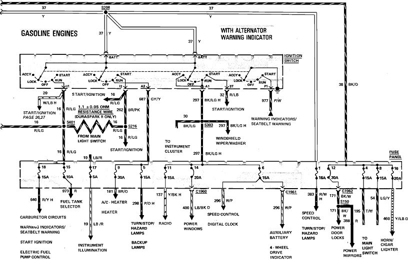

Thank you for the reply. So when I test the fuse box and all of the fuses in it all of them are reading 0 volts on both sides. I think it is the ignition switch that is the problem but I can’t seem to locate it on my truck.

Ignition switches don't care about reversed polarity. You are likely right that there's no voltage on any fuses, but that points even more strongly to the fuse link wires.
Your ignition switch is mounted on the top or right side of the steering column, under the dash. It has multiple sections, so even if part of it had a burned or pitted contact, something would still work. Most common for all ignition switches is the section that turns on the accessory circuit fails first, to include melted terminals in the connector body. This circuit has the most stress on it, especially when people turn the switch on and off while the heater fan motor switch is on one of the higher speed settings. That forces that part of the ignition switch to turn that high current on and off, and that causes internal sparks and arcing that leads to the switch failure.
Also, with your switch design, it is mounted with two small screws, and the mounting holes are slotted to allow for adjustment. It is not uncommon for the screws to work loose, then the switch gets out-of-adjustment. The symptom typically is the dash lights will turn on, but you can't turn the switch far enough for the starter to engage. This is not related to reversed polarity.
If you look back at the diagrams, at a minimum, fuses 1, 8, and 12 should be hot all the time. Fuse 1 is fed from the top fuse link wire with my yellow arrow. Fuses 4, 8, 12, and 16 are fed from the other fuse link with the orange arrow. I don't see anything else in there. As I mentioned previously, more than one of us has left those wires off the solenoid by mistake, so double-check they're all connected.
