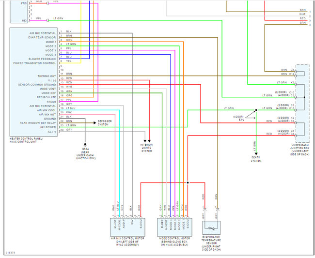

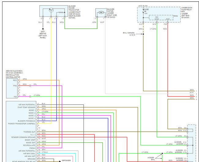

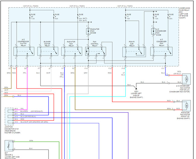

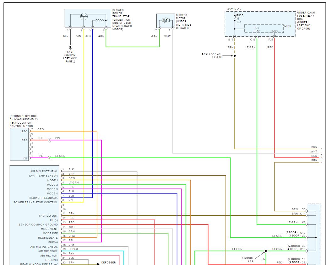

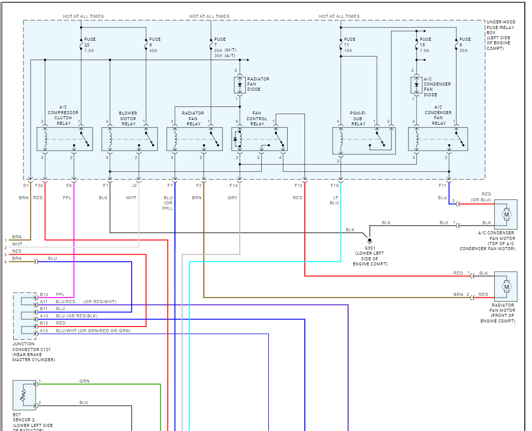

I have the car listed above that I bought used with the A/C not working. But since I live in Texas, I’ve been trying to get the A/C to work. I got my test light and started testing fuses under the hood and by the driver side compartment. Everything under the hood tested fine, but when I got to the fuses inside. I was testing them in the top row was good. The bottom row was good but the middle row you can barely see the light on my test light. Can anybody help me with this issue? I’ve watched numerous videos and can’t figure it out.

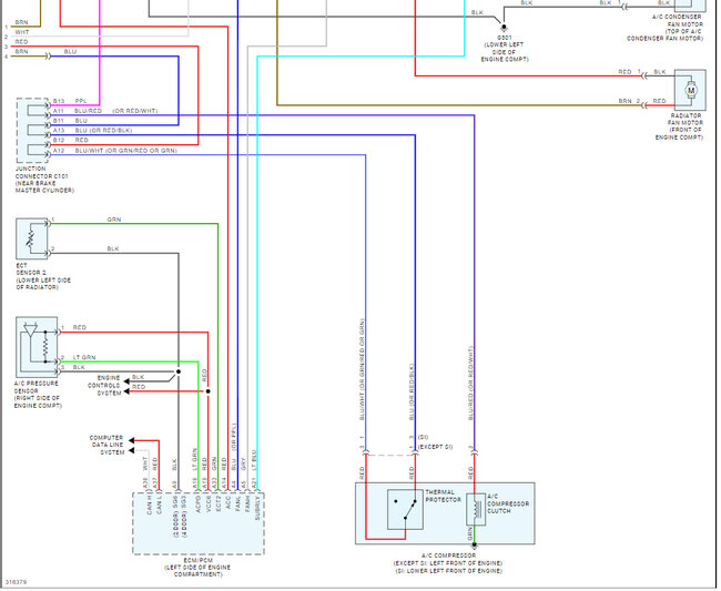

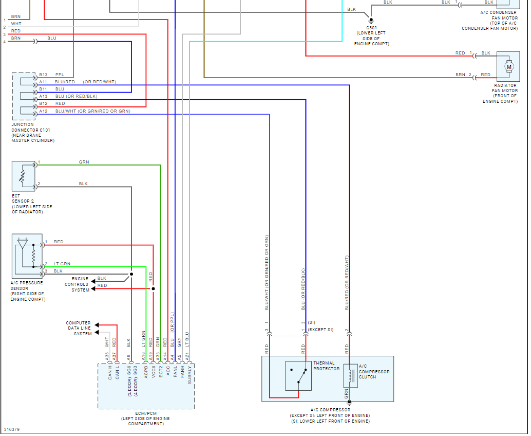

Sure, we can help you fix the problem. The first thing we need to do is see if the A/C system has refrigerant and the easiest way is by watching the video.
https://youtu.be/4UjfQKvrB6Y?si=gLVwXSBDL85Kstp5
Another way to tell is to see if the compressor clutch clicks in when the A/C system is on, please go over this video to see what I mean:
https://youtu.be/4UjfQKvrB6Y?si=fG-BVtXS_1BZGV75

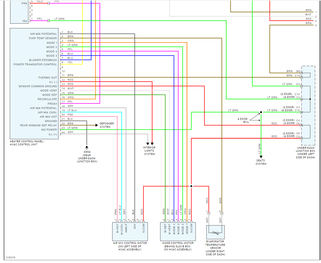

Here are the A/C system wiring diagrams so you can see how the system works. Check out the images (below). Let us know what you find.
