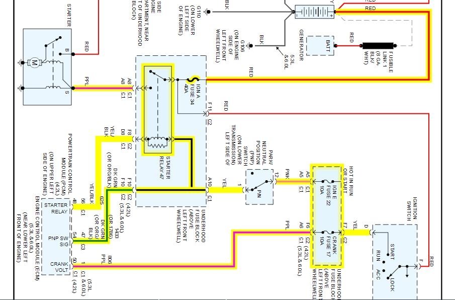

I am looking for the wiring diagrams for the start circuit from switch to starter and also diagram for fuse boxes. all I have so far is the relay is clicking when key is turned. thanks

I attached a wiring diagram for you to view. It includes the fuses and their locations for you to check. The crank fuse needs to be checked in the start position.
The ECM is what controls the ground for the starter relay.

Thank you. I have checked the crank fuse and it is showing power when switch is turned to start. I am stuck at wondering if it is the switch or the starter/solenoid because I am getting power across the crank fuse. I am confused with it for sure!

If you have power at the crank fuse, the switch and wiring are good to the fuse.
Check it at the relay now. Remove the relay and check for 2 powers with the key in the start position.
