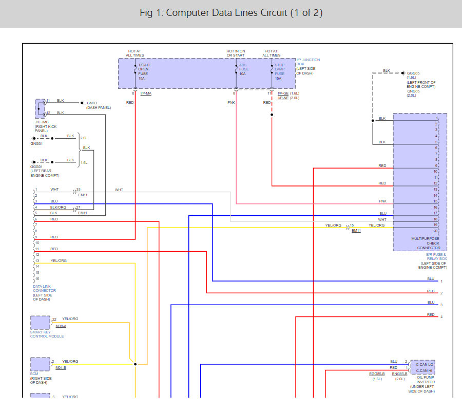

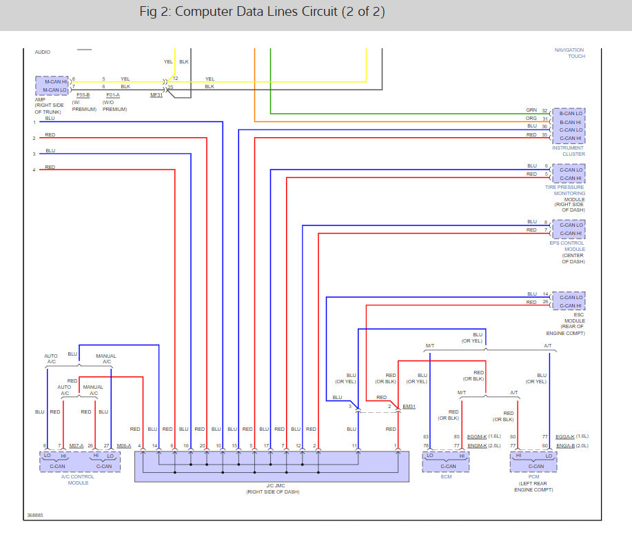

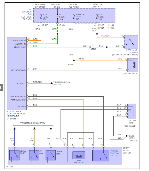

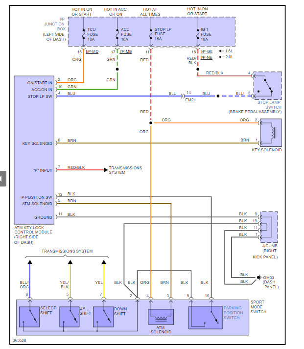

It sounds like you have a instrument cluster or BCM that when out but we should see if the Cluster, Room LP and IG2 fuse are okay inside the under-dash fuse panel on the driver's side. This guide can help, and I have included the fuses in the images below. If fact check all of the fuses for power with the key on.

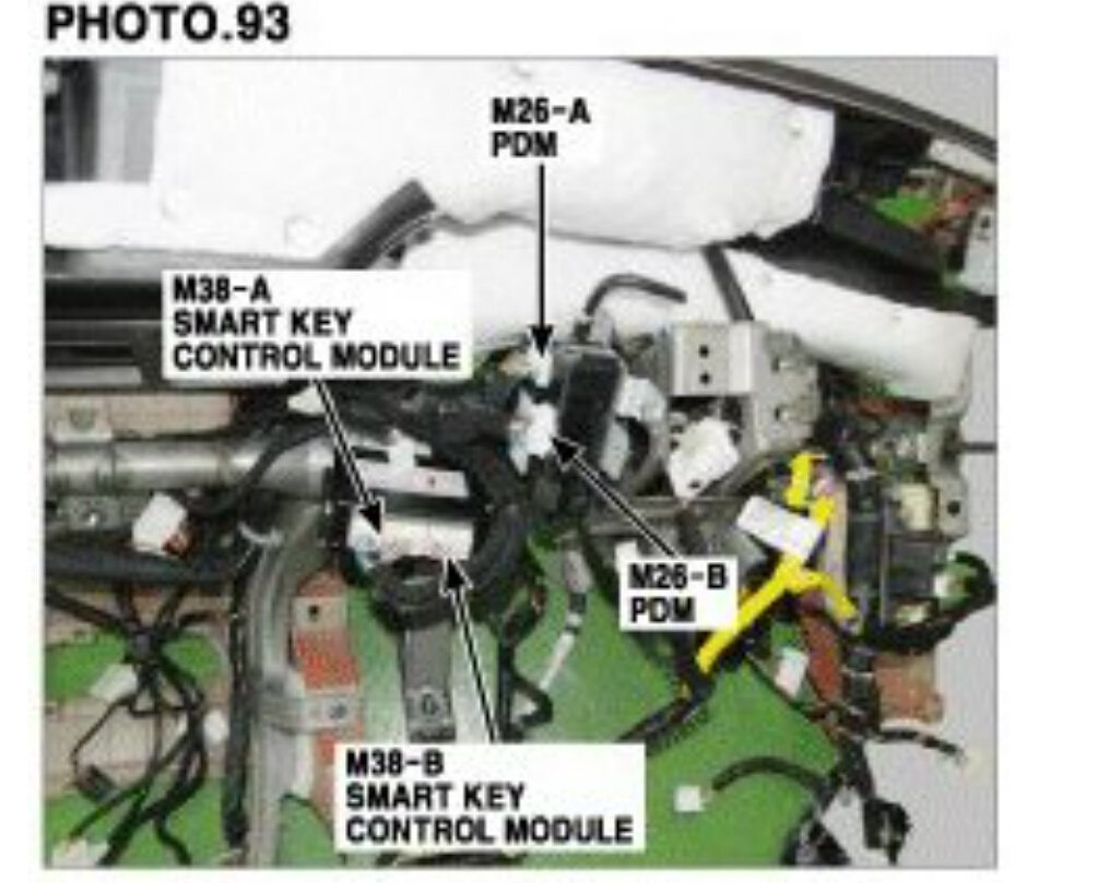

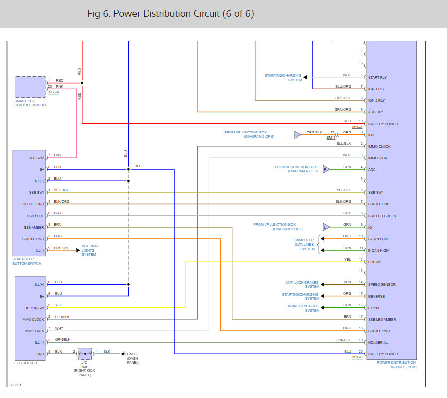

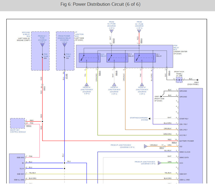

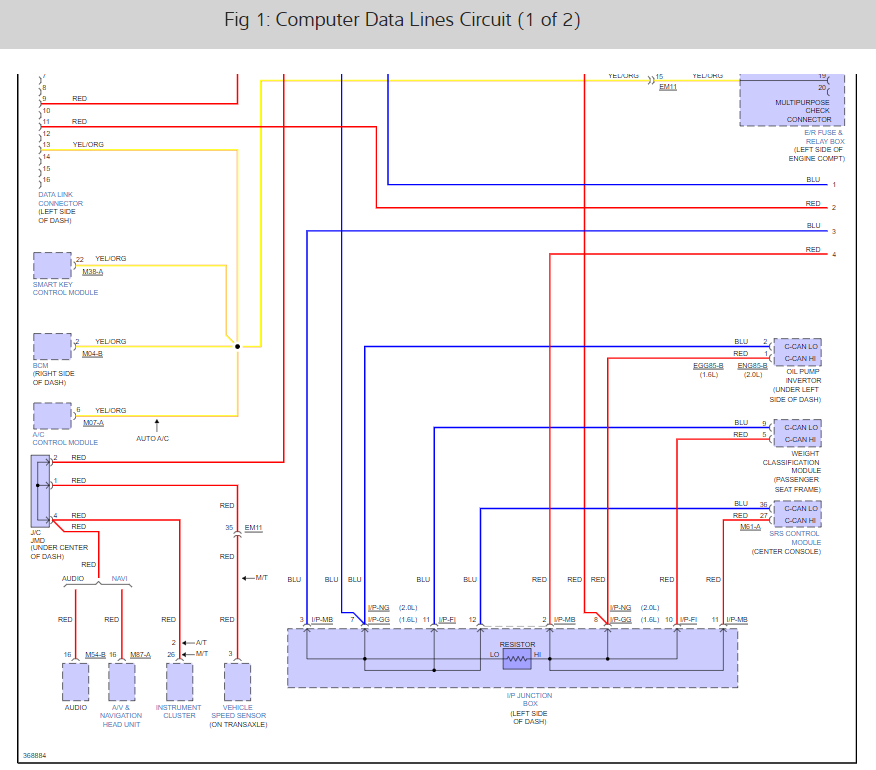

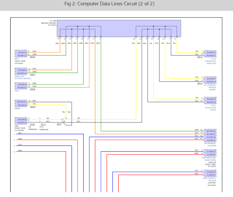

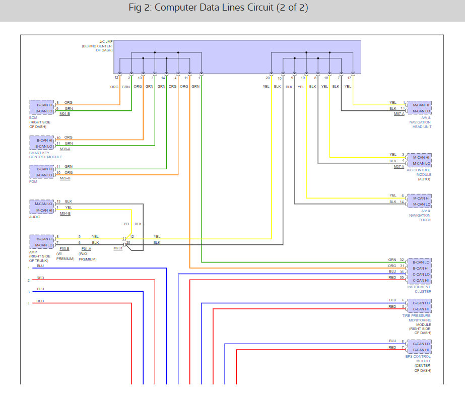

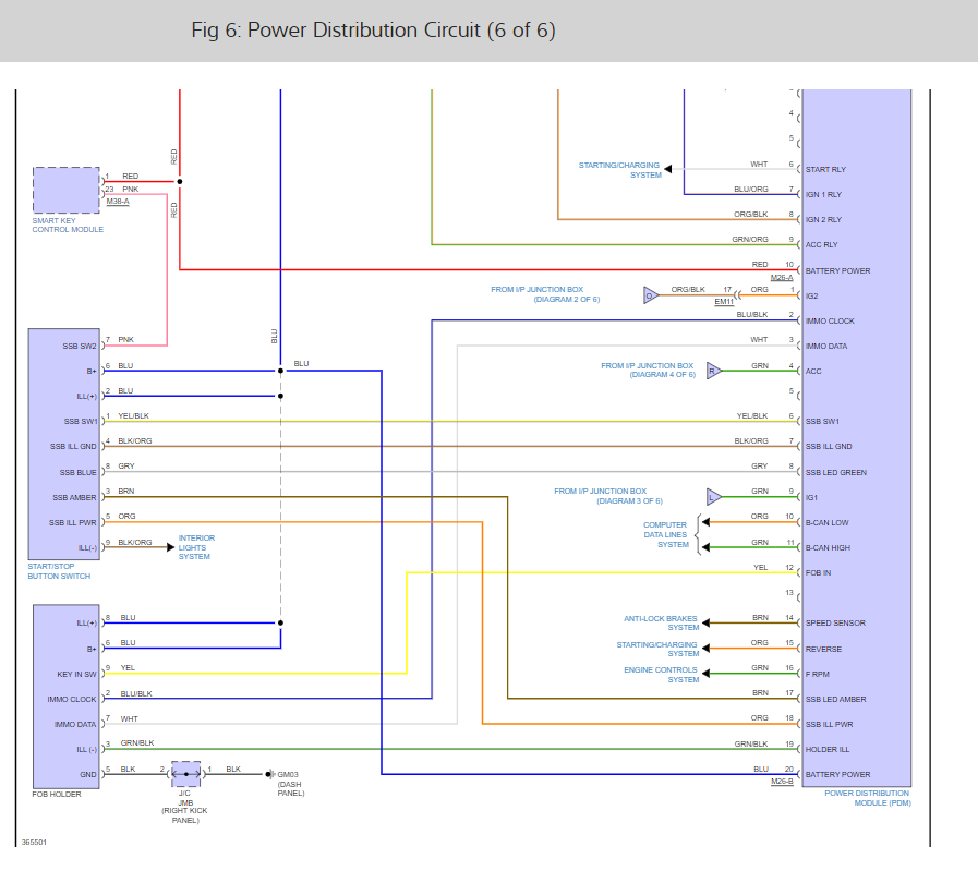

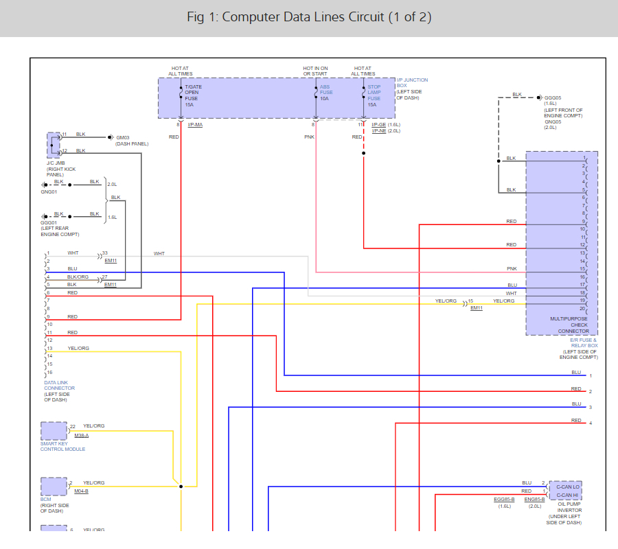

Here are the component wiring diagrams so you can see how the system works. You might have a power distribution module PDM that is out. Also check the ACC, IG2 and IG1 relays
