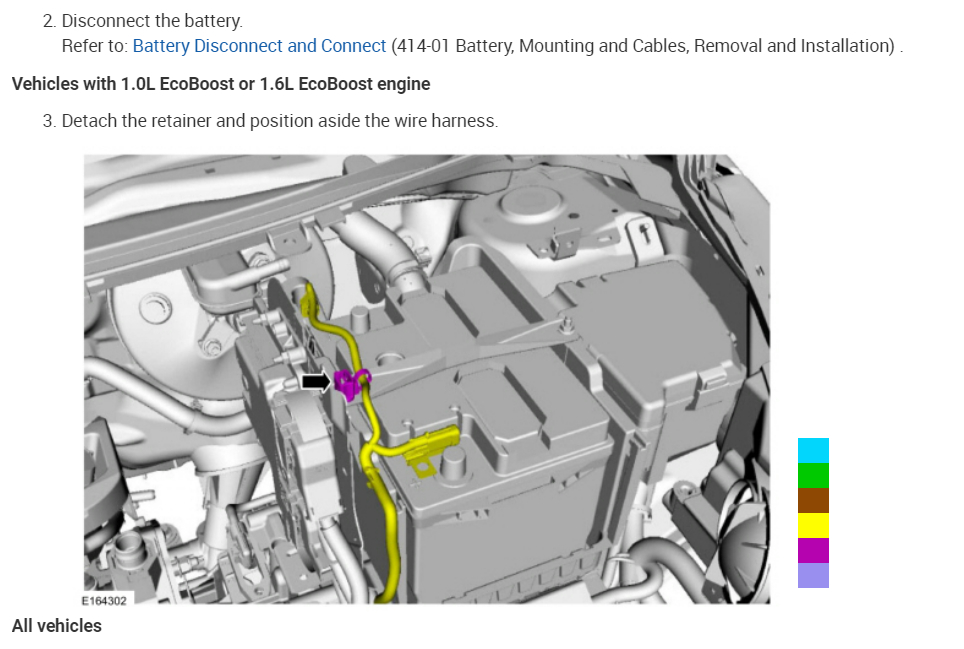

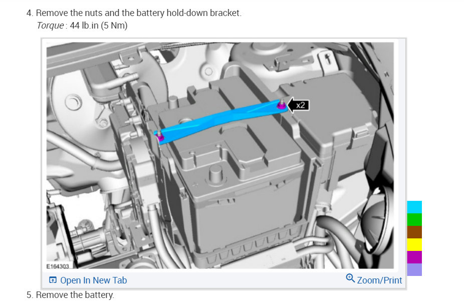

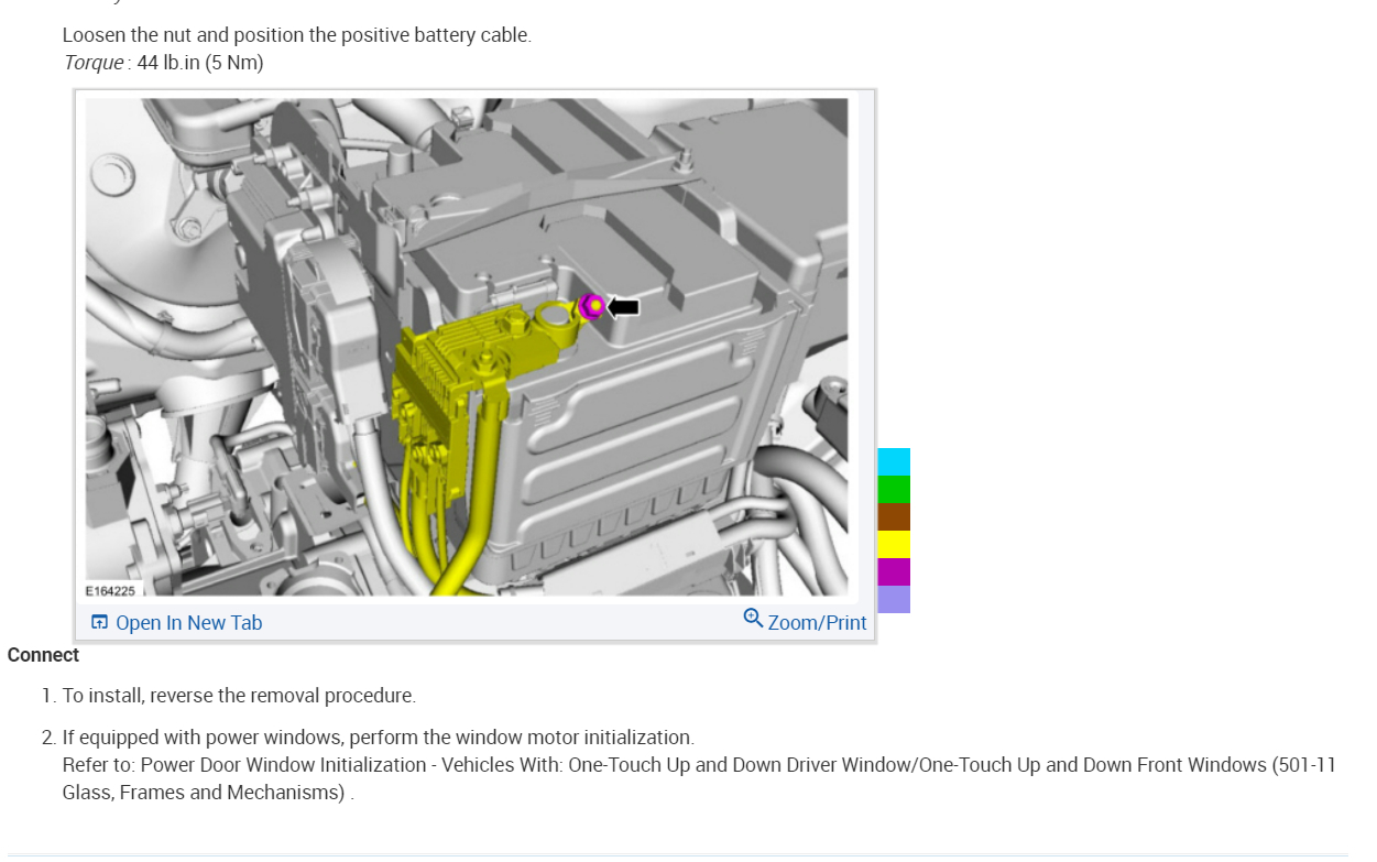

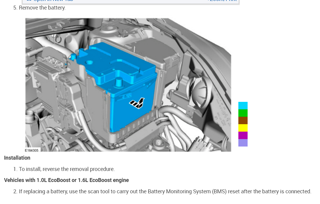

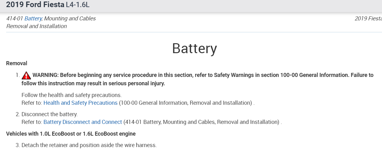

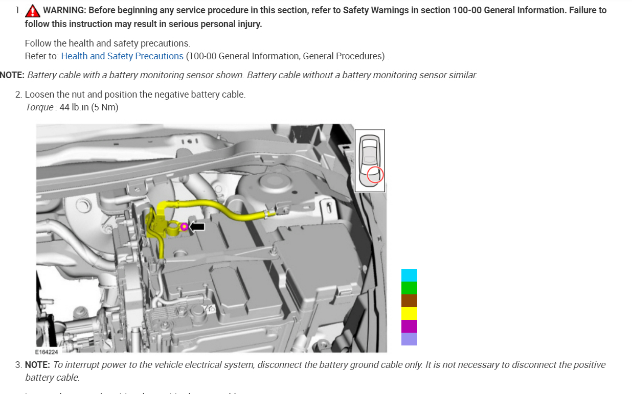

This is a classic bad battery symptom. here is a guide to help confirm the issue and instructions below to show you how to change out the battery in your car:
https://www.2carpros.com/articles/symptoms-of-a-bad-car-battery
You will need to reset the battery monitor after the new battery is installed using a scan tool, watch this video to see how.
https://youtu.be/ETNv2S_idIU
Also, this video shows the job being done on a similar car, the process is the same:
https://youtu.be/Yb-ytljdCjc
Check out the images (below). Please let us know if you need anything else to get the problem fixed.
