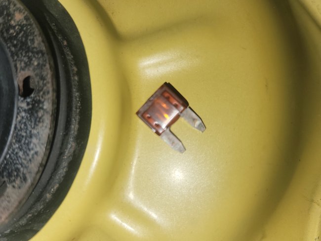

I checked the fuses and my fuel pump fuse went out and replaced it also.

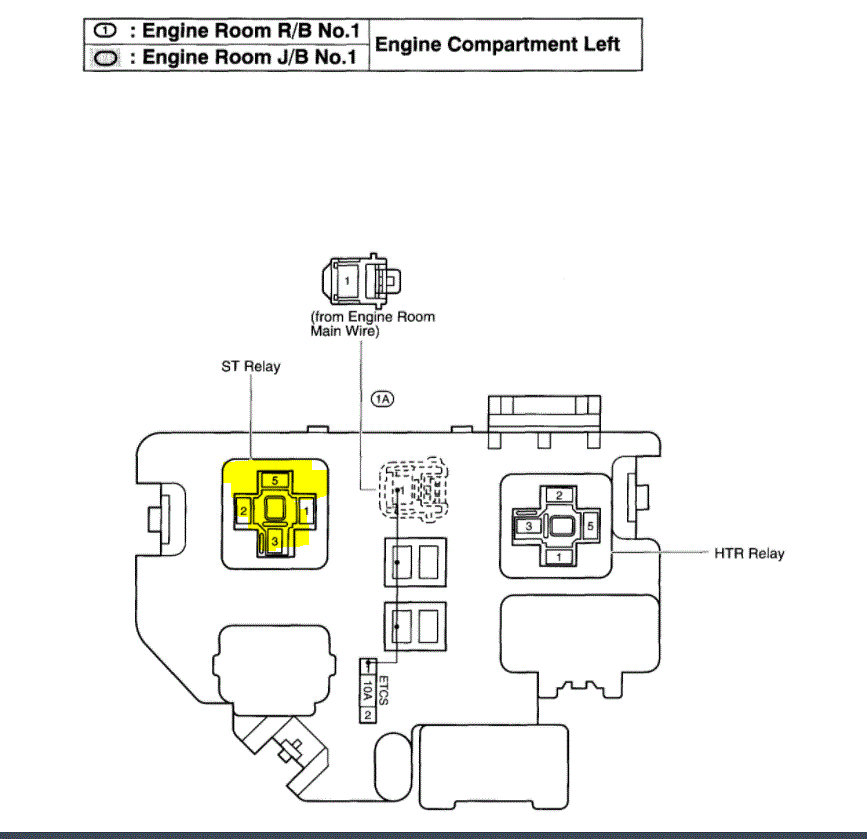

If the starter still clicks, try switching the starter relay to see if it makes a difference. However, since you are getting a clicking, chances are the starter is damaged.
I attached a pic of the starter relay below to help you locate it. If there is another relay in the box with the same part number, switch them to see if it changes things. If there isn't a relay to switch, here is a link that shows how to test a relay:

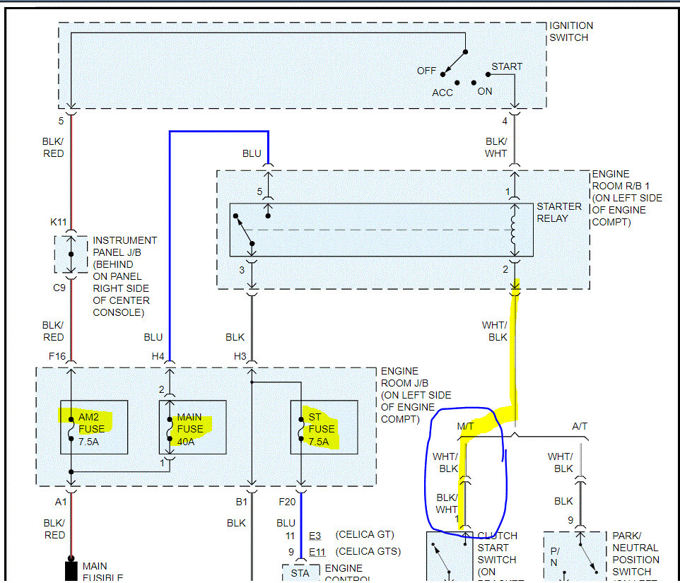

Also, I attached a pic below from the wiring schematic. Check the fuses I highlighted and check the wire I circled at the clutch switch. It should have power when the key is on. In addition to checking the fuse, make sure there is power to and from the fuses.
Jan 18, 2021 at 12:00 PM

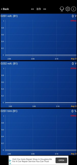

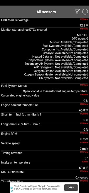

Okay, so I cleaned some fuses out and now my starter rapidly clicks and that's all.
Jan 19, 2021 at 4:56 AM
SOLO7499
  • 11 POSTS
Don't know if this helps.
Jan 19, 2021 at 5:00 AM
SOLO7499
  • 11 POSTS
Oh okay, so when I had the computer connected the starter clicked and when I don't have it connected it doesn't click?
Jan 19, 2021 at 5:02 AM
SOLO7499
  • 11 POSTS
Also I did have my alarm installed recently too.
Jan 19, 2021 at 5:05 AM

I watched your video. I saw the lights flashing. Are you certain that all fuses are good, and there are no wiring issues? Also, are you certain the AM 2 fuse I indicated above? Please note only check the fuse but make sure there is power to it. A fusible link powers it. A fusible link functions as a fuse but looks like a wire. Very easily it could have blown.
