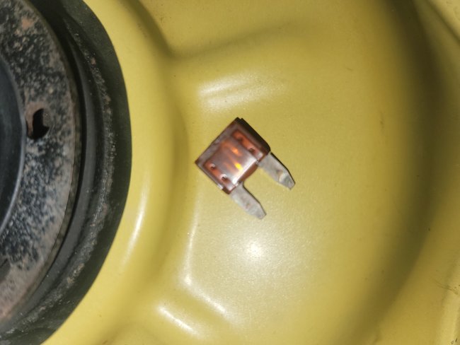

I checked the fuses and my fuel pump fuse went out and replaced it also.

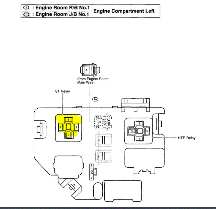

If the starter still clicks, try switching the starter relay to see if it makes a difference. However, since you are getting a clicking, chances are the starter is damaged.
I attached a pic of the starter relay below to help you locate it. If there is another relay in the box with the same part number, switch them to see if it changes things. If there isn't a relay to switch, here is a link that shows how to test a relay:

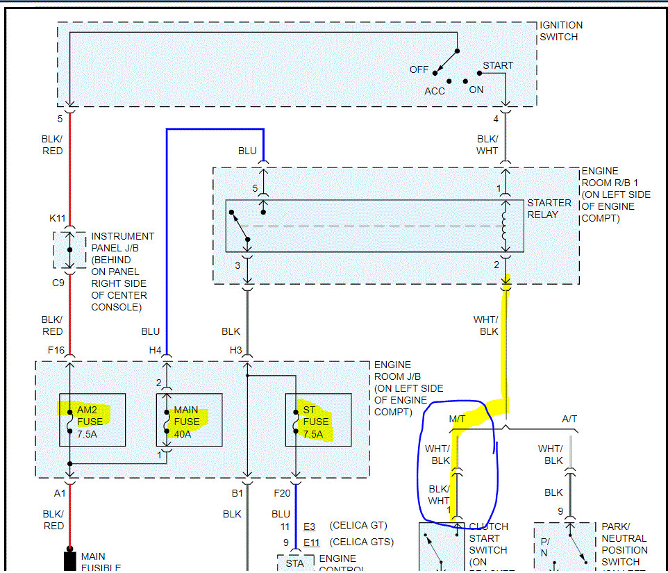

Also, I attached a pic below from the wiring schematic. Check the fuses I highlighted and check the wire I circled at the clutch switch. It should have power when the key is on. In addition to checking the fuse, make sure there is power to and from the fuses.

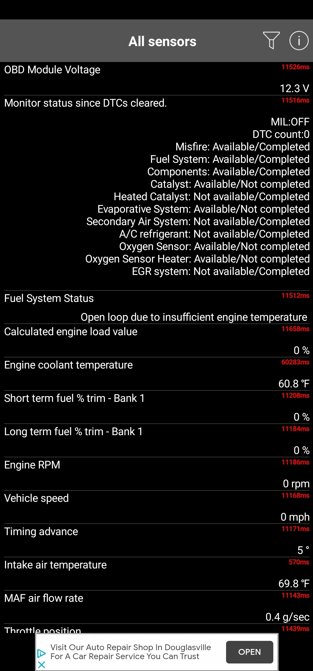

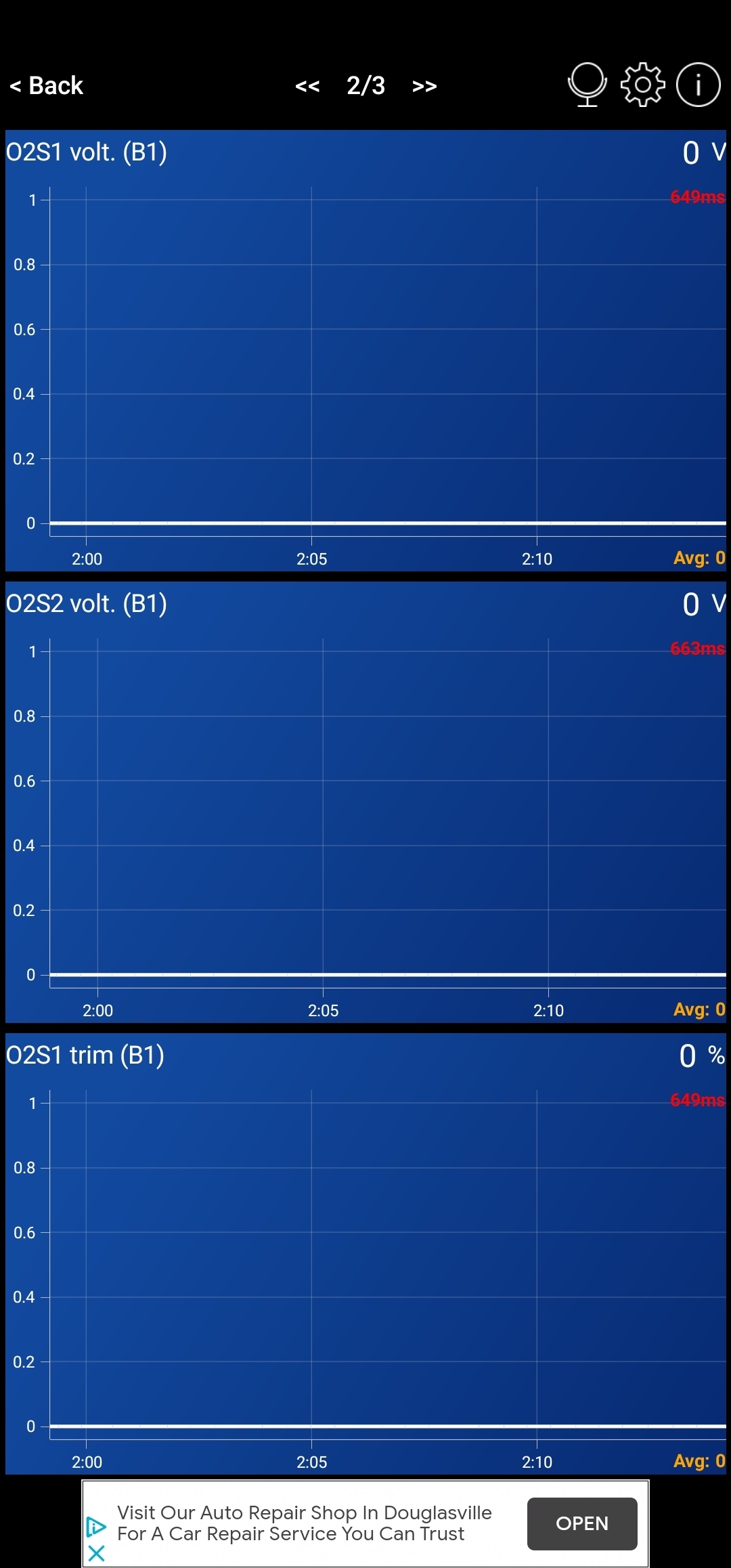

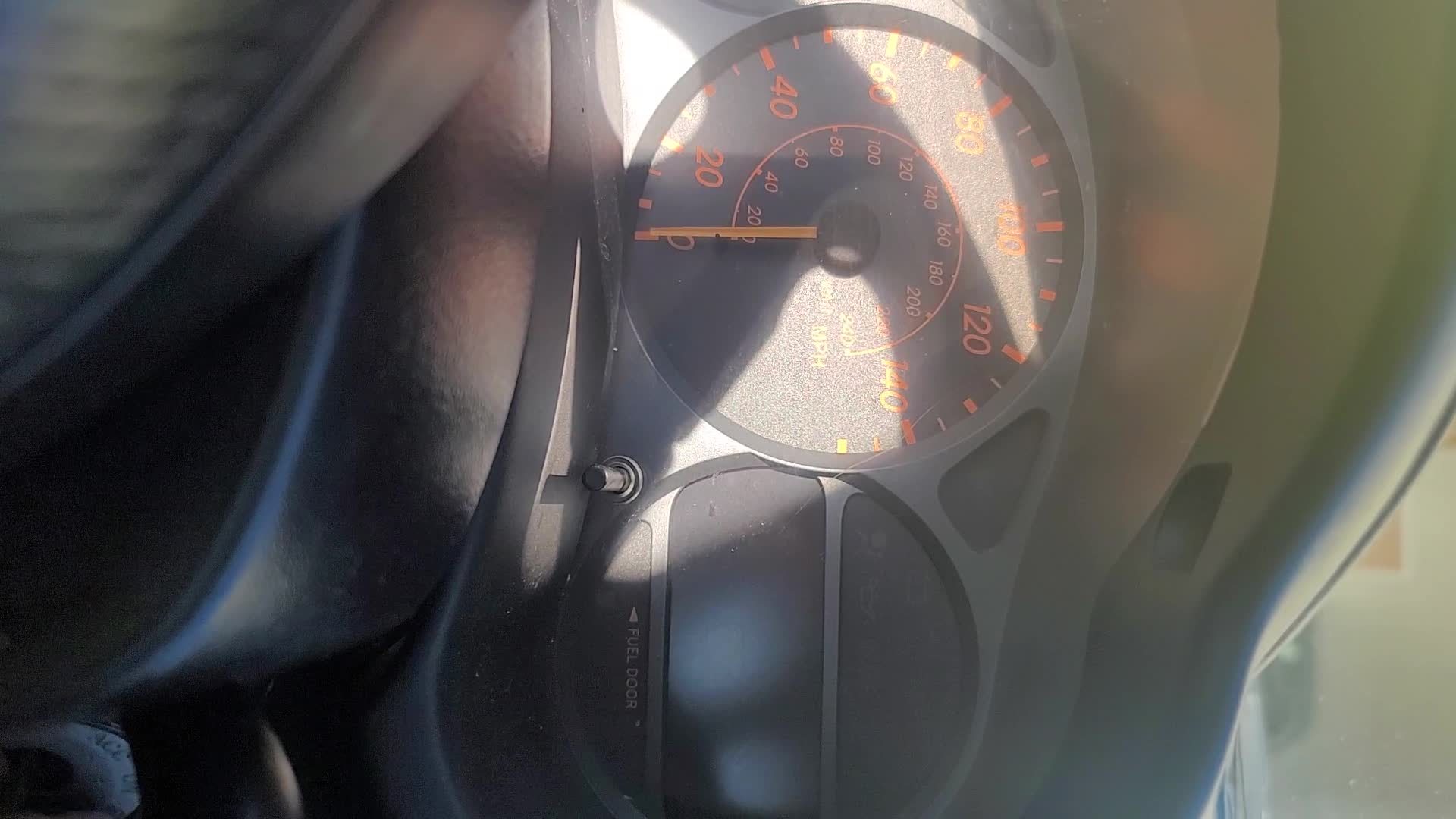

So basically I replaced the battery twice, the starter, and the alternator. Now when I turn it on the radio doesn't work and when I turn the key once only the airbag symbol shows and when I try to start it. It beeps for a couple of seconds and the dash flickers and the only thing that is flickering is the red battery symbol and the airbag symbol and I don't hear the starter clicking anymore after I replaced it. I will recheck all the engine bay fuses again and I will keep you updated.
Tuesday, January 19th, 2021 AT 10:43 AM
SOLO7499
  • 11 POSTS
Okay, so I cleaned some fuses out and now my starter rapidly clicks and that's all.
Tuesday, January 19th, 2021 AT 12:56 PM

Don't know if this helps.
Tuesday, January 19th, 2021 AT 1:00 PM

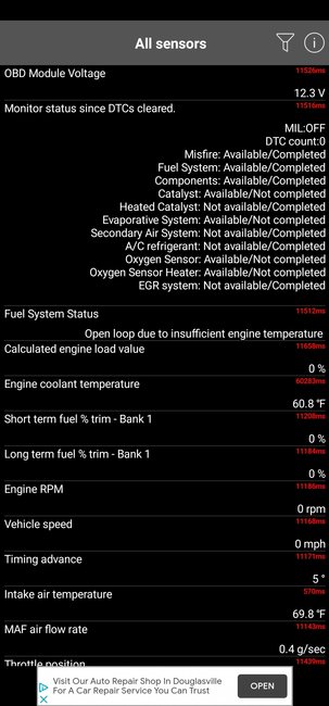

Oh okay, so when I had the computer connected the starter clicked and when I don't have it connected it doesn't click?

I watched your video. I saw the lights flashing. Are you certain that all fuses are good, and there are no wiring issues? Also, are you certain the AM 2 fuse I indicated above? Please note only check the fuse but make sure there is power to it. A fusible link powers it. A fusible link functions as a fuse but looks like a wire. Very easily it could have blown.
