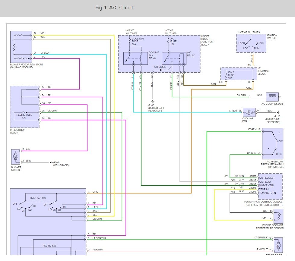

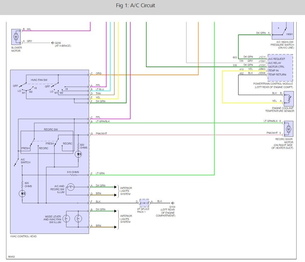

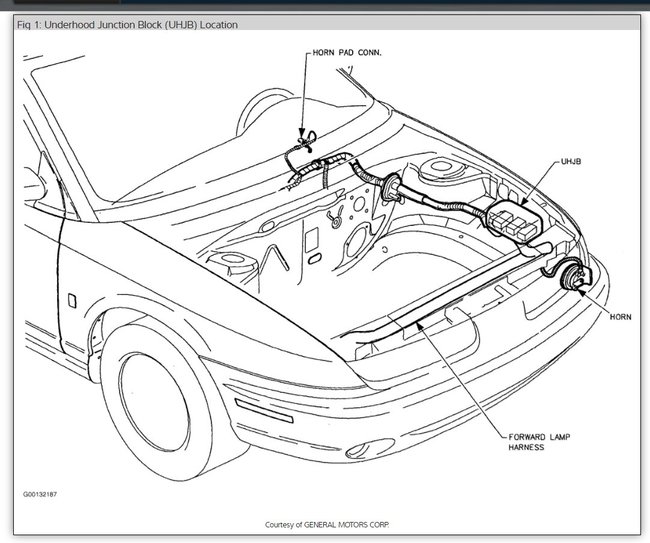

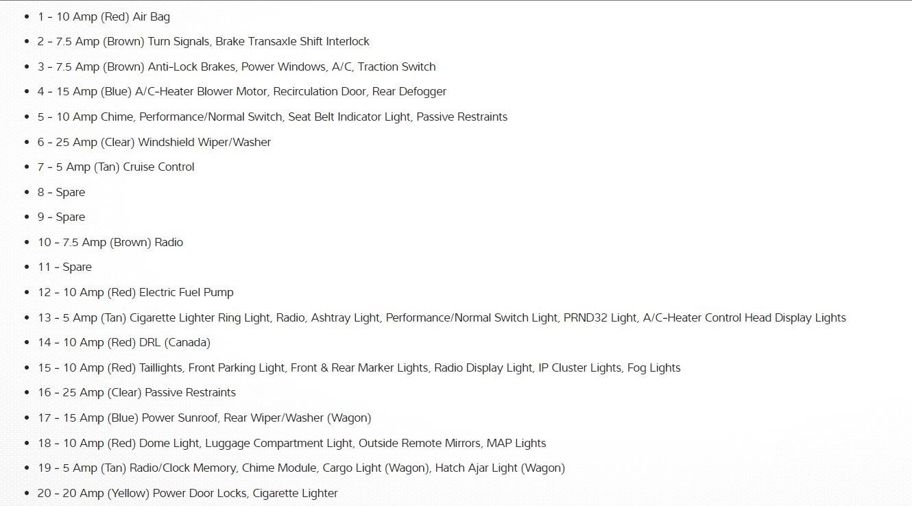

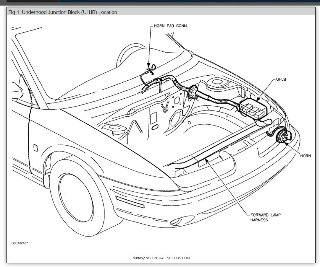

The cooling fan and air conditioner both are not getting power. Tried new relay. No change. Any ideas.
Jul 2, 2017 at 6:08 AM
Experienced Mechanic
55,549 POSTS

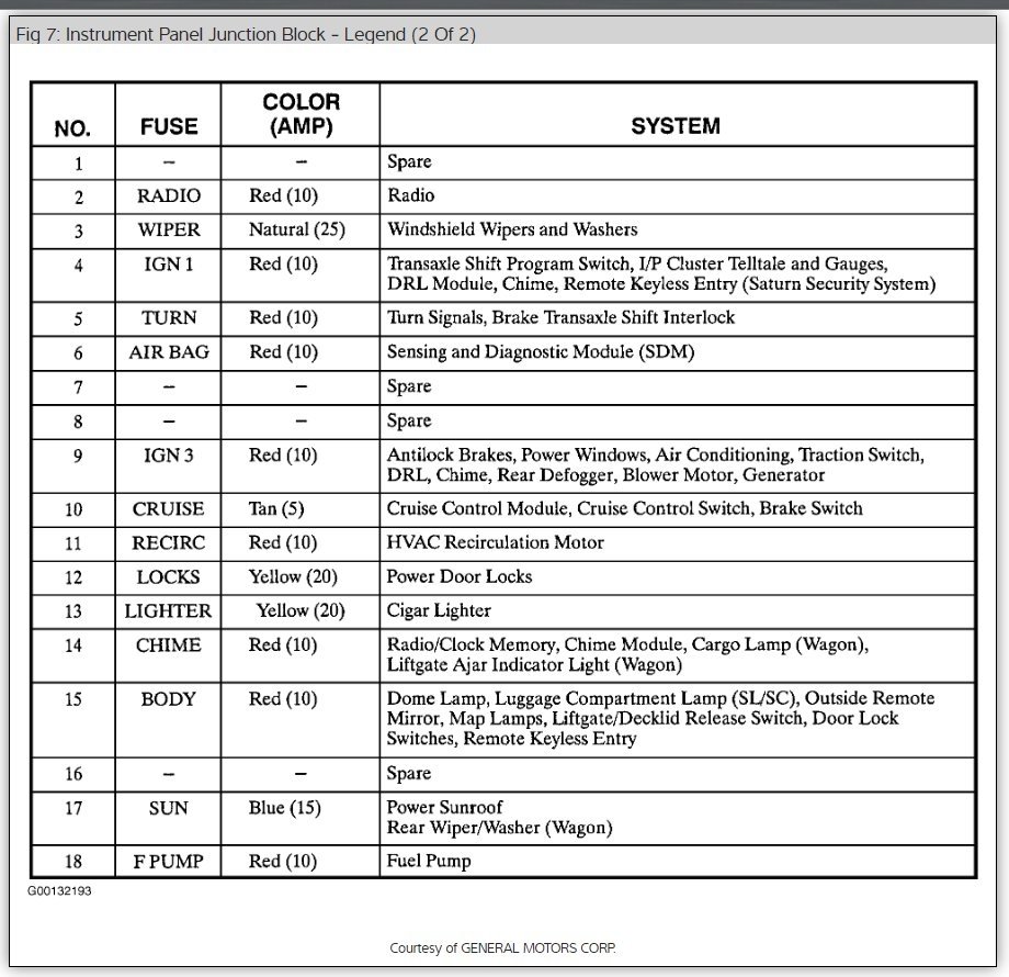

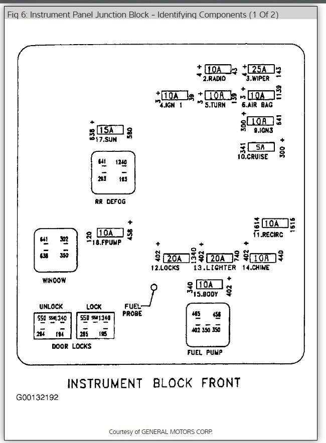

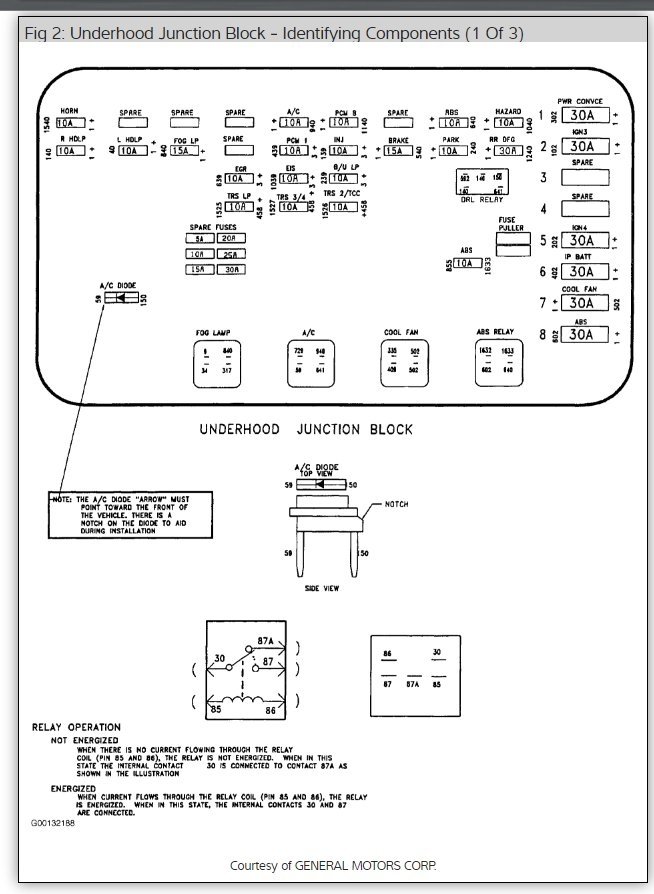

There is two fuses that must be checked, here is a wiring diagram and a fuse box diagram (below) that will help you do some checks.
and
Please run some tests and get back to us we are interested to see what it is.
