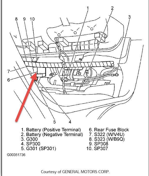

please forgive me if this is a repeat question; i was looking for a certain fuse under the back seat fuse box when the seat fell over and hit a relay and knocked it out and bent the pins . i replaced the relay, but now i have the following issues; no turn signals, service airbag(and red airbag light ), service electrical system and speedometer that reads zero at any speed. no fuses blown and just not sure what to check next.Thanks for your help!

when you dropped the seat you may have caused some fuses in rear fuse block to blow. the one in the trunk check all of those your turn signal fuses are located there.
