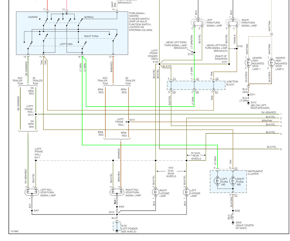

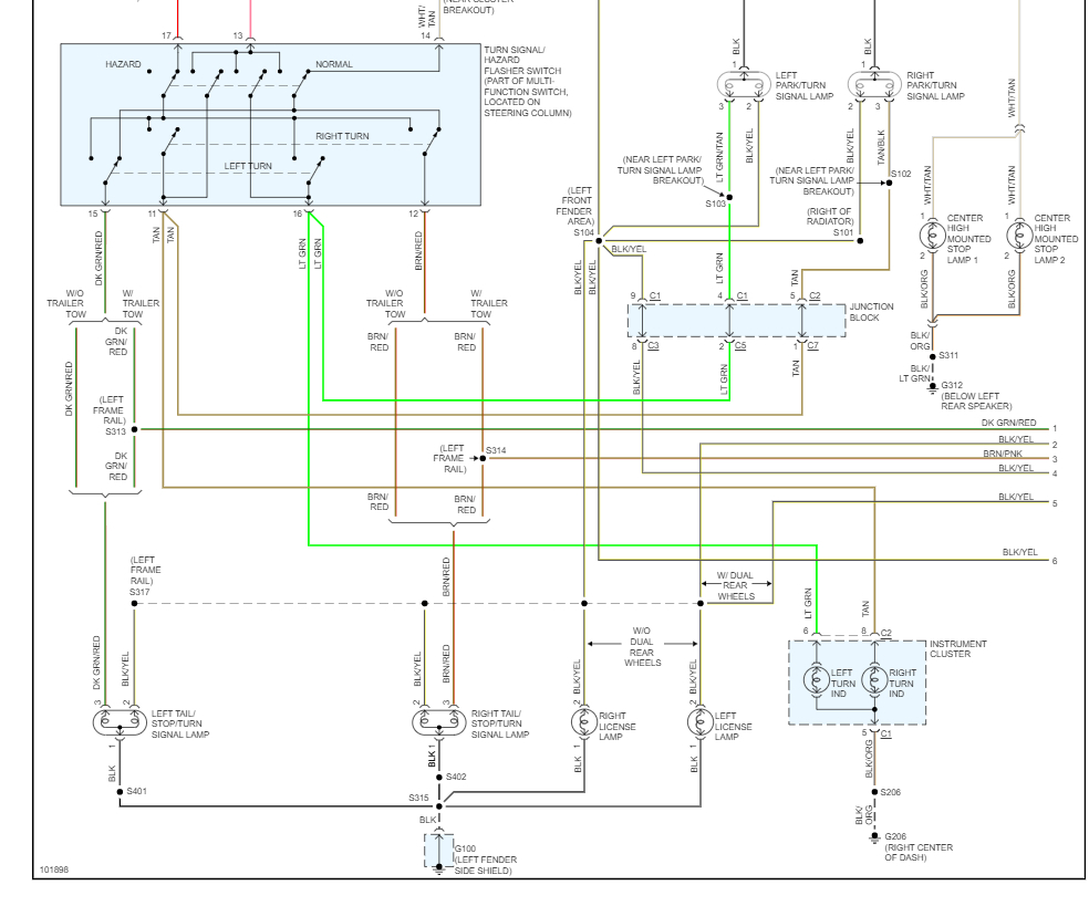

Park light circuit is not working?
140 MILES • 5.2L • V8 • 2WD • AUTOMATIC
GAPWELDER22
Feb 9, 2023 at 12:17 PM
  • 55,710 POSTS

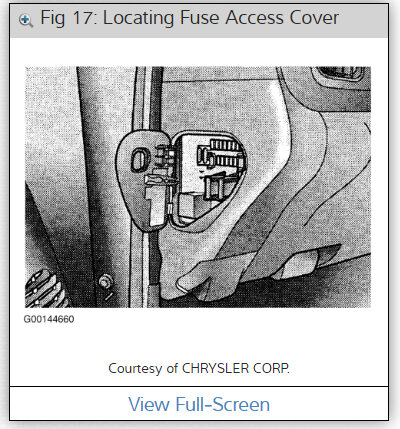

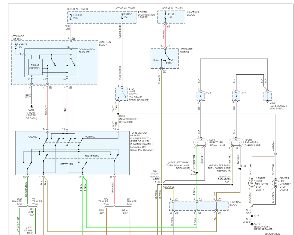

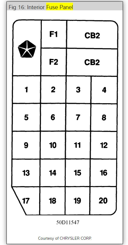

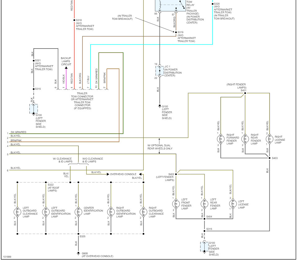

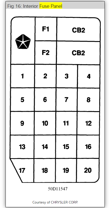

Please check the fuse #1 in the interior fuse panel could be bad. here is a guide to help and the fuse locations as well in the images below. also, I have included the parking light wiring diagrams so you can see how the system works.
Check out the images (below). Please let us know what you find. We are interested to see what it is.
