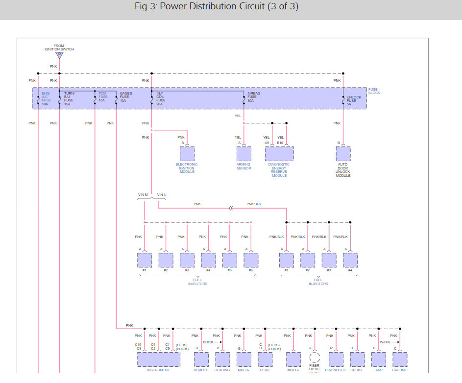

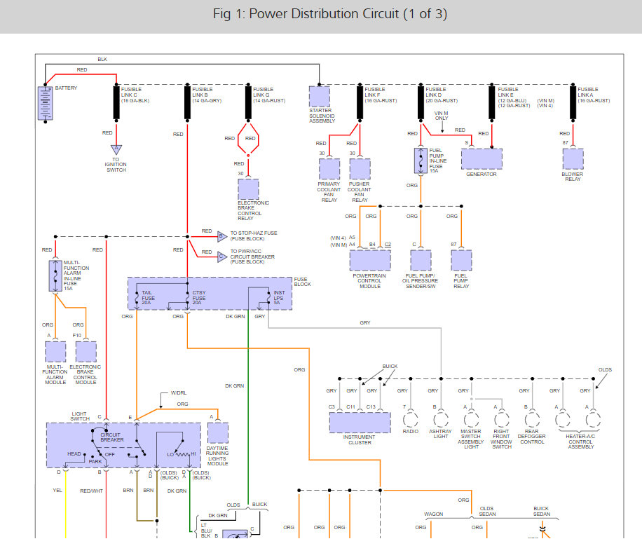

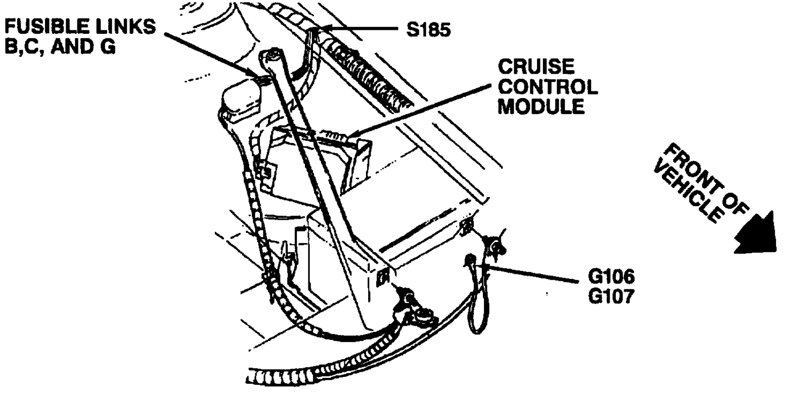

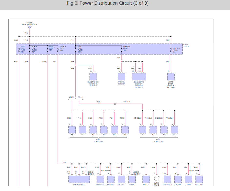

Need wiring diagram for the car listed above because various systems are not completely working. Issues w headlights, park lights, cig lighter, radio, etc.
Aug 26, 2022 at 4:45 PM
  • 55,721 POSTS

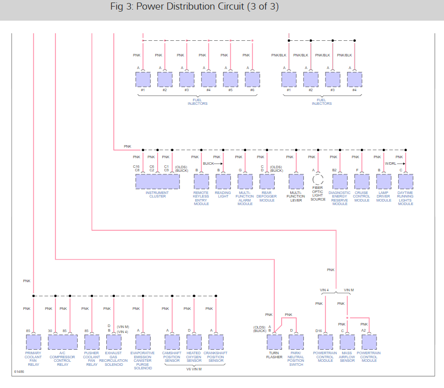

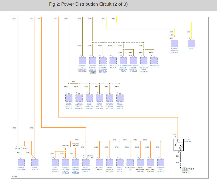

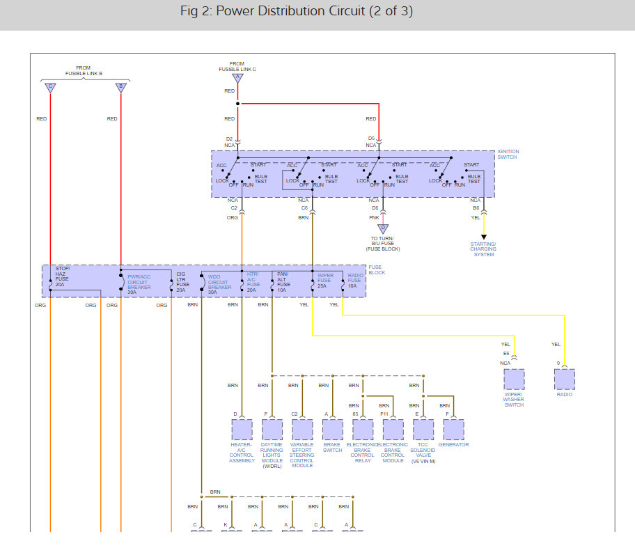

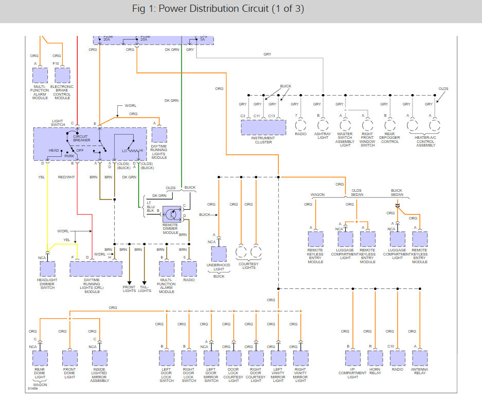

It sounds like the fusible link #b is out, have you checked the fuses? This guide can help and show you how to check for power. I have also included the power distribution wiring diagrams so you can see how the power system works.
