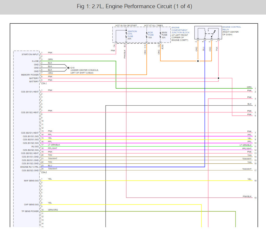

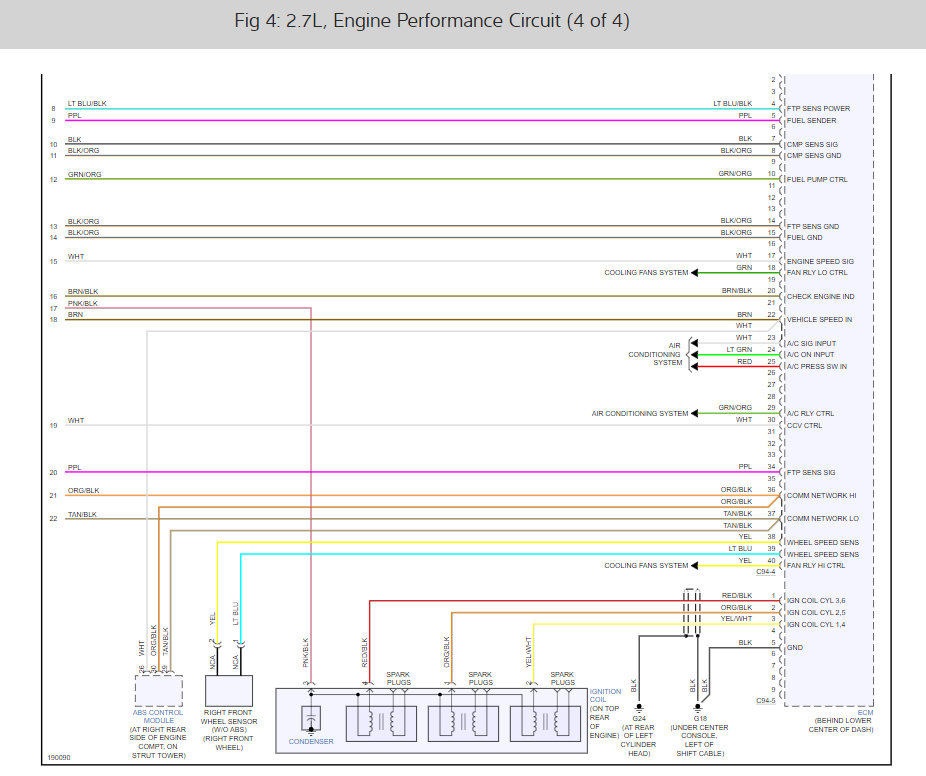

Need a diagram of coil pack. my connector crumbled to pieces. what wire goes where?
Jun 10, 2020 at 1:51 PM
Experienced Mechanic
55,732 POSTS
Here is a guide to help you check the wiring and the full engine wiring diagrams below:
Images (Click to enlarge)
