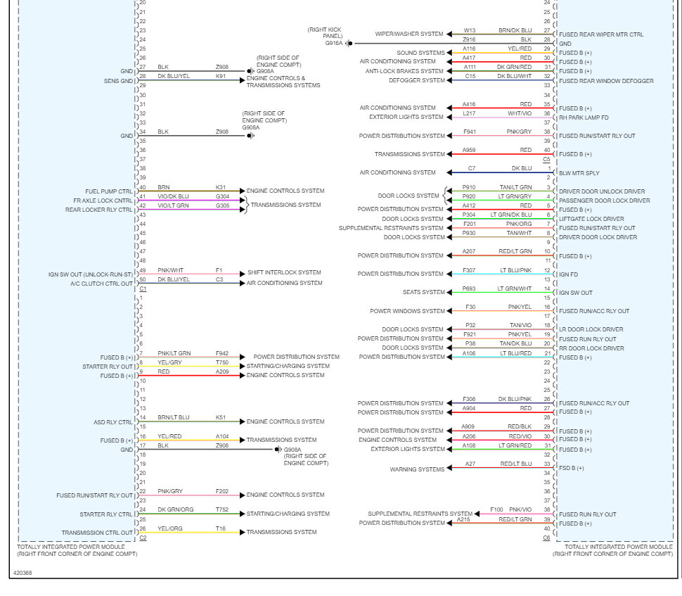

I'll start by describing the issue. I have a 2014 Jeep JKU Sport. Two times in the last month or so we were driving the vehicle, parked it, and then when we jumped back in to leave the store, the vehicle would not start. We get a lot of DTC's so it's hard to determine the cause. We get a HOTOIL flashing on the dash and sometimes the lock/unlock from the fob stops working. The first time it happened, the vehicle was left for a few days with the battery unplugged, and then it started up, we connected our scan tool, erased the codes, and all seemed well but we did not know the cause. The second time, I could not get the scan tool to connect and disconnect the battery for a short amount of time, 15 minutes or so, did not help. Ultimately, I followed procedures to reset the TCM manually. That got the vehicle to start and then we drove it home but with a lot of error codes and HOTOIL flashing. Once home, I unplugged the battery for a couple of days, then the vehicle started up and I was able to erase the codes, and the vehicle seemed fine again. I do not think the HOTOIL message is accurate since i got it even after the vehicle sat overnight the first night. I have checked the battery and alternator with a load tester, and they passed, although the battery is slightly bloated. I have checked all of the fuses and relays in the fuse box and the only thing of note is the starter relay has some extra resistance across the load circuit when energized, but that does not seem to be affecting the starting since i was able to erase the codes.

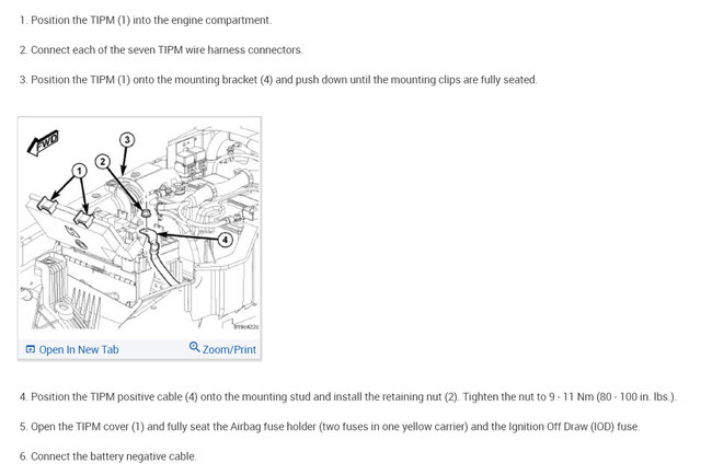

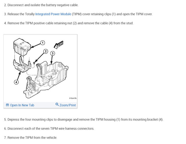

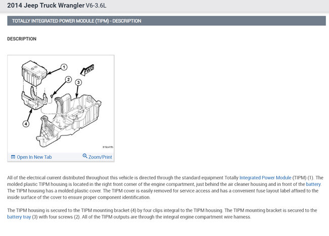

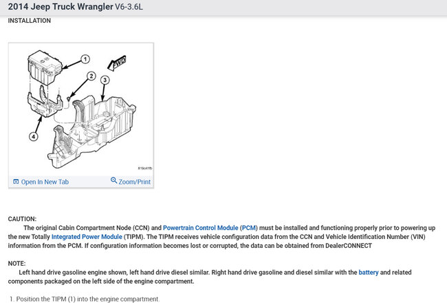

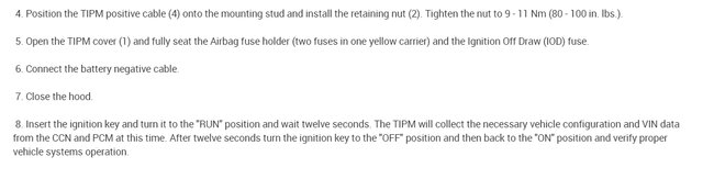

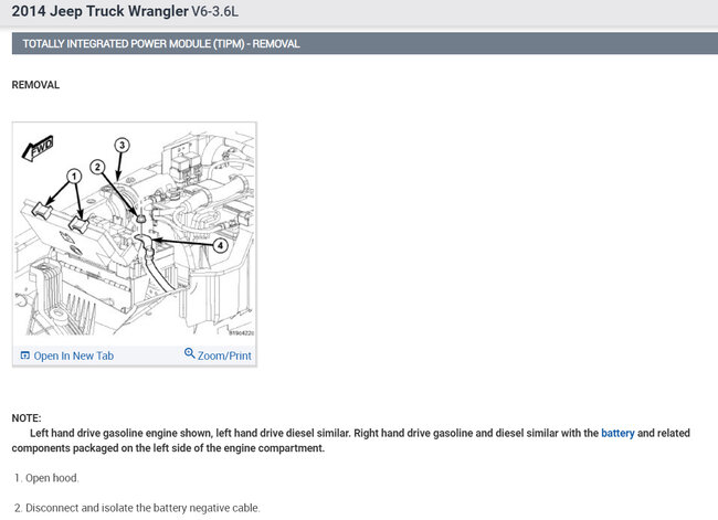

It sounds like the TIPM module is out which a CAN scan can confirm which is common on these cars. It is easy to replace because it-self learns, and no programming is required. Here is the location and how to change it out in case you need it. Check out the images (below). Please let us know if you need anything else to get the problem fixed.

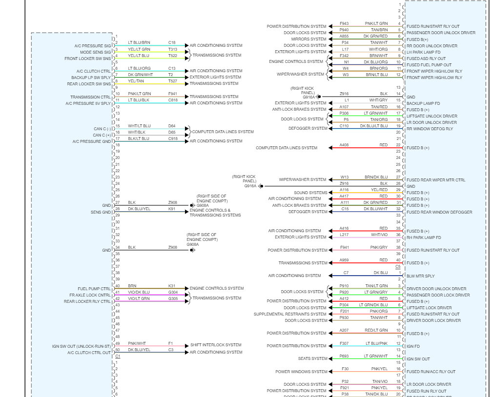

Yep, I like your style, I do believe the TIPM is out looking at the codes that are begin outputted. Unfortunately testing the TIPM is difficult especially when the problem is intermittent. I can tell you they had big problem with the TIPM, and they go out frequently.

I pulled the TIPM and sent it in for diagnosis. It passed all of the tests and is operating as expected.

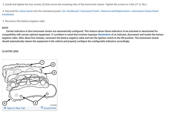

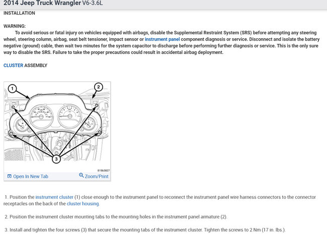

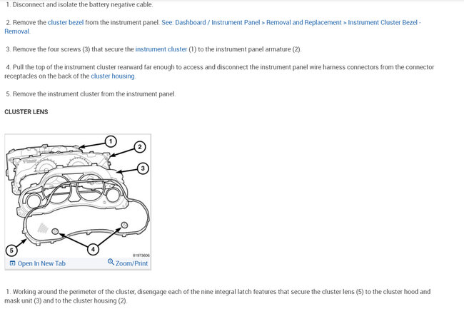

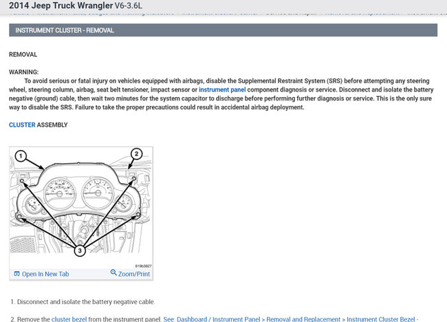

The next part I would have tested is the instrument cluster. Also have you tested all of the fuses with the system on? Here is how to remove the cluster. Check out the images (below). Please let us know what happens.
Apr 24, 2023 at 4:50 AM
BEAMZ
  • 34 POSTS
I ran the gauge cluster self test and did not get any error messages. What would I look for if I took it out entirely?
Apr 30, 2023 at 12:49 PM
  • 55,770 POSTS

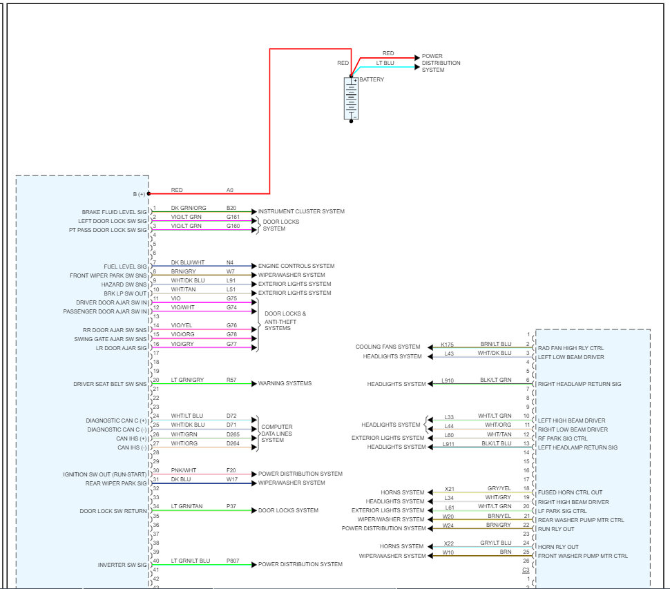

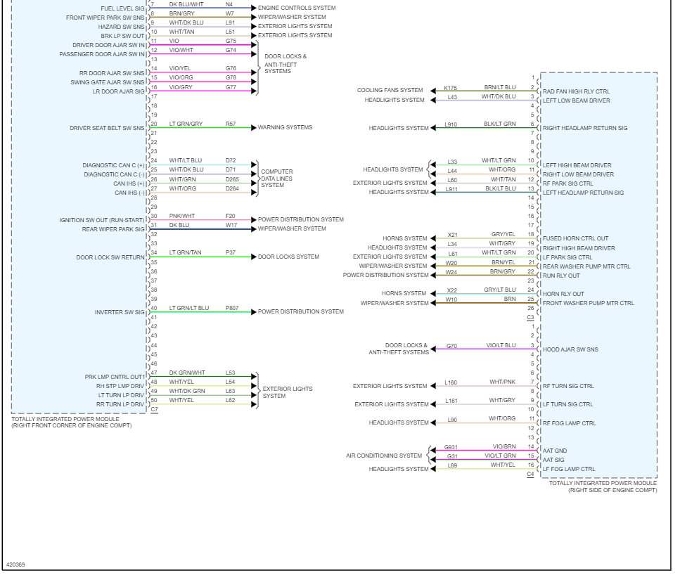

U0141 - Lost communication with IPM (FCM/TIPM) is the concerning code. How was the TIPM tested? It still sounds like it is bad. I would test the power and ground circuits to the TIPM. Here is a guide to help with the test and the TIPM wiring diagrams so you can see which wires are power or ground:

Okay, let's try to narrow this problem down, clean all codes and then without starting the engine turn the system on (key on) and then run the codes (CAN scan). BTW the TIPM is the only thing that supplies power to the other computers and modules.
