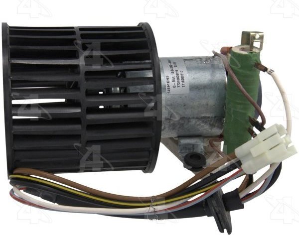

my name is Bill and I have a Rabbit that I am having an issue with. The blower motor, where is the resistor? The body shop cannot locate it and the motor only runs when the switch is in the off position. Any help would be greatly appreciated. If you have a contact number that I could give to the body shop that would be cool. Thanks, Bill

It is mounted on the blower motor itself. It is the green item in the picture.
