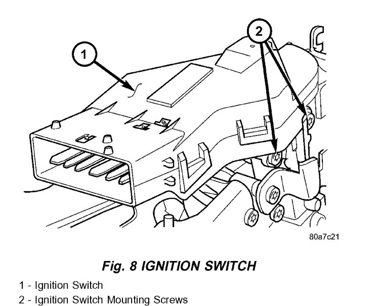

Ok so I replaced the transmission and shortly after that my engine would intermittently stall.the problem gradually got worse with failing gauges and then no start unless the gauges were working until eventually they no longer would work either.replaced the ecu had it programmed at the dealership. But still no horn no wipers NO LIGHTS WHATSO EVER FLASHERS INCLUDED.alternator doesn't charge either the.only light is have is the 3rd brake light that's it .also the dash lights come on when the key is turned on even when they are supposed to be off and my truck is also misfiring on a cylinder or two .the crazy thing is on the way to the dealership for the programming it all of a sudden the engine ran like it was supposed to no misfire running great .until I get there turned it off and when I started it again back to the same things.. IVE CHAMGED THE FCM AS WELL AND STILL NO LIGHTS NO NO THING THE ONLY THING THAY IT DID DO WHEN I HAD THE ECU PROGRAMMD WAS TURN THE NOISY DINGING OFF. EVERYTHING ELSE IS STILL AS IT WAS.Help!!!

O yes, the classic ignition switch problem, this is common when the ignition switch goes out, I would replaced it with a new unit which should fix the problem. The switch is inside the column. Check out the images (below). Let us know how it goes, Ken

This sounds like an Ai answer, the ignition switch can definitely cause the engine to shut down along with the other electrical problems you mentioned at the same time. The connections inside heat up and fail. When the issue happens feel the switch to see if it is warm. This is a sign of failure.
