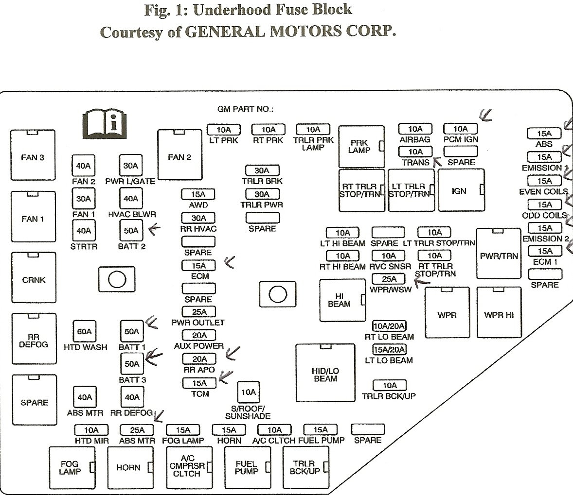

MBFOR99
  • 46 POSTS
Okay, so, I actually have fire at that fuse and wire, but the light on the test light was very dim, so I'm thinking maybe I have a break somewhere in that wire is why I'm not getting any power to the vehicle at all. does it have a main fuse or fuses I can check?
Sep 16, 2022 at 11:16 AM

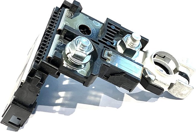

MIKE H R
  • 3,094 POSTS
There is a fusible link connected to the battery. check it for a bad fuse connection.
