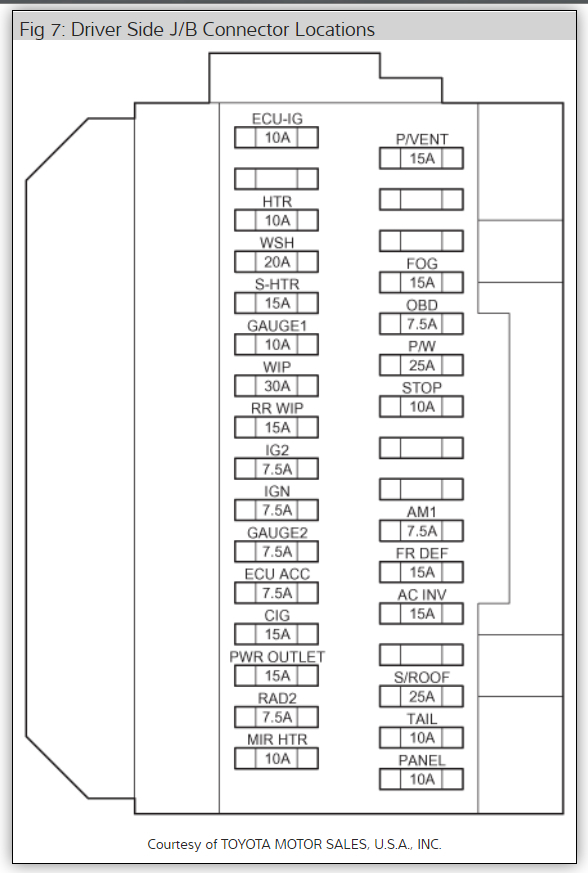

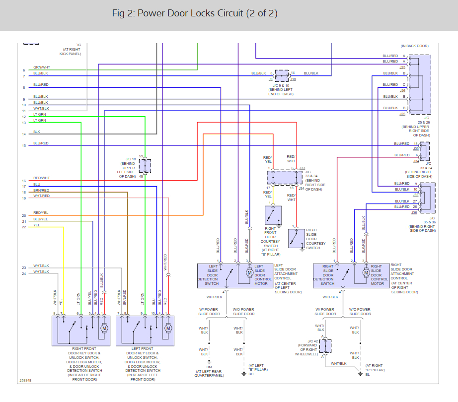

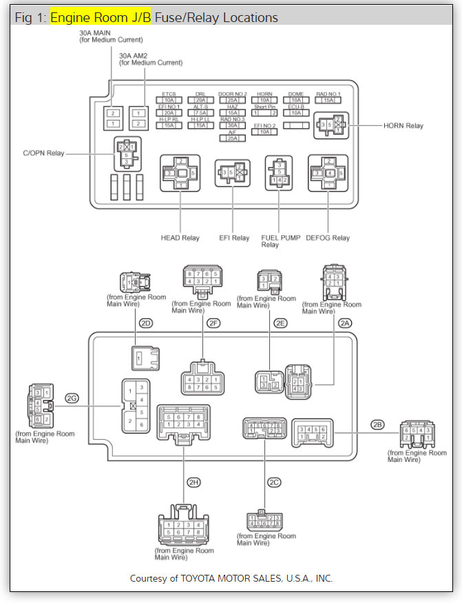

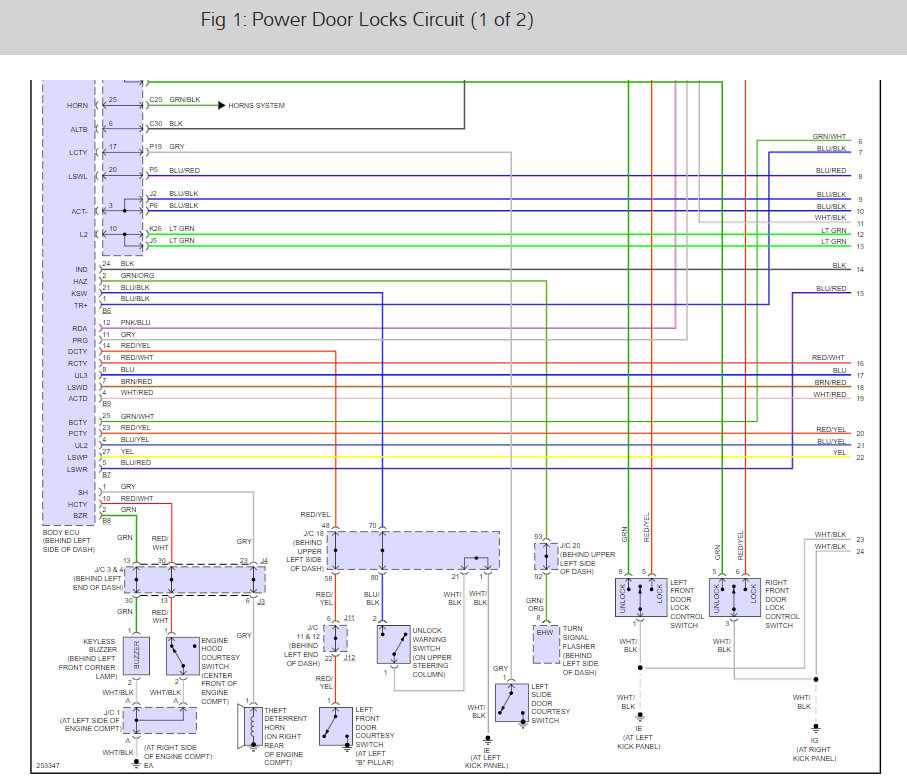

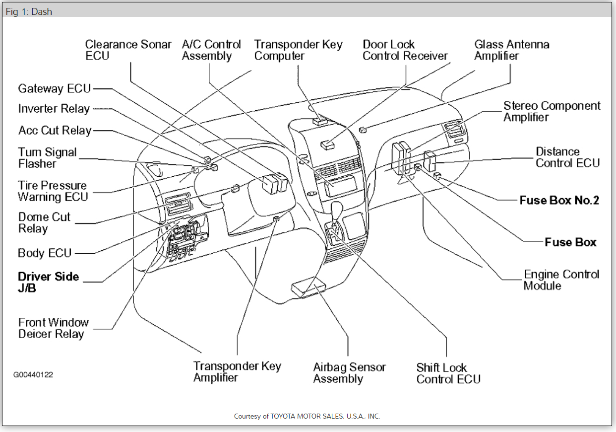

Both front doors will not lock with the switches or the remote. Also clock is not keeping the right time.
Dec 17, 2018 at 12:17 AM
  • 55,399 POSTS

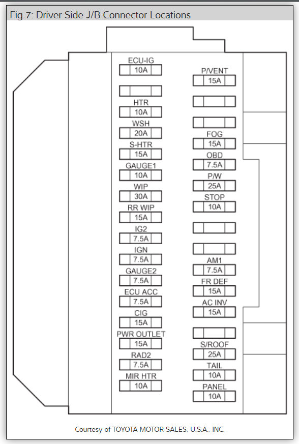

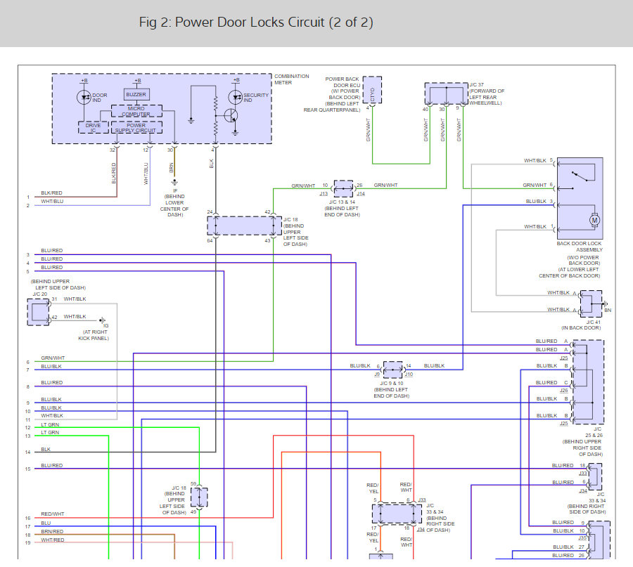

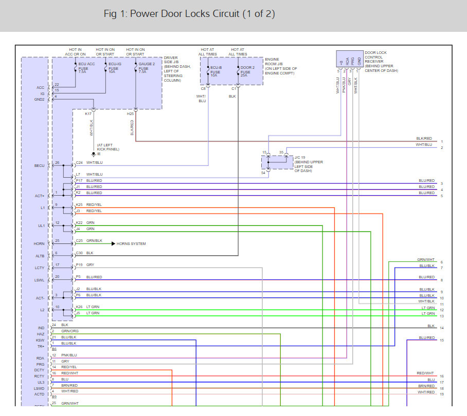

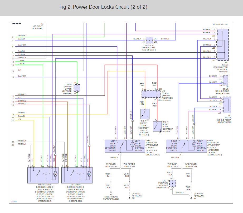

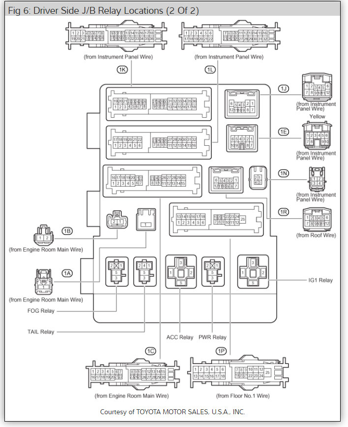

We first should look at the fuses that run the system which are ECU ACC, ECU IG, Gauge 2, ECU B, and Door 2. Here is a guide to help walk us through the test and the fuse locations ans well as the door lock wiring diagrams so you can see how it works:
