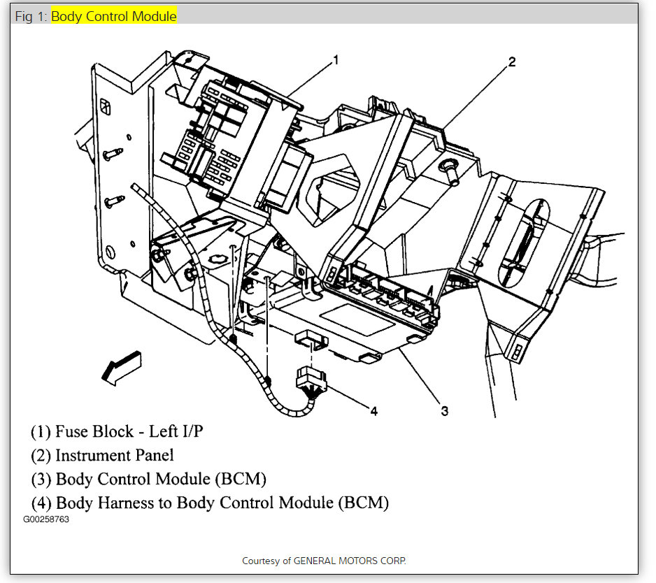

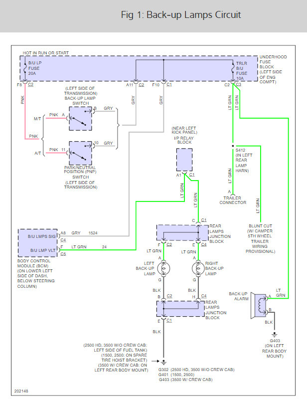

While in drive the reverse lights are still on & stay on most the time. Also every time I make a right turn, my brights come on when I hit the right blinker on.
Oct 27, 2018 at 6:22 PM
  • 55,721 POSTS
This sounds like a BCM problem which tries these systems together. Here is the location of the unit and how the reverse lights are wired so you can see how they work. I would try a used one and plug it in, you may need to get it programmed to the truck it should cost about $120.00.
