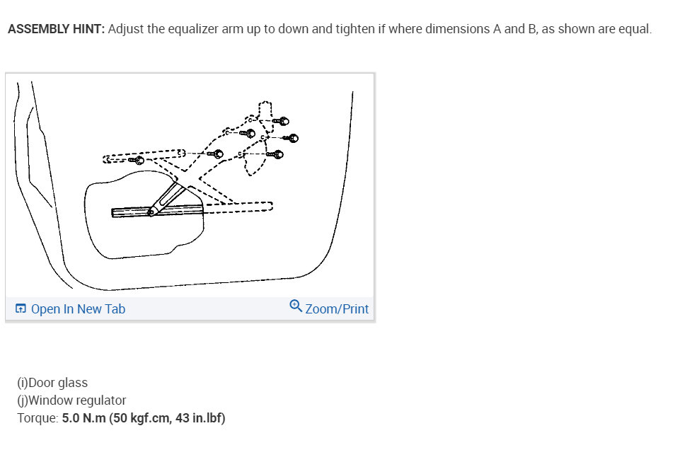

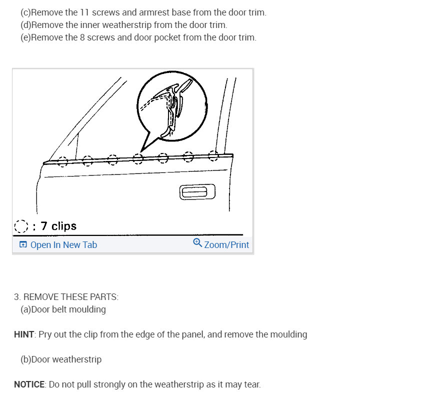

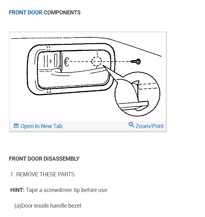

The window lifts slowly and then stops?
500,000 MILES
LEONID GELBAK
Window not operating properly.
Aug 10, 2022 at 9:22 AM
  • 55,561 POSTS

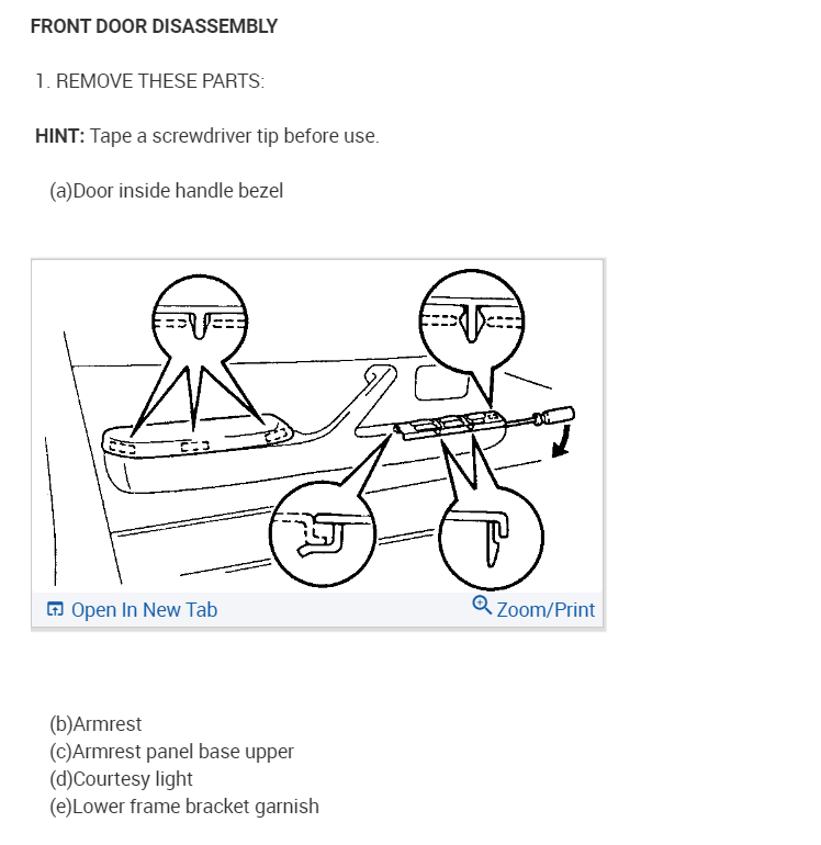

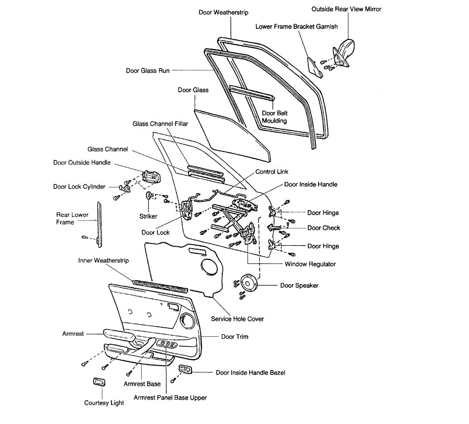

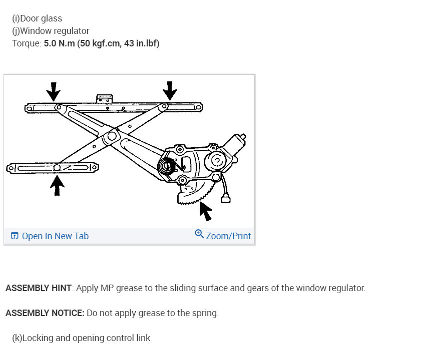

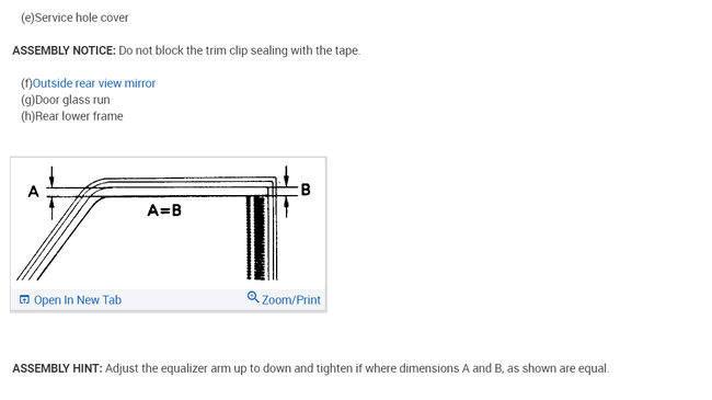

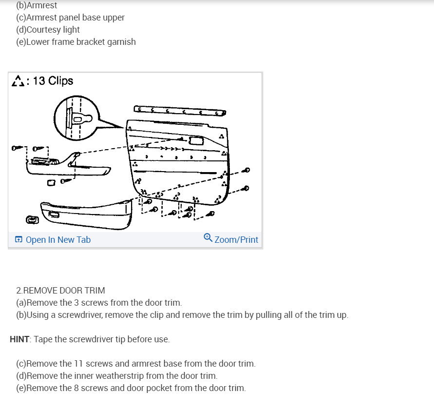

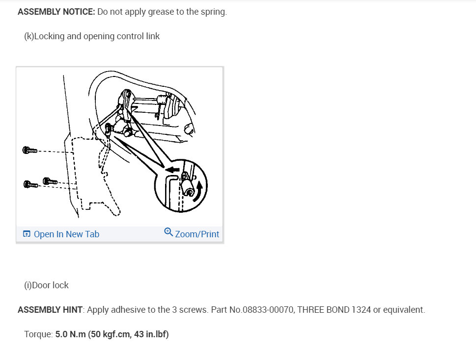

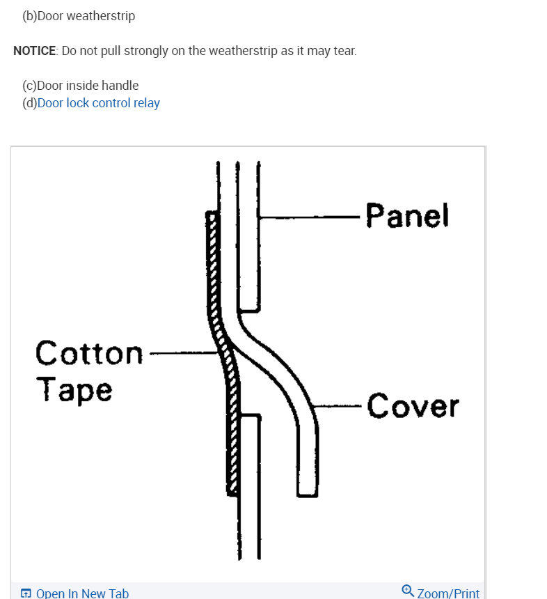

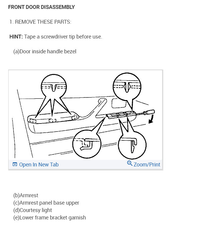

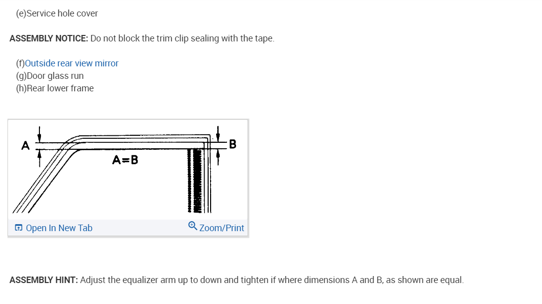

This happens when the window motor gets weak, or the window track gets full of dirt. Here is how you can remove the door panel and window motor and regulator so you can clean the track or replace the motor/regulator you can find a new one on eBay. Check out the diagrams (below). Please let us know what happens.
