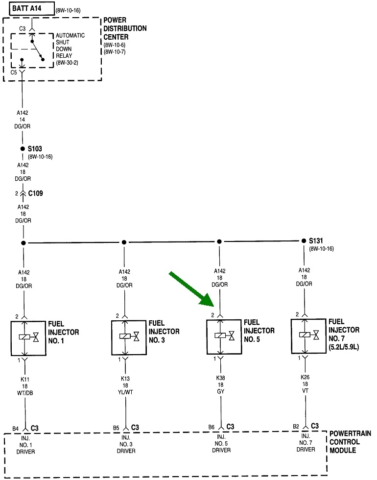

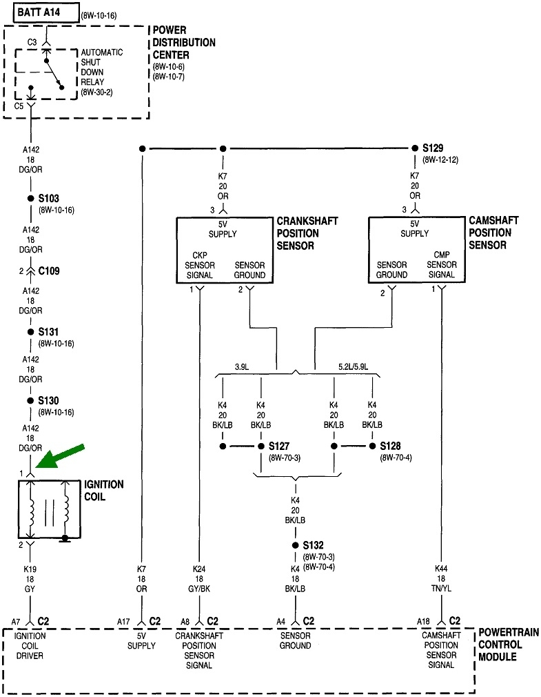

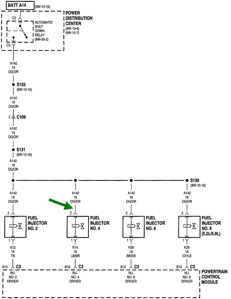

If you find a fault code related to the crankshaft position sensor or the camshaft position sensor, we need to look there first. Otherwise, the place to start is by determining if the automatic shutdown, (ASD) relay is turning on. A test light works best for this, but you can use a digital voltmeter too. Here's links to some related articles, if it will help:
Look for the wire that is the same color at the ignition coil, every injector, or either smaller terminal on the back of the alternator. That is usually a dark green / orange wire as shown in these diagrams. Back-probe through the rubber weather seal, then have a helper run the ignition switch. Proper operation is the test light, (ASD relay), will turn on for one second when the ignition switch is turned to "run", then it will turn off. What is important is they must turn on again once the engine is rotating, (cranking or running). If they do turn back on during cranking, we'll have to look for a problem in the ignition system or the fuel pump system, but not both. Those are by far the two least common failures.
It's much more common to have a loss of spark, injector pulses, and fuel pump all at the same time. That's where the ASD relay isn't turning back on, and that's almost always due to a problem with the crankshaft position sensor circuit or the camshaft position sensor circuit.
