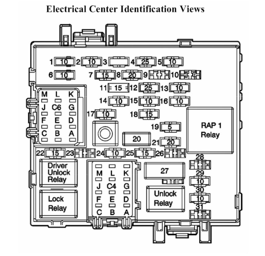

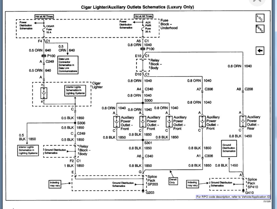

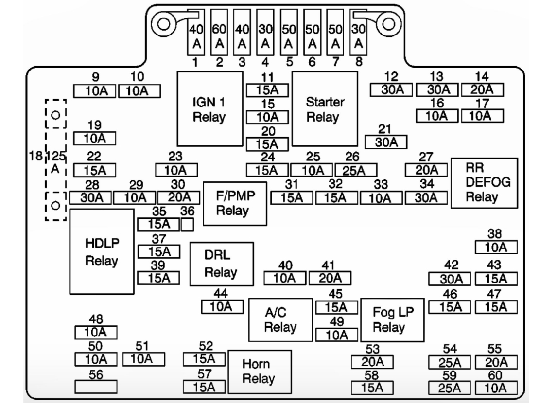

Wires from the cigarette lighter going into the engine melted causing the battery to lose power. also the truck turns on but it won't stay on. is there a relay or switch or fuse it could be burned out to cause this issue? thanks
Jan 18, 2021 at 9:49 AM
We need to try and scan for codes. There could be a number of reasons for this but just a burned wire for the lighter would not cause the engine to stall. However, other burned wires would cause something like this so we need to start with this.

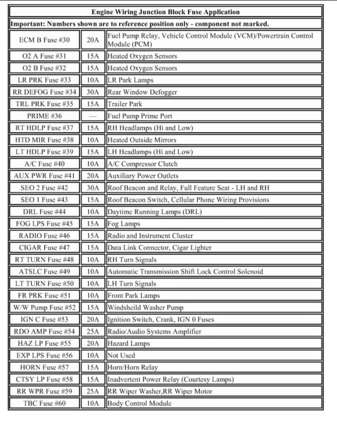

Once we know what codes are there then we can get a better course of action. If you are not able to read codes, then you need to check the cigar fuse shown below. This is the fuse for the DLC as well.
Let's start with this and go from there. Thanks
Jan 19, 2021 at 10:19 AM
  • 55,433 POSTS

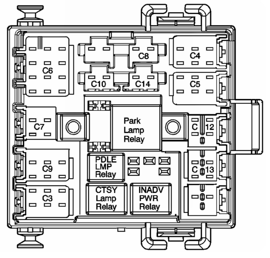

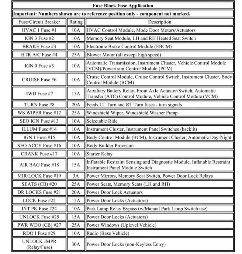

I have seen this before. The fuse inside the fuse panel melts together causing an electrical short. Can you please inspect the fuse and has the issue been corrected and now the engine will not idle? There is a RAP1 fuse we need to check for power. this guide can help us with the fuse location in the diagrams below:

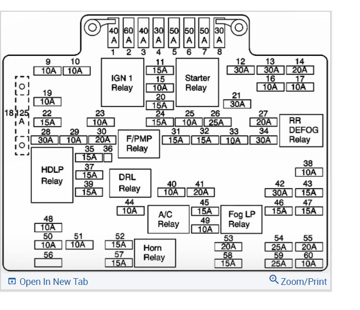

Electrical problem

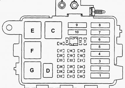

1995 Chevy Suburban Two Wheel Drive Automatic 250,00 miles
Dear Sir:
Thank you for your quick response to my question yesterday, and for your service to our Country.
Is the ECM B fuse located in the fuse relay center, under the hood? Is it a yellow 50 amp?
Jan 20, 2021 at 11:26 AM (Merged)
MERLIN2021
  • 17,250 POSTS
It's yellow #17. Fuse & Relay Identification 1 - Spare 2 - STOP 30 Amp Maxifuse (Green): Stop Lamps 3 - A/C 50 Amp Maxifuse (Red): High Blower Relay, Rear Blower Relay 4 - ABS 60 Amp Maxifuse (Blue): ABS Module 5 - IGN B 50 Amp Maxifuse (Red): 50 Amp IGN B Switch, Go To Fuse Block Busbar 6 - IGN A 40 Amp Maxifuse (Amber): IGN A Switch, Go To Fuse Block Busbar 7 - BATTERY 50 Amp Maxifuse (Red): Battery, Fuse Block Busbar 8 - LIGHTING 50 Amp Maxifuse (Red): Headlamp & Panel Dimmer Switch, Fog Lights, Courtesy Lights 9 - 30 Amp (Green) 10 - 30 Amp (Green) 11 - 10 Amp (Red): Spare 12 - 20 Amp (Yellow): Spare 13 - 30 Amp (Green): Spare 14 - Not Used 15 - A/C COMP 10 Amp (Red): SW A/C Pressure to A/C Clutch 16 - HORN 20 Amp (Yellow): Horn, Underhood Lamps 17 - ECM B 20 Amp (Yellow): Fuel Pump, PCM 18 - Not Used 19 - AUX FAN 30 Amp (Green): Aux. Fan 20 - RR- DEFOG 30 Amp (Green): RR DEFOG 21 - ENG 120 Amp (Yellow): IGN A Switch to Engine Loads, EGR, Canister Purge EVRV Idle Coast Solenoid, Heated 02 Sensor, Fuel Heater, Water Sensor 22 - ECM 120 Amp (Yellow): Injector #1, Injector #2, PCM 23 - FUEL SOL 20 Amp (Yellow): Fuel Solenoid (Diesel Engine Only) 24 - Not Used 25 - Not Used 26 - IGN E 10 Amp (Red): Aux Fan Relay Coil, Hot Fuel Module 27 - Not Used 28 - Not Used 29 - GLOW PLUGS 10 Amp (Red): Glow Plugs (Diesel Engine Only) 30 - Not Used 31 - Not Used 32 - Not Used A - 30 Amp B - 30 Amp UY1, UY7 Camper/Trailer Wiring C - Brake Lamp Relay D - Horn Relay
