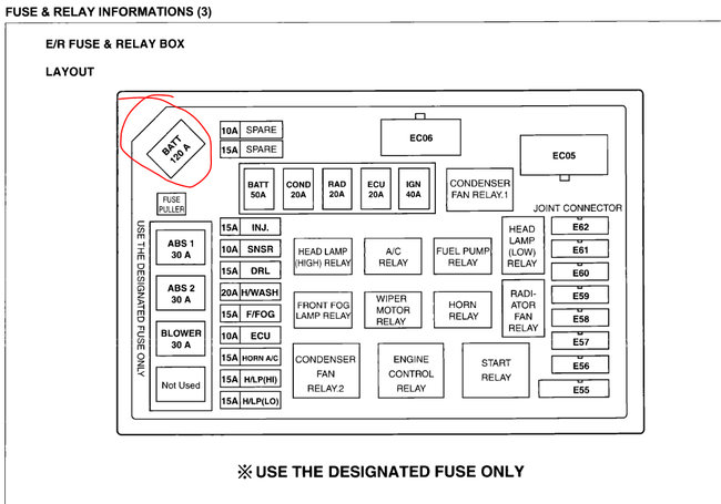

I have charged the battery and I am getting nothing in the car. I checked the ground cable and it’s tight but have a hard time getting to the starter. Is there anything else I can check?
Aug 16, 2021 at 5:33 AM
SQM
  • 6,383 POSTS
Just to clarify, after you put new battery in, you do not have any power inside the car? No dash light or radio?

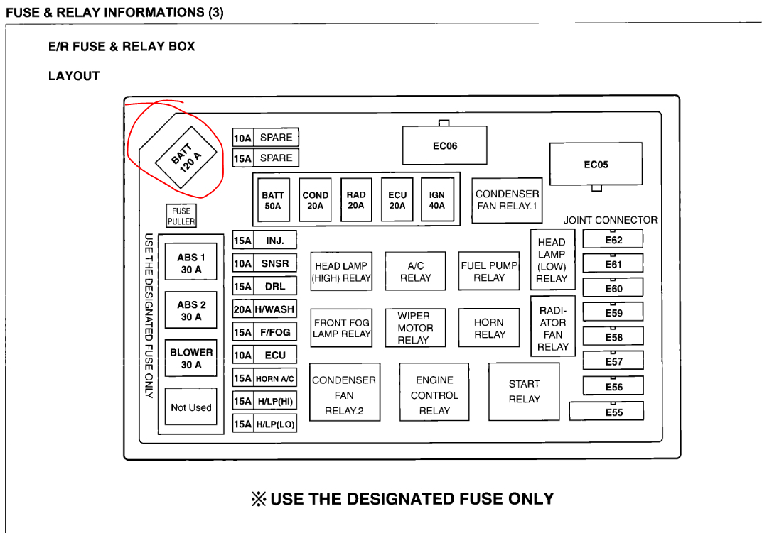

There is a 120A fuse in the fuse box under the hood (see diagram), check to see if that is blown. This is the main battery fuse.
https://youtu.be/Hlna_kUt7As
Let me know what you find.
