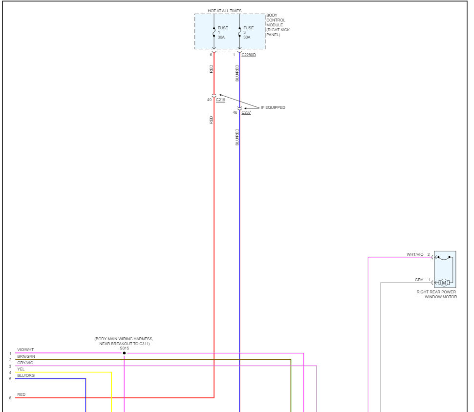

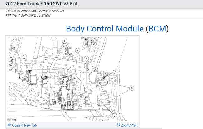

My truck I think has electrical Gremlins the power windows stopped working. I have power to regulator, but nothing. all 4 windows are in the up position. Prior to this I lost the radio and directional and the clock flashes once in a great. while I’m at a loss as to what’s happening, I’m also having intermittent drivability issues. any help would be greatly appreciated.
Apr 5, 2023 at 5:21 AM
  • 55,808 POSTS

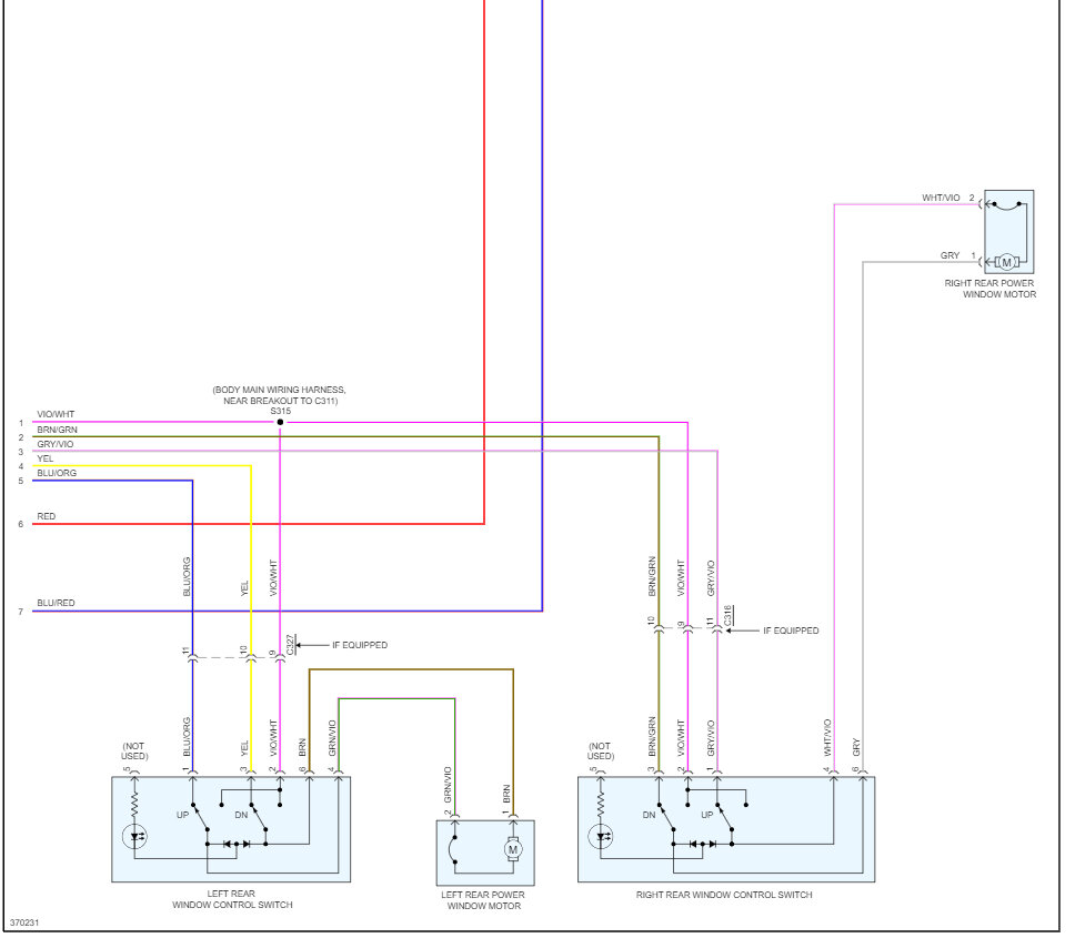

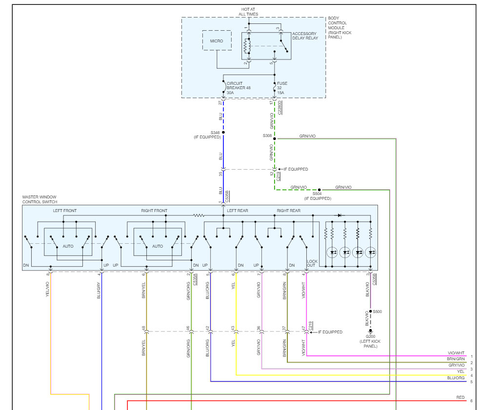

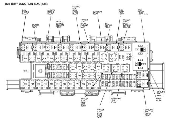

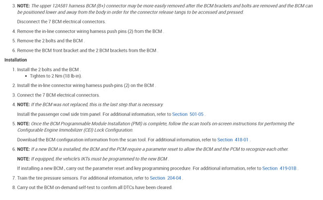

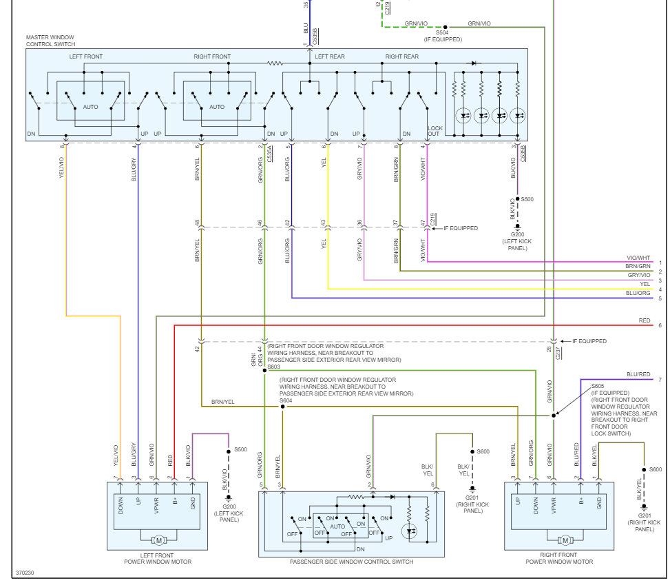

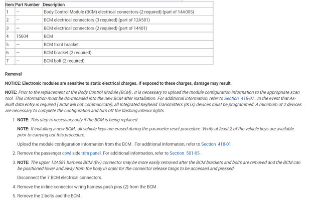

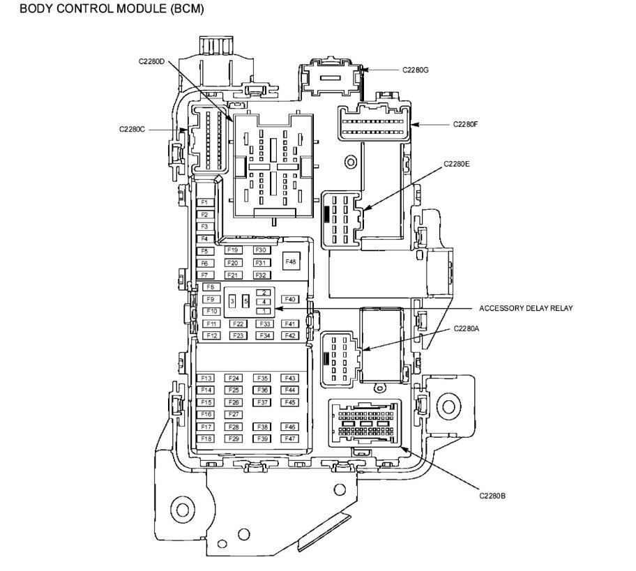

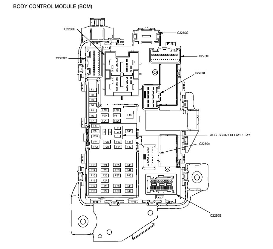

So, these systems are all tied into the body control module which might be out but to start we need to check the fuse. This guide will help.
I have included the fuse locations and you should check them with the system on. Also, I have included the window wiring diagrams so you can see how the system works and I have included how to change the BCM out in case you need it. You can get a preprogrammed unit by searching Google or Ebay.
