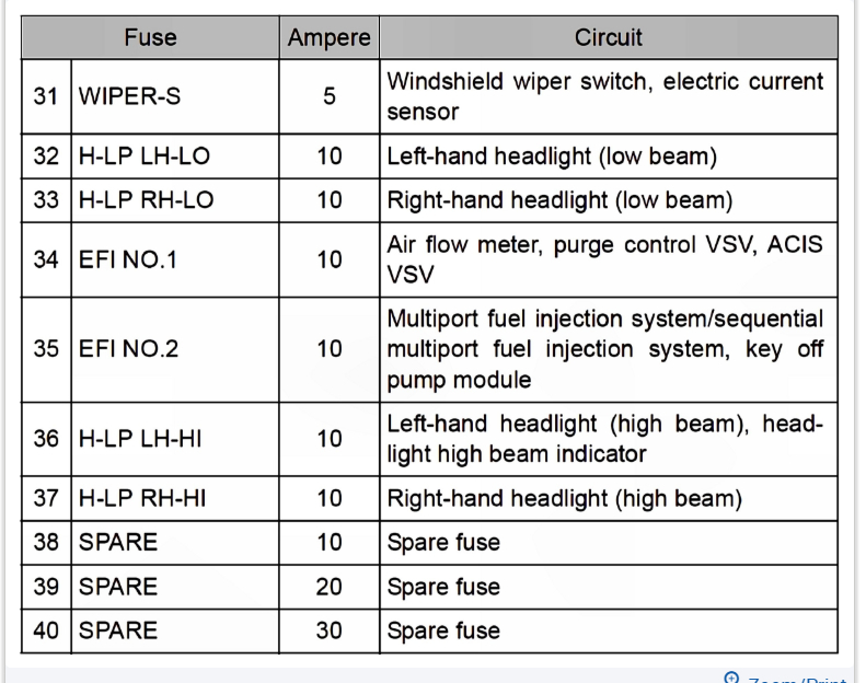

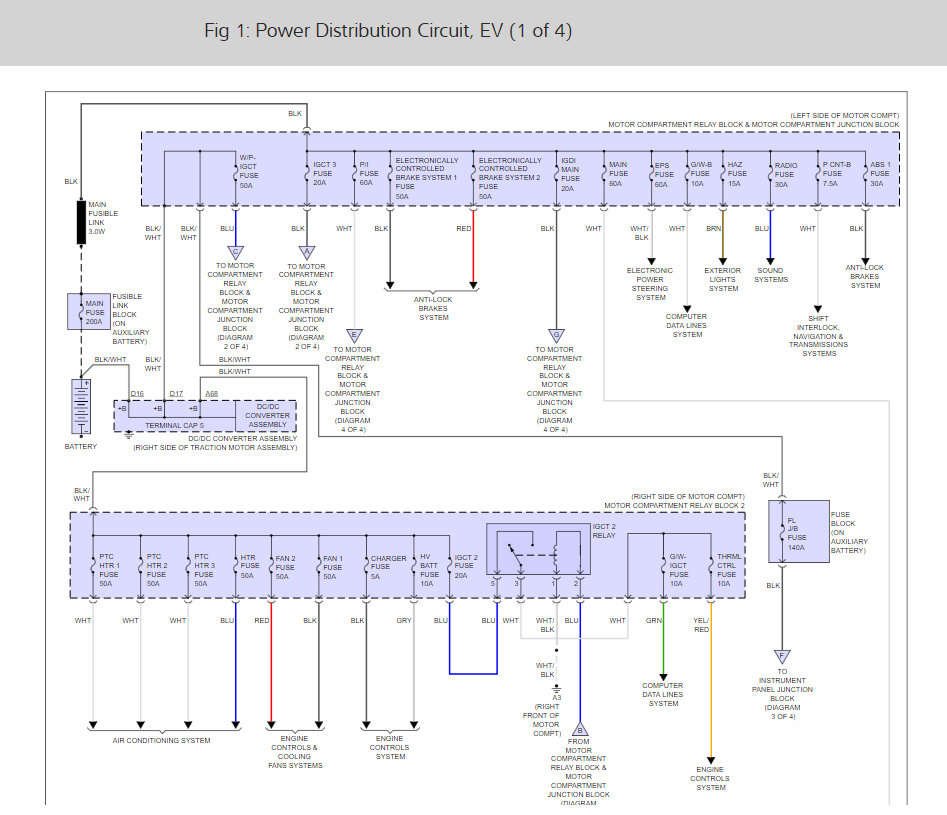

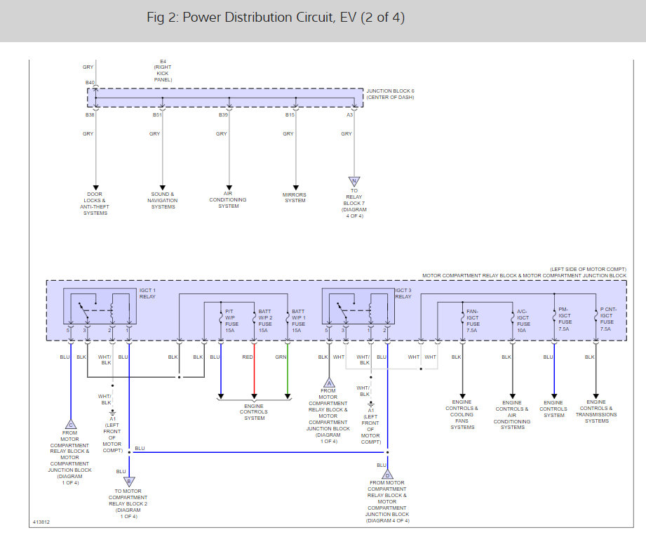

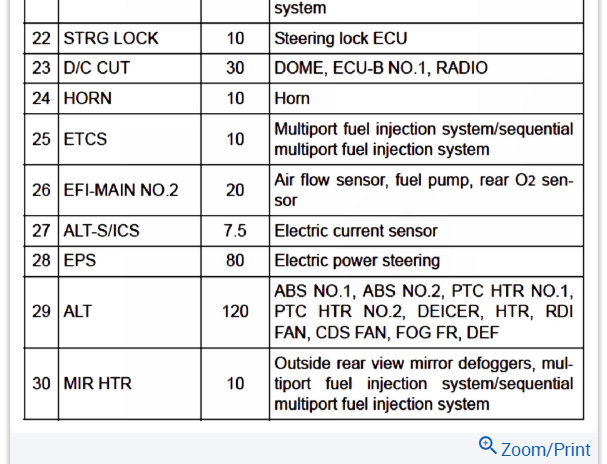

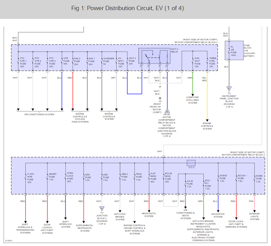

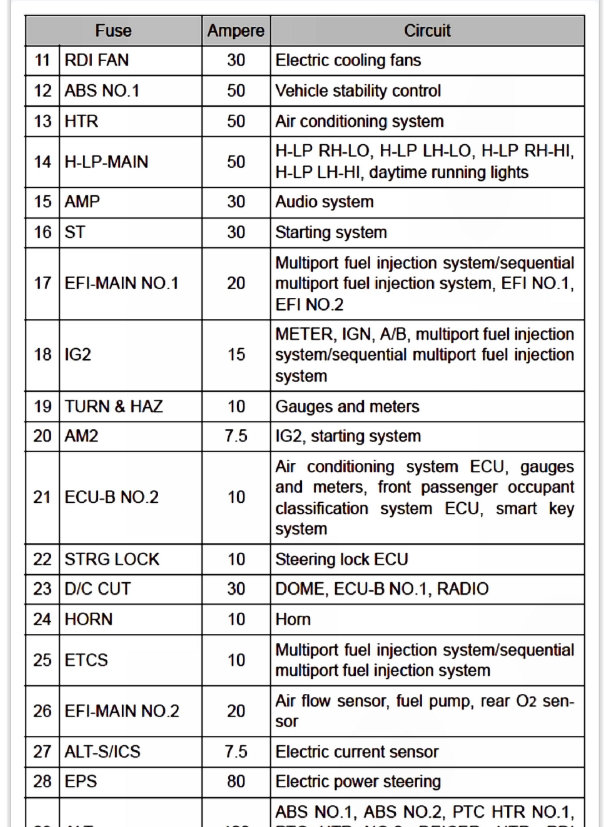

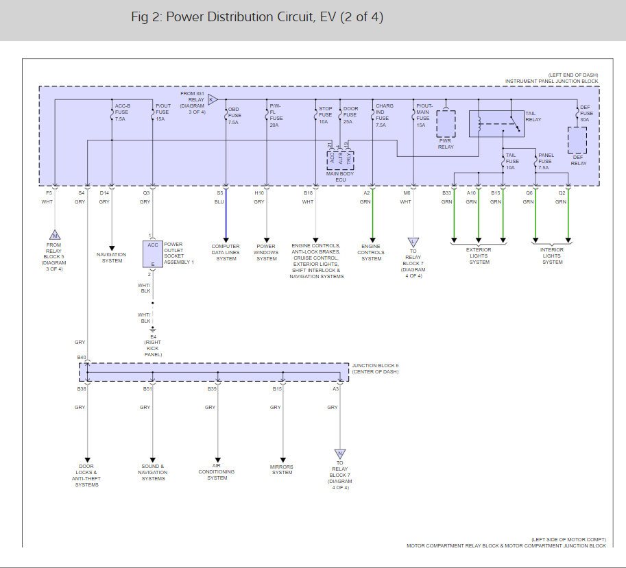

I have lost all electrical power and battery is good. I get no lights inside or out. No dash board lights and car will not turn on.
Jul 19, 2018 at 10:47 PM
  • 55,402 POSTS

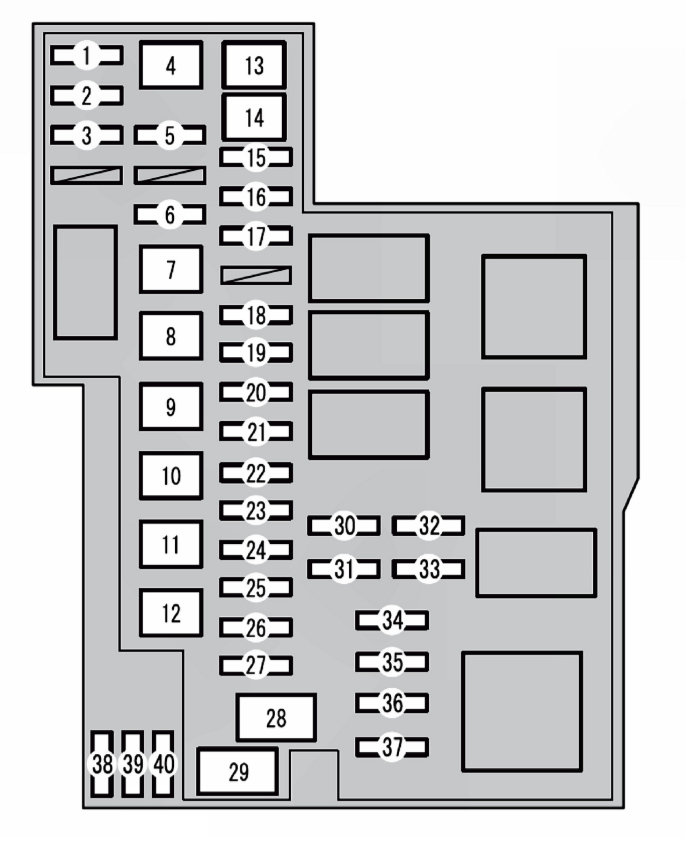

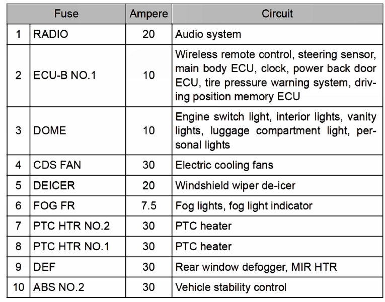

There is a fusible link and a main power fuse 200 amp lets start there. Here is how the power distribution is wired so you can see how it works let use a test light to see where the power drops off:
