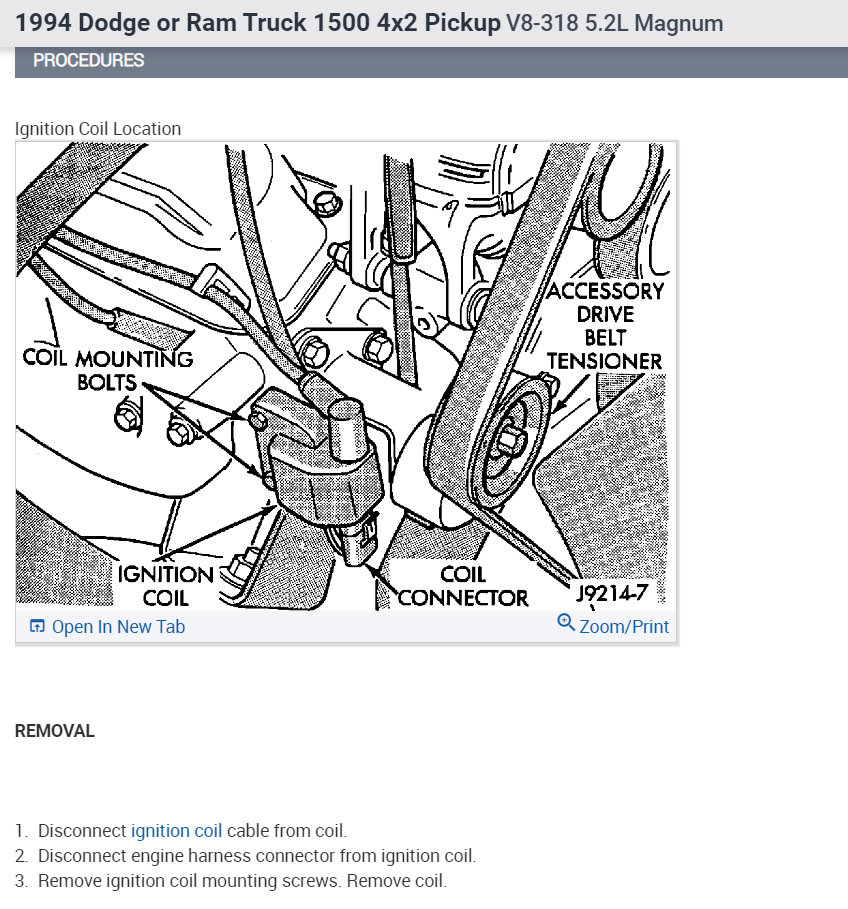

Engine cuts off. The coil wire to distributor is very hot?
223,000 MILES • 5.2L • V8
KANE1178
Engine cuts off. The coil wire to distributor is very hot. when cools off it will run.
Oct 7, 2017 at 1:35 AM
  • 55,766 POSTS
This happens when the coil is starting to short out and needs to be replaced, I have included instructions below to help you with the repair. Check out the diagrams (below). Please let us know if you need anything else to get the problem fixed.
