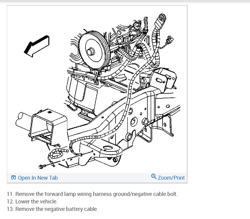

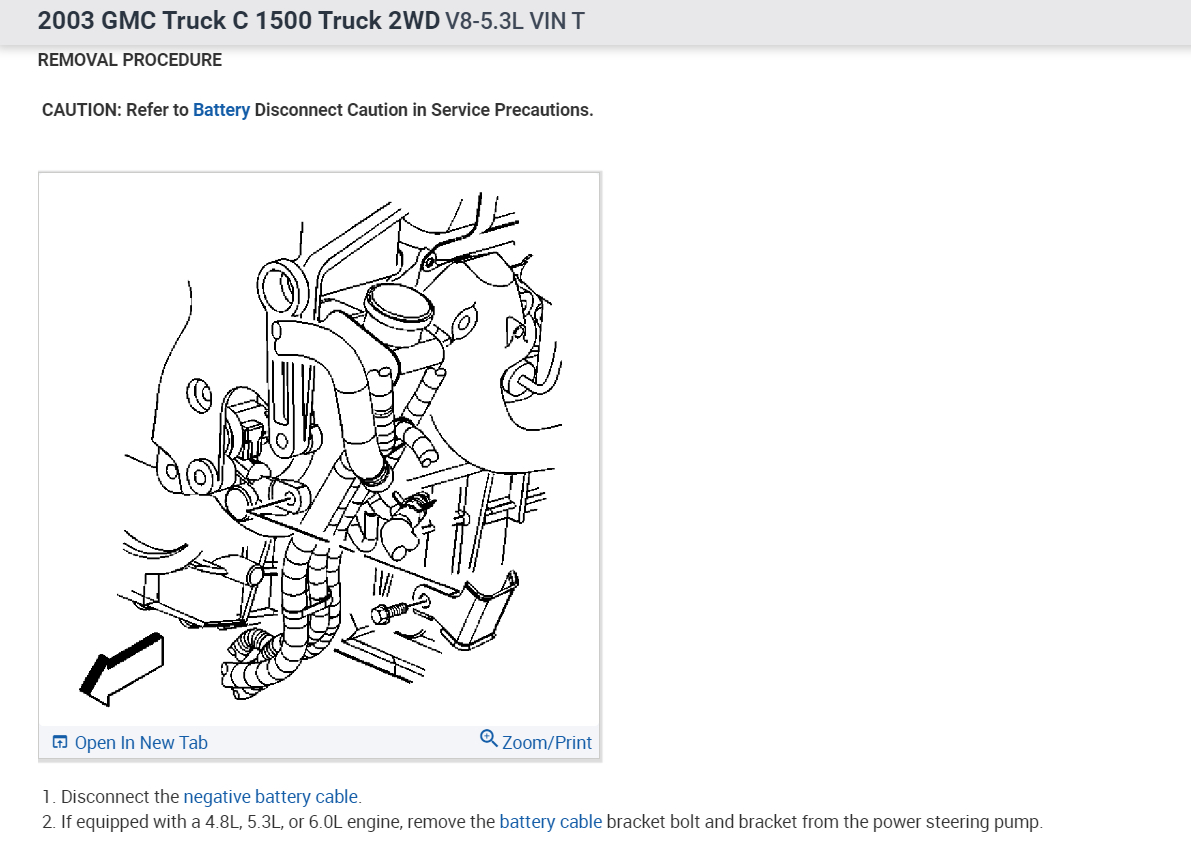

Just removed blown up 6.0l ls and replaced with a 5.3l ls from a 2007 Chevrolet Tahoe now engine wont crank, no spark or fuel pump. Used the original harness and computer.
May 2, 2023 at 11:01 AM
  • 55,456 POSTS

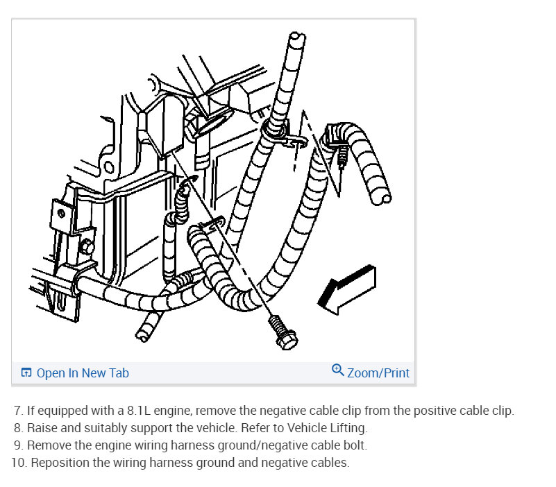

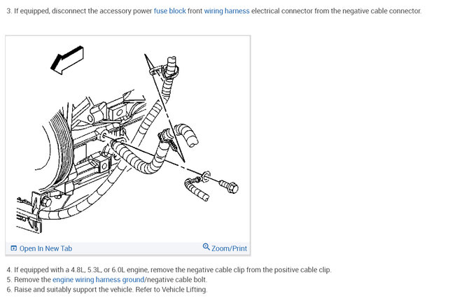

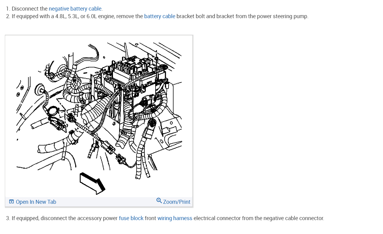

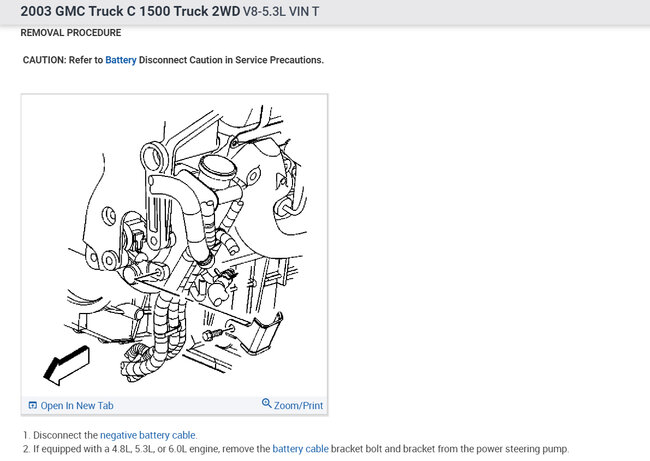

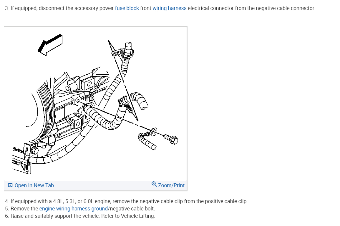

Please double check the main engine ground to the wiring harness, here is the location so you can see what I am talking about. Check out the images (below). Let us know what happens and please upload pictures or videos of the problem so we can see what's going on.
