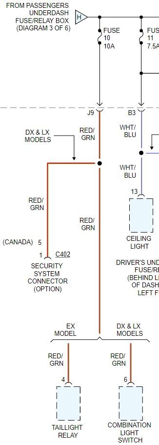

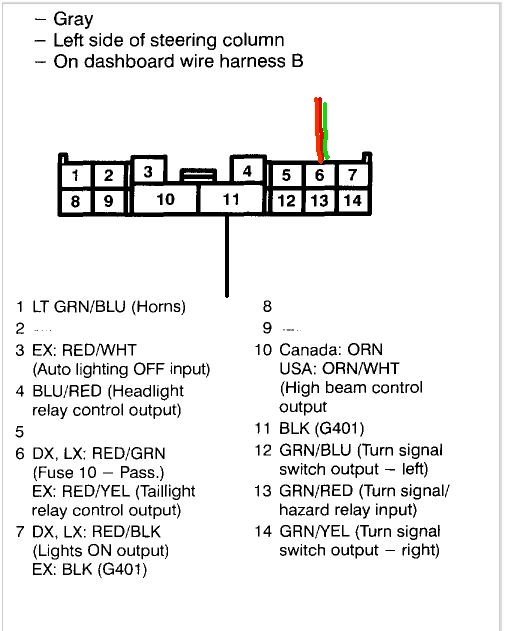

What is the oem wiring reader for the multiswitch to the dash fuse box?
Apr 25, 2021 at 2:03 AM
STEVE W.
  • 15,349 POSTS
Not 100 percent sure what you are asking for but the multifunction switch only has one wire that runs to a fuse box and that is the red and green wire on terminal 6 which runs through the dash harness to the passenger side box and fuse 10. What is the issue you are having? perhaps we can help you track it down.
