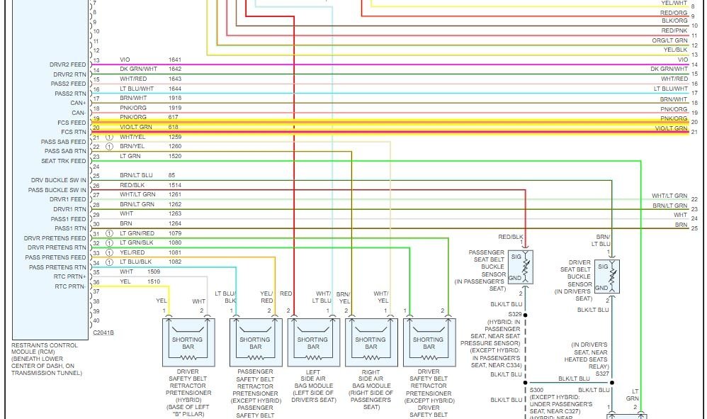

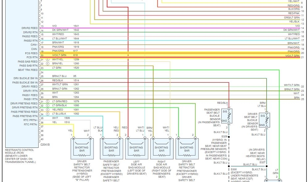

There's a connector on the center post directly under the hood latch outside the engine bay. What is it for and which wire connects to it?

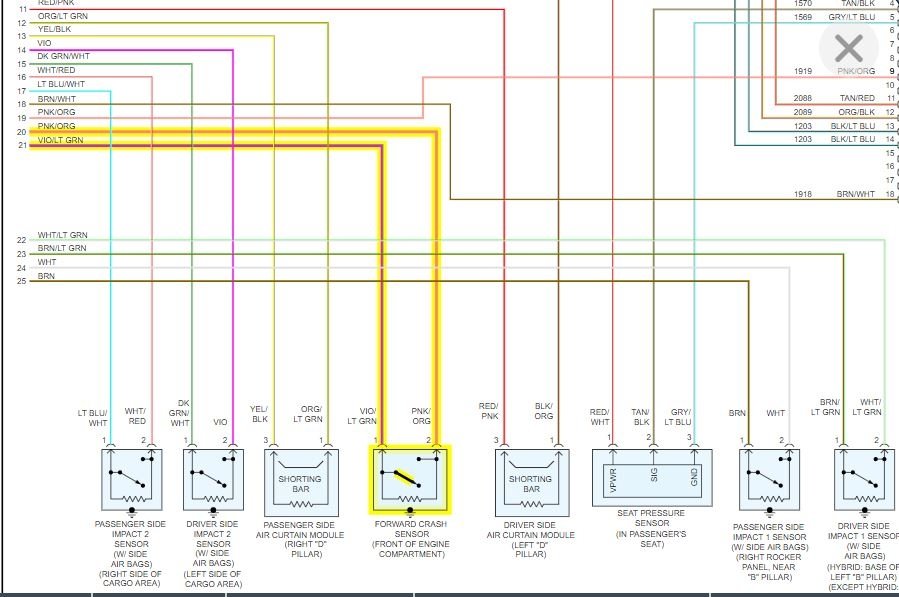

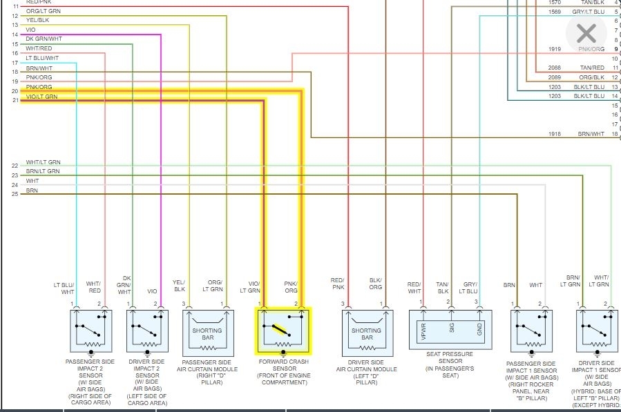

I figured out. it's the front crash sensor for the airbags. Which wire connects to it?
Feb 1, 2020 at 9:02 PM
I attached the wiring diagram for you to view.
There are 2 wires that go to the sensor from the airbag module.
