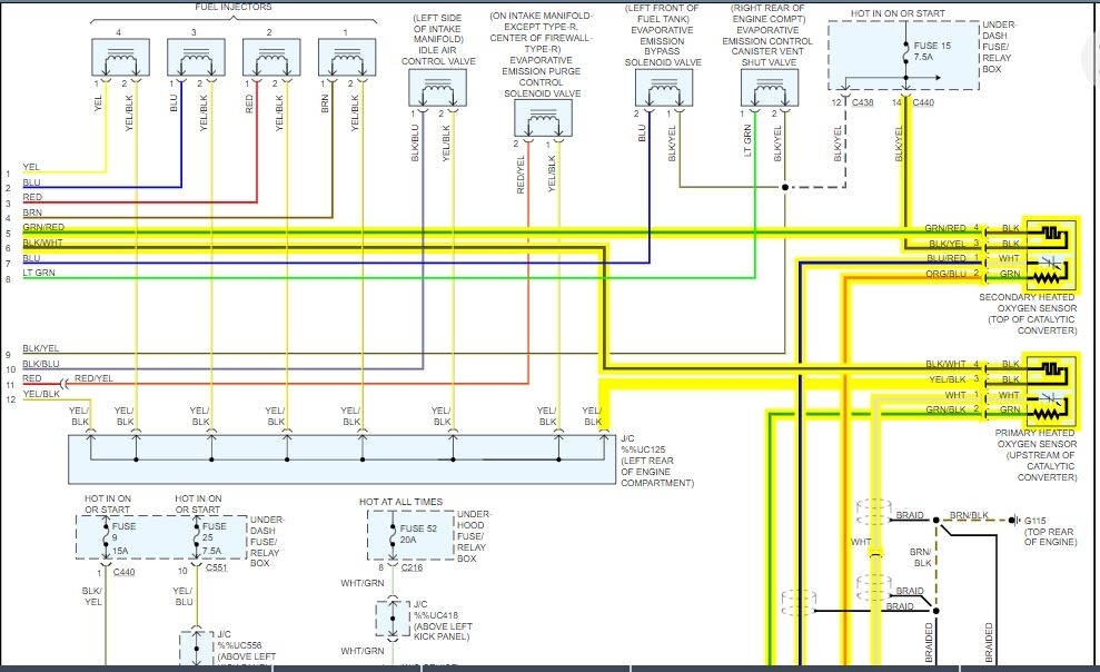

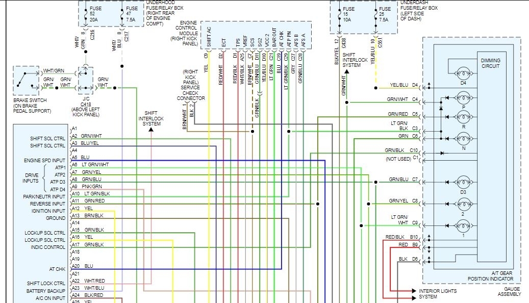

After rewiring the cabin wiring harness codes PO118, PO122, PO135, P0141, and P1660 appeared?
1999 ACURA INTEGRA
207,000 MILES • 1.8L • 4 CYL • 2WD • AUTOMATIC
GRAINS615
Bought the car cheap cheap.
cabin wiring harness was cut down the middle by the SRS unit.

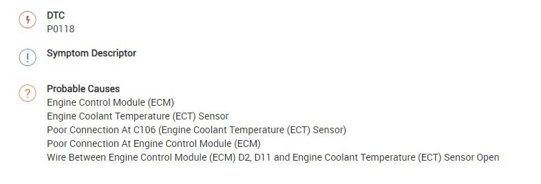

rewired it back together and now the check engine light on and codes PO118
ECT sensor 1 circuit high input

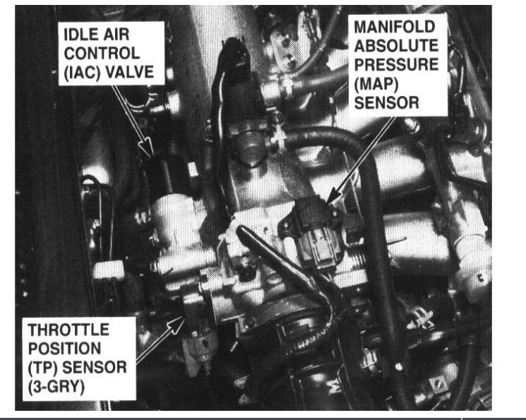

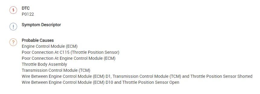

PO122
TP sensor (A) voltage low
PO135
HO2S (SI) heater failure
P0141
HO2S S2 heater circuit malfunction

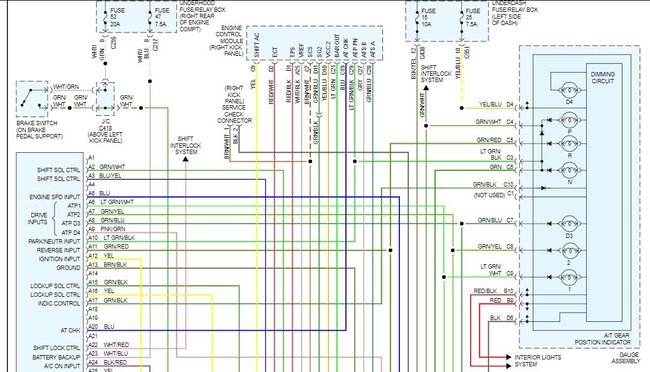

P1660
Attached line signal failure.
Ignore the o2 sensor as exhaust was cut at the manifold.
Aftermarket radio has power but no sound and fuses are fine have not installed the dashboard side of the center console.
when I use the window switches the idle fluctuates.

Good morning,

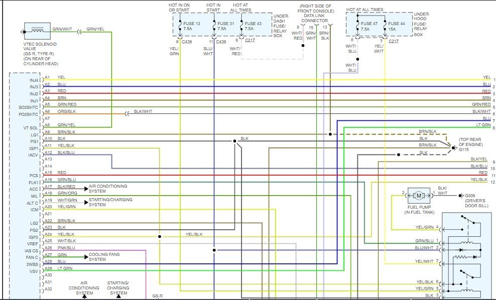

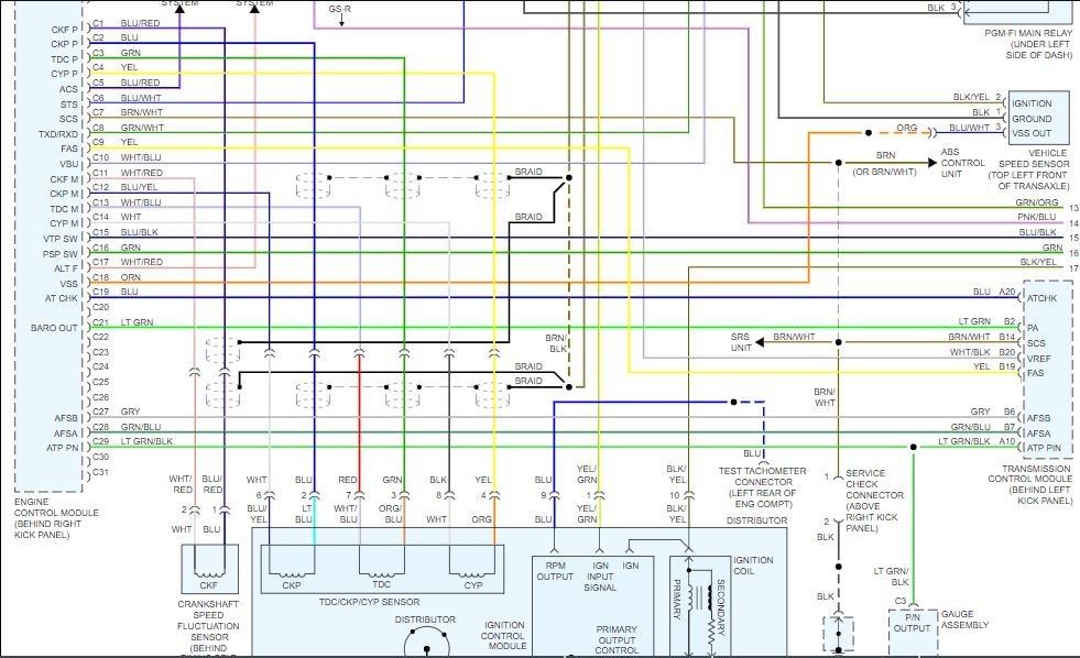

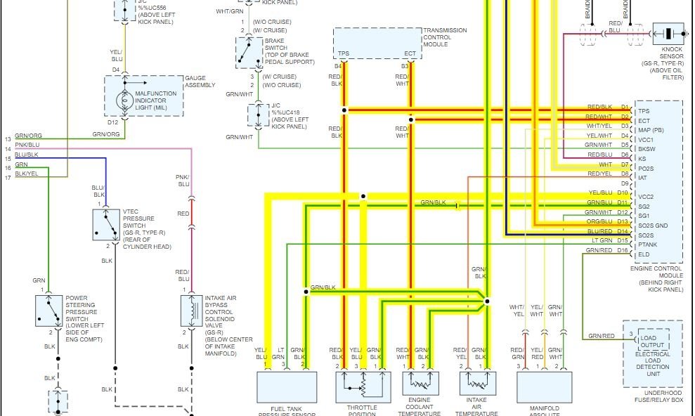

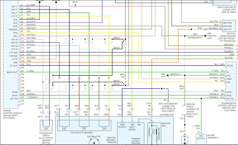

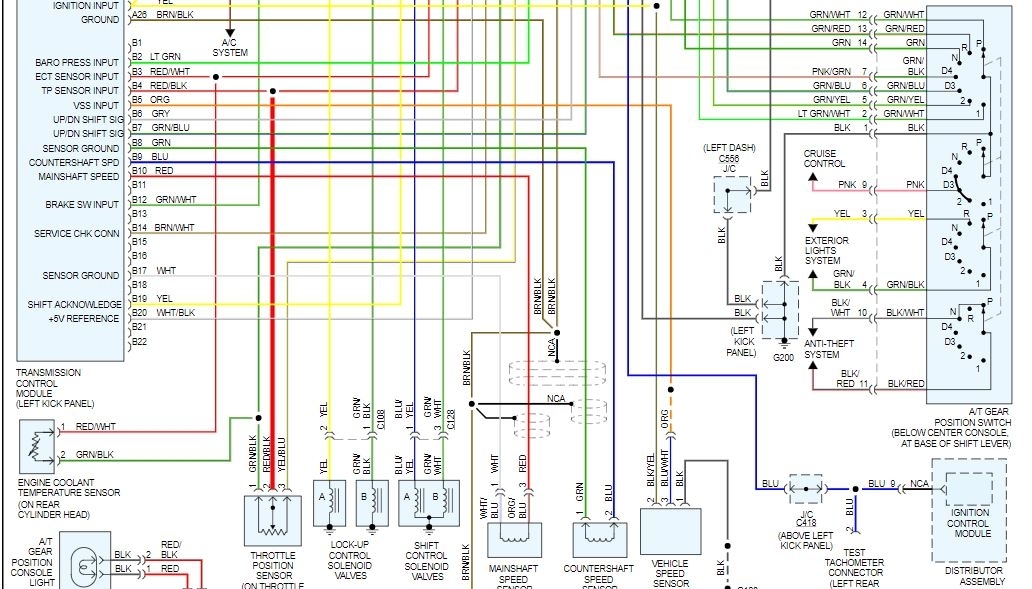

I posted a wiring diagram for you to view for the systems.

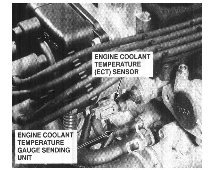

The 118 is for the coolant temperature sensor.
https://www.2carpros.com/articles/how-a-coolant-temperature-sensor-works

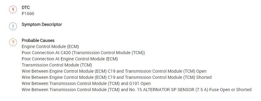

1660 is for wiring to the transmission control module
The 122 is for the throttle position sensor.
Make sure the wiring you repaired matches the colors for the components. It sounds like you have some wiring mixed up.
