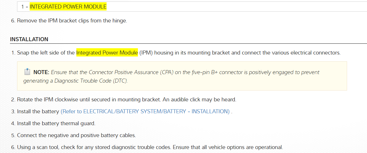

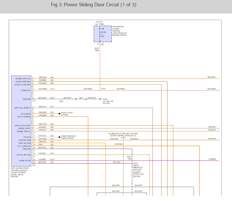

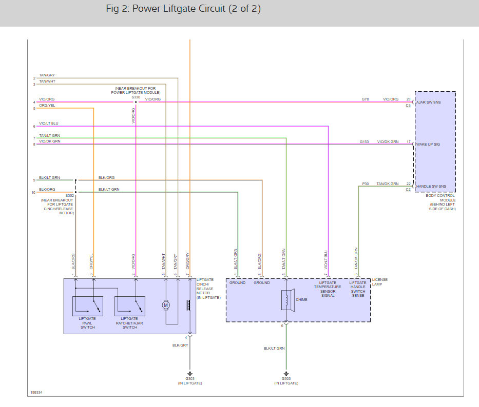

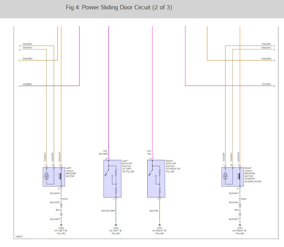

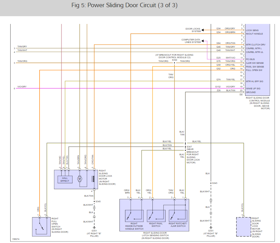

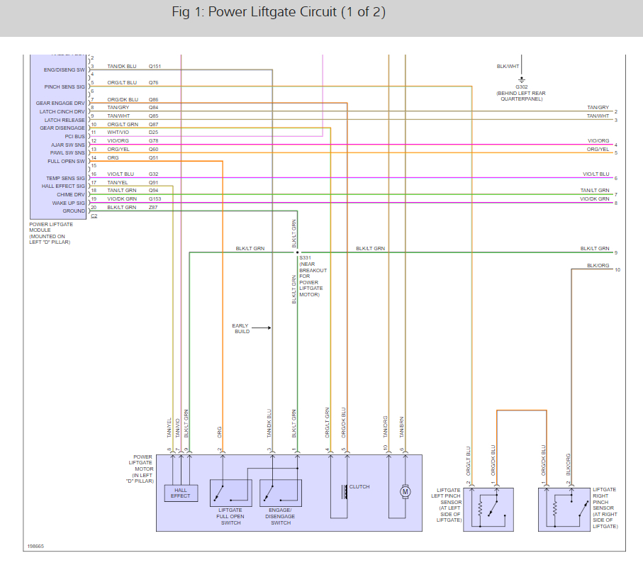

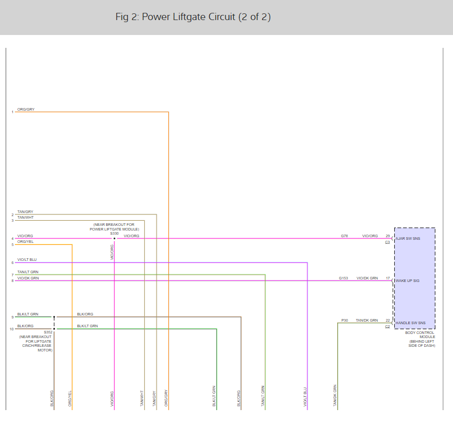

Tailgate do not work and doors do not work other than that van runs fine.
Nov 27, 2018 at 5:22 AM
  • 55,721 POSTS

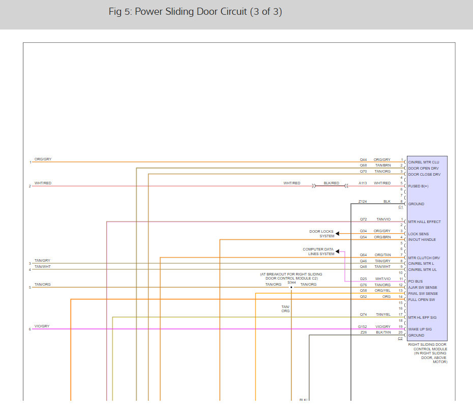

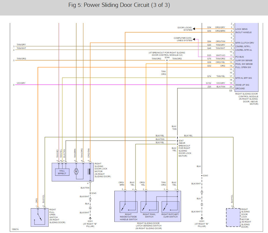

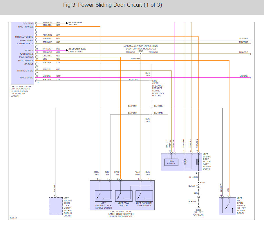

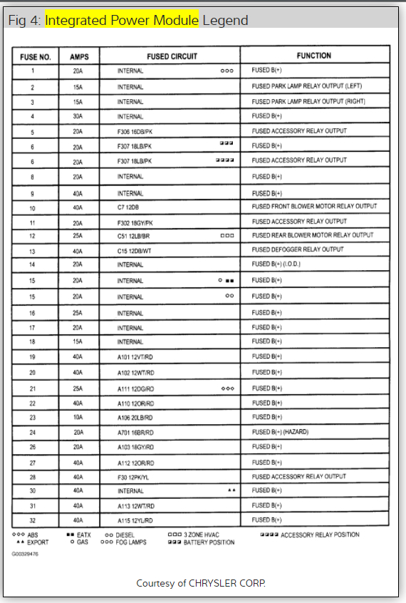

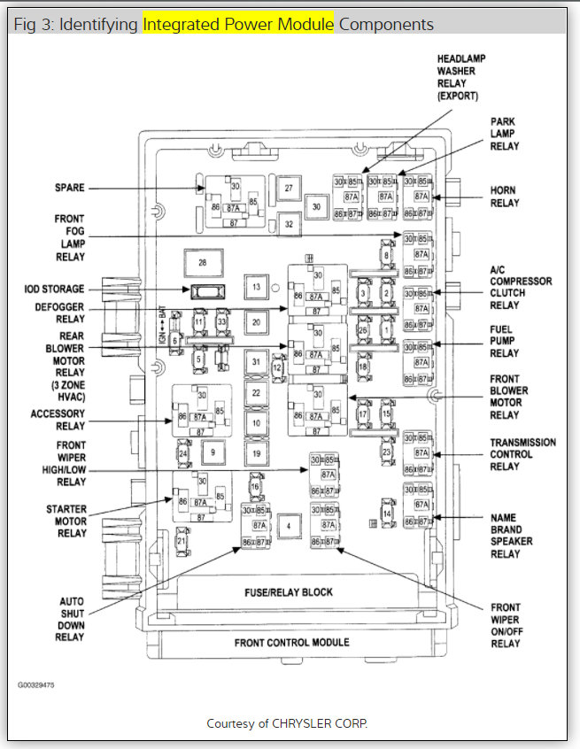

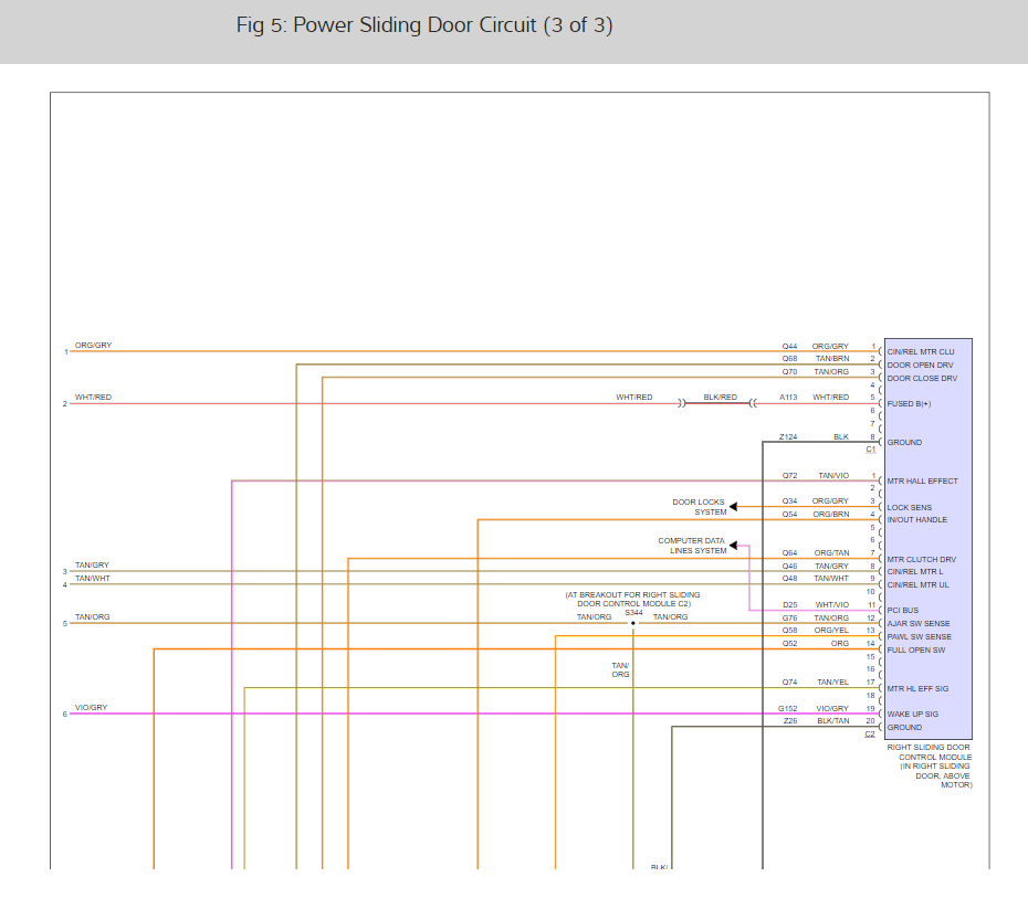

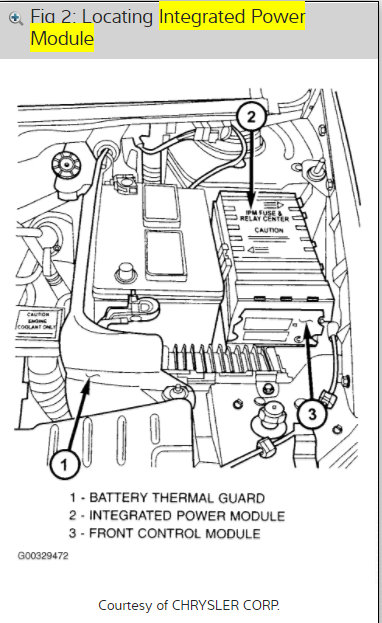

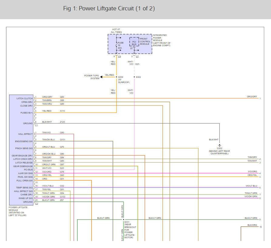

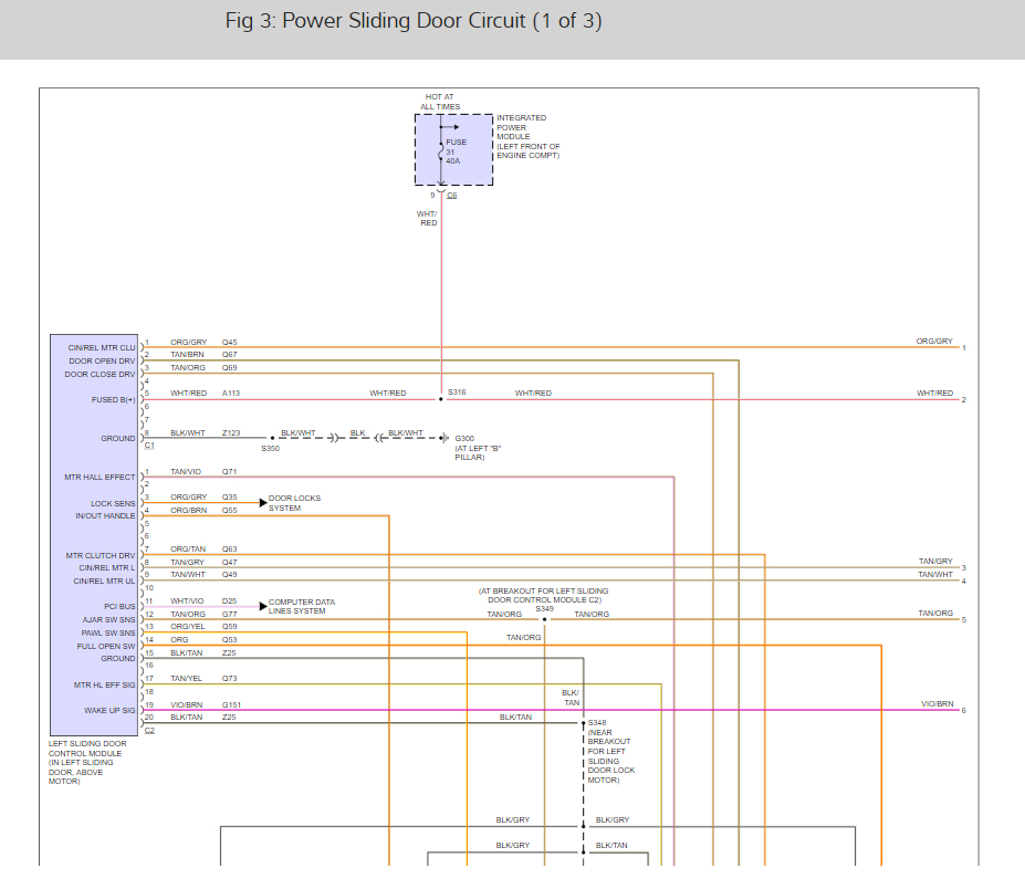

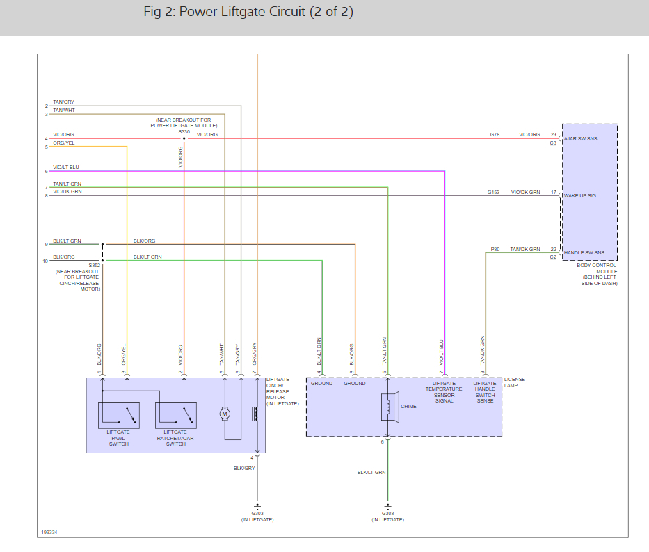

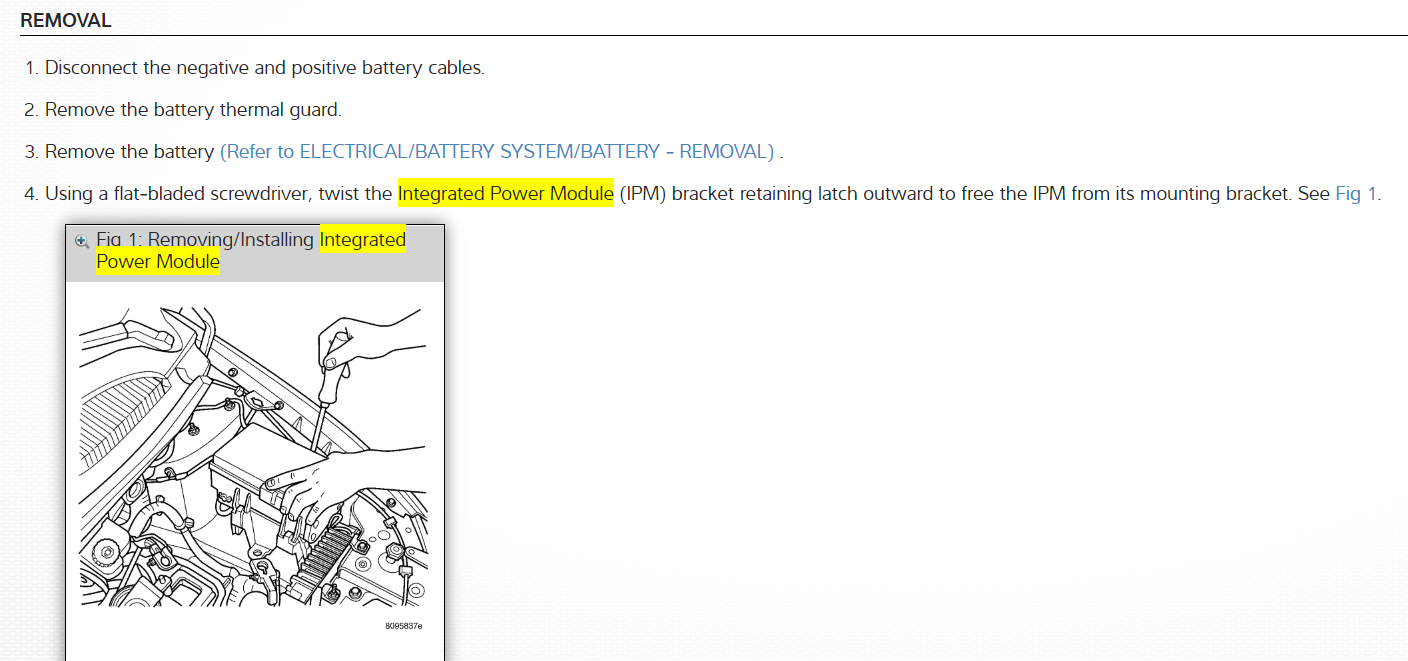

Let start by checking for power at fuse # 31 in the TIPM under the hood. Here is a guide to help us get started and the wiring diagrams so you can see how the system works and the fuse locations below. If there is no power at fuse #31 then the TIPM has gone out and needs to be replaced.
