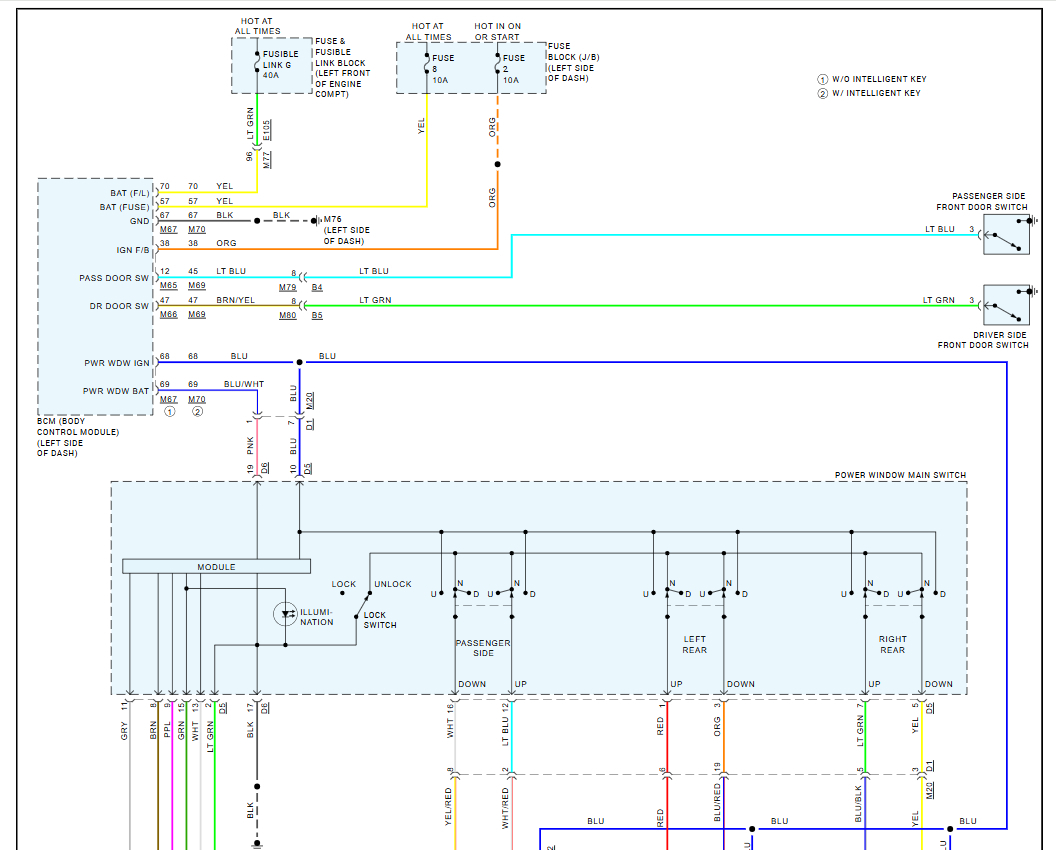

None of my windows go down from any switches on the doors. I tested for continuity with the key on and don't seem to have power going to the master switch. I thought maybe it was the relay or fuse, so I replaced the relay under the hood and tested all the fuses in both fuse boxes but still no power.

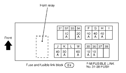

Okay we are going to turn the key on (or start button) and test for power at the fusible link G 40 amp in the fusible link box on the left side of the engine compartment and then fuse #2 and #8 in the fuse panel on the left side of the dash.
This guide can help:

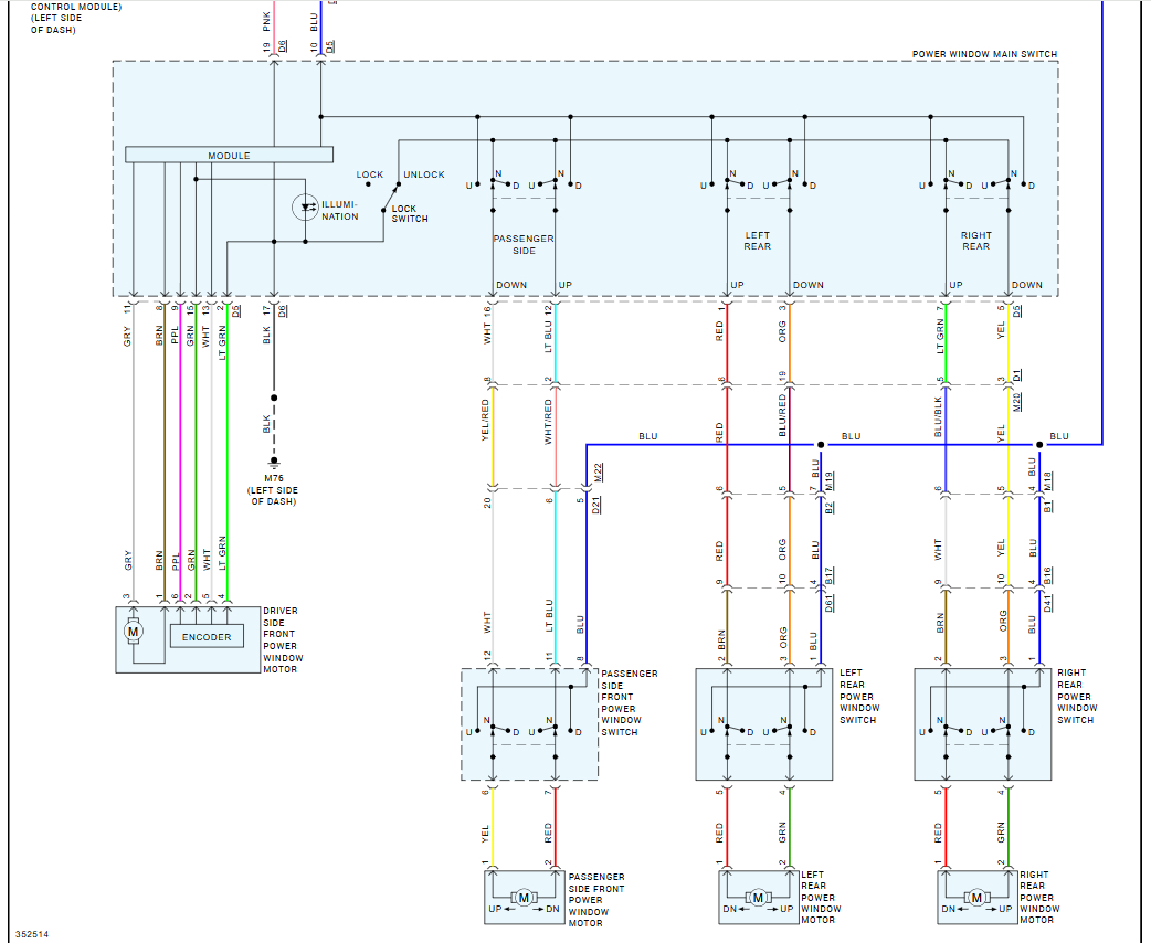

So, the window switch gets its power through the fuses and then from the BCM which might be out if the fuses have power through them. Here is the window wiring diagrams so you can see how the system works. Check out the images (below). Please let us know what happens.

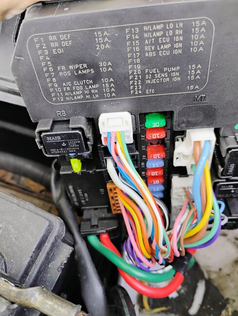

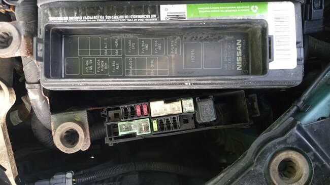

I don't see a G40 fusible link in the fuse box under the hood. This is what I have.(See photo). What the name of the #2 and #8 fuses? Mine just have labeled names. Thank you

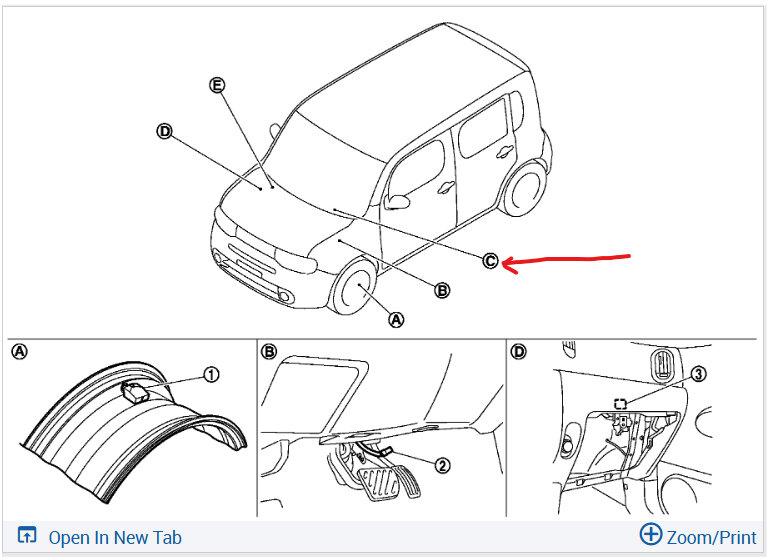

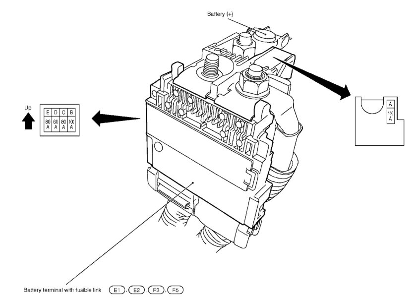

Lol, thank you, here is the location of the link G, let me know if it is okay. You can change the BCM, but you will need it preprogrammed, you can get a preprogrammed unit by searching Google or Ebay. Here is the BCM as well which looks like it is under the dash on the driver's side toward the middle. Check out the images (below). Please let us know what happens.

All the fuses you suggested have continuity. Found the power window BCM fuse down on the side of the battery. Are there any other places to check before I replace the back? Thank you

Replace the back? do you mean BCM? there are no other fuses, also did you check for power at the fuses?

Yes I meant BCM. I did check for power at all fuses and they all are good. I guess I'll try replacing the BCM next. Thank you for your time.

You are welcome, that would be the next step. Please let me know if that fixes it.
