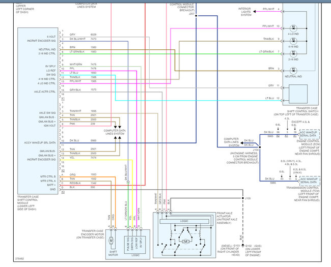

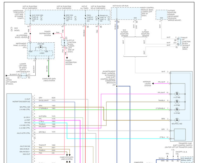

4x4 switch on dash has 2.4 volts negative feeding out on hi lo and neutral?
270,000 MILES • 6.6L • V8 • 4WD • AUTOMATIC
CONNELLYM
4x4 switch on dash has 2.4 volts negative feeding out on hi lo and neutral, what's the problem?
May 6, 2023 at 7:55 AM
  • 55,561 POSTS

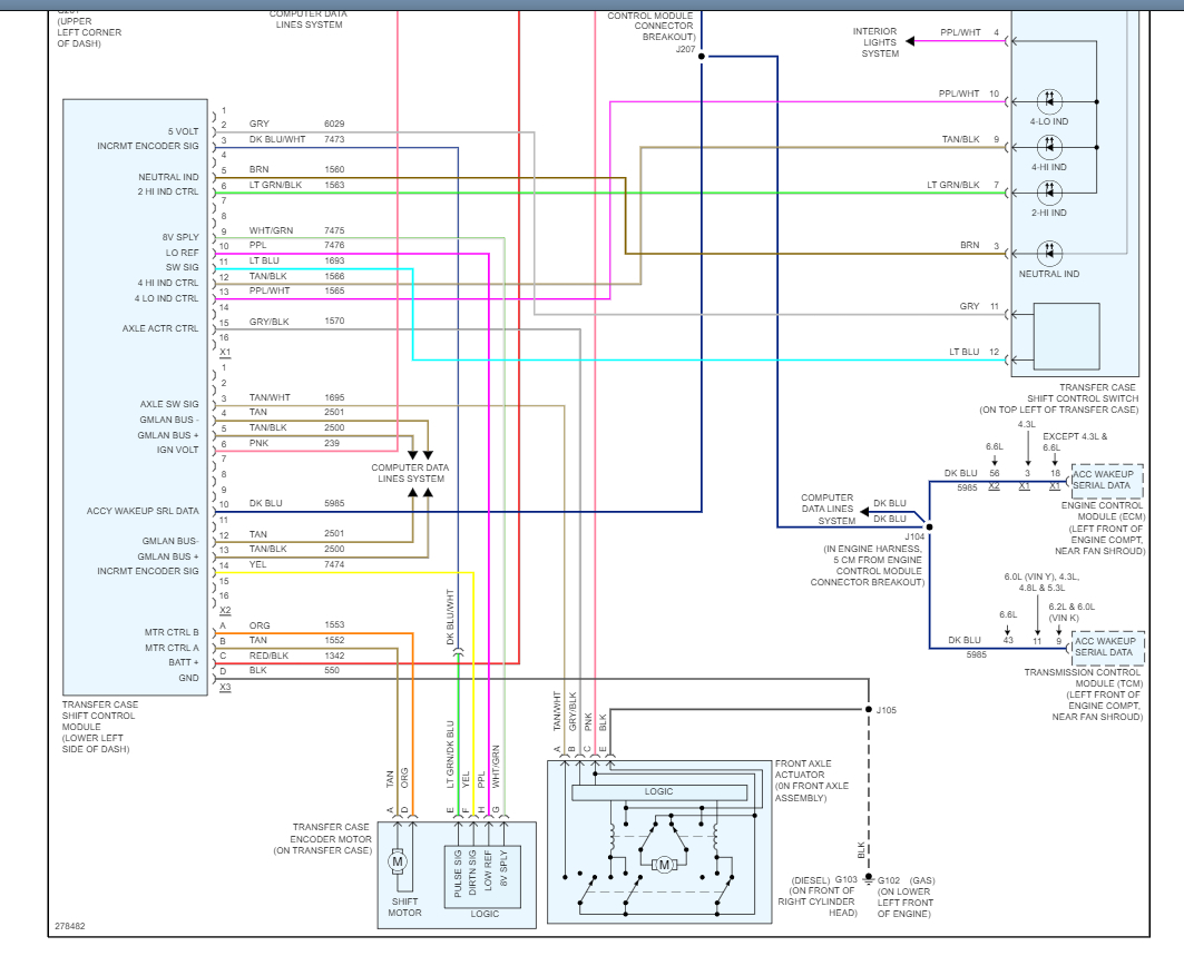

It sounds like the transfer case control module is not working correctly but I would check the grounds and power inputs to confirm here is a guide to help and the transfer case wiring diagrams to help with the tests and so you can see how the system works.
